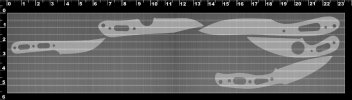

Okay friends, the sheet has arrived, and the real estate is selling out fairly quick. Here's what it looks like so far, and if you want to reserve a spot on here, let me know soon, because this will be sent to the waterjet guys within a short time from now.
D DMG I'll PM you
Done Martin, and I had another request for one after you as well. That Street Beat pattern is popular.
To anyone else who's on the fence about getting your first David Mary custom in rustproof LC200N, the green profiles in the image below are not commissions. I can bump them off so I can fit your requests in, or I will end up making them and selling (or something in similar size) on the Exchange. You still have a small window if to get in if you want something before I draw up the CAD file and get this to the waterjet.

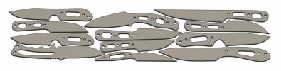

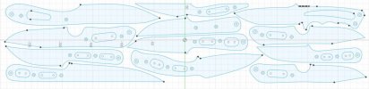

After talking to the waterjet guy, it looks like I need to put 1/8" between parts. So I had to change a few designs to make room. Commissions remain untouched. Here's what I've ended up with. I have sketched it in CAD, and will be getting it and the steel to the waterjet guys later this week.
Oui Monsieur. Yours is the one under the long knife, on the right in the 3D pic.
Good afternoon friends. Due to a software limitation of the waterjet company, I had to redraw the designs using lines instead of splines, resulting in slightly blocky blanks, but I just picked them up today and I'm quite happy with how they turned out. Clean up will be a snap. I'll prep the blades for heat treatment, and hope to ship them off to @JTknives for heat treatment on Monday.
