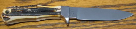

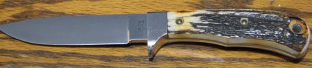

Here's a nice stag knife made for Cabela's that was sold a couple times as a Schrade and I think it's a Bowen or at least a not-Schrade. This example was sold with 153UH box and paperwork but it's certainly not a Golden Spike.
On Aug 4 this package sold for $35.00 (http://cgi.ebay.com/ws/eBayISAPI.dll?ViewItem&_trksid=p4340.l2557&hash=item19d3f4675c&item=110930192220&nma=true&pt=Collectible_Knives&rt=nc&si=3RXAhF74cIpISSA4r0nYBoliegQ%253D&orig_cvip=true&rt=nc) $(KGrHqN,!nsF!IcwwiwzBQJSL1RlrQ~~60_12.JPG$(KGrHqZ,!r!E+oZLDp5fBQJSLsm20g~~60_12.JPG$T2eC16V,!zoE9s5ne+czBQJSLlzHzw~~60_12.JPG
It appears the buyer then resold the whole package (just as he bought it) on the 19th of Aug for $127.50 (http://cgi.ebay.com/ws/eBayISAPI.dll?ViewItem&_trksid=p4340.l2557&item=200805119562&nma=true&rt=nc&si=3RXAhF74cIpISSA4r0nYBoliegQ%253D&sspagename=STRK%3AMEWAX%3AIT&orig_cvip=true&rt=nc)
Here's a listing for another example of the same knife but seller describes it as being made by Bowen with no box or paperwork (http://cgi.ebay.com/ws/eBayISAPI.dll?ViewItem&_trksid=p4340.l2557&hash=item1c2929bbc9&item=120949685193&nma=true&pt=Collectible_Knives&rt=nc&si=3RXAhF74cIpISSA4r0nYBoliegQ%253D&orig_cvip=true&rt=nc)
Here's a Bowen stamped knife that sure looks a lot like it: IMG_5551.jpgIMG_5552.jpg
What's the consensus? Schrade or not-Schrade? I'm thinkin' the Bowen listing is more accurate. It just doesn't look like a Schrade to me.

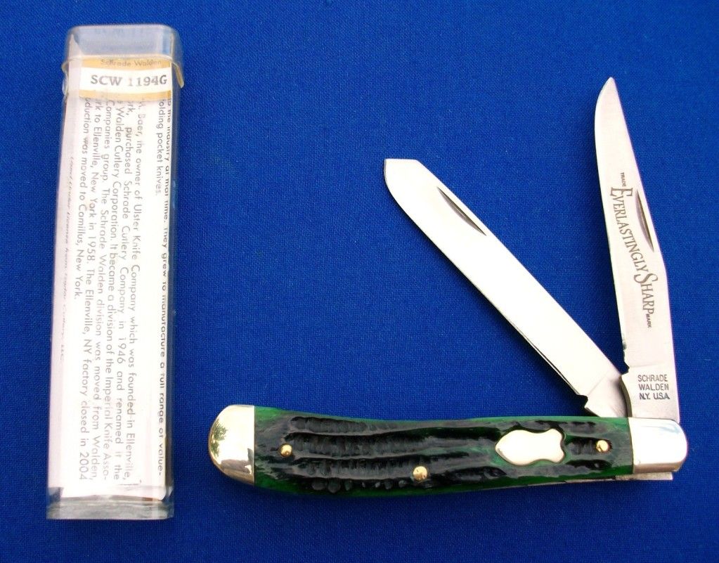

Thanks, Larry for a good tip. Meanwhile, I thought the cognoscenti might like a good look at a Taylor Utica knife which has some nice bone. It is NOT, however a knife made by Schrade before 1973, as he (and the seller) would like us to believe. Here is a lesson for newer readers. This is an ended listing.
http://cgi.ebay.com/ws/eBayISAPI.dl...sspagename=STRK:MEWAX:IT&orig_cvip=true&rt=nc
This is the Utica from the Ebay Auction Tongueriver referenced on the previous page that Winchester73 mentioned. Taylor packaged both Utica and Camillus made Schrade Walden knives in these replica plastic tubes. The Utica's are usually easy to spot with the etch, brightly colored bone, and non Schrade USA pattern numbers. The Camillus made knives were yellow plastic, if I am remembering correctly. Both used the same etch.
