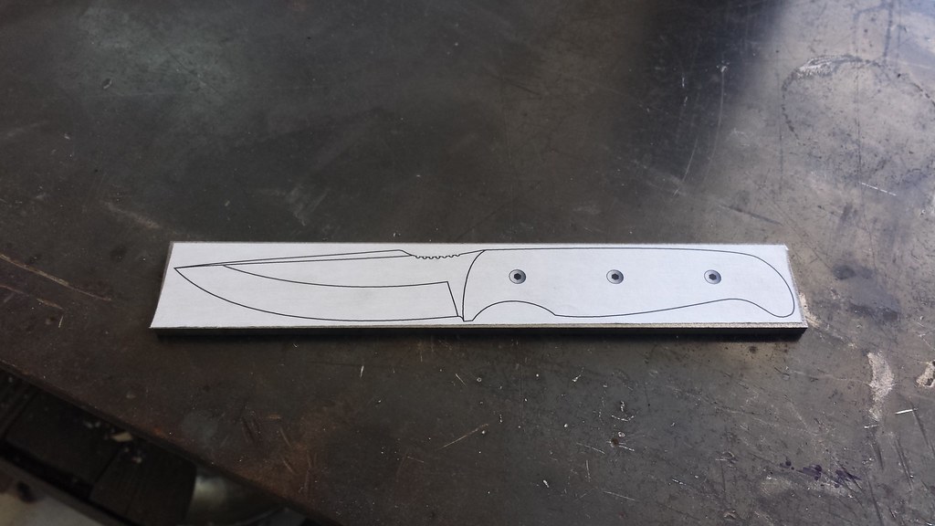

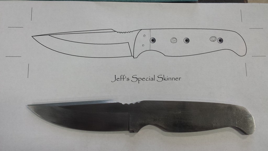

So, I will just jump in here. This knife is based on the design I posted in another thread. It is modified some for a friend who wants to use it for dressing out deer.
Untitled by Ranger_Bob, on Flickr
Since I was only going to make one in this shape, I thought I could just glue the paper to the steel and profile on the grinder. The glue kept heating up and the paper would come loose. Since I couldn't dunk the blank with the paper attached, I would have to wait for the steel to cool and the glue to re-adhere. Lesson learned!
It did work however! I would not use this technique again.

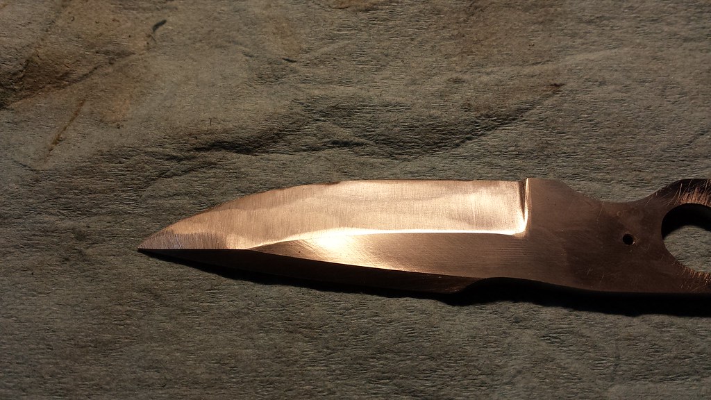

Below is my first ever flat grind. I had already profiled another knife and attempted a hollow grind. I will show that knife later; I don't think I ruined it...yet.

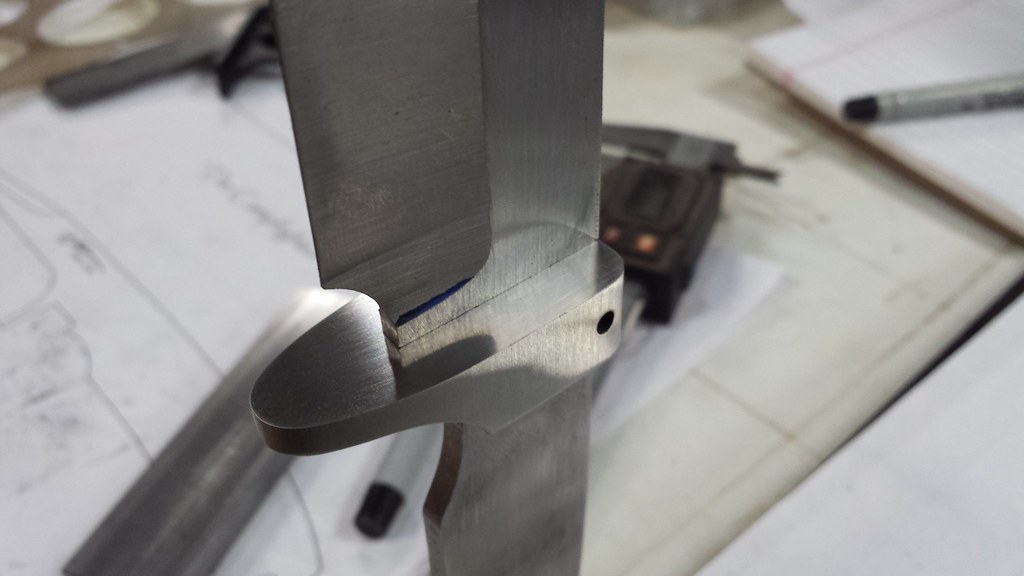

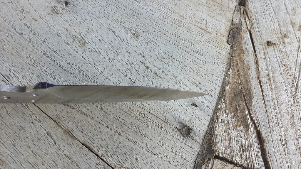

Here's where I am now. I made the bolsters yesterday and I don't like them. I think the front edge needs to be ground at an angle. I don't know if I can adjust these or if I need to start over.
I am open to any suggestions on what and how to improve. I specifically would like some advice on how to proceed with the bolsters right now. The knives are all still pre-HT.

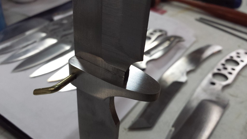

What I do with bolster,you already have the front of the bolsters finished that is good, now pein the bolster to the blade with some brass pins,then shape the bolster to your likeing. I get mine to about 80% finished before attaching the handle scales.
The reason to use brass pins is so you can see them to tap them out with a punch after shaping. To attach permanantly,taper the holes and leave about .060 pin sticking out each side and pien them on. Start with a smaller hammer 4oz or so and get them good and set then switch to a BFH and pound them good. The pins will hide every time.

Thanks Stan. Exactly what I needed. You make some fantastic looking knives!

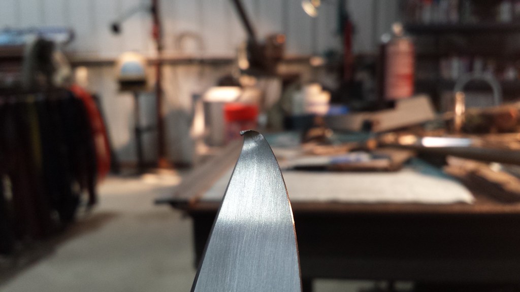

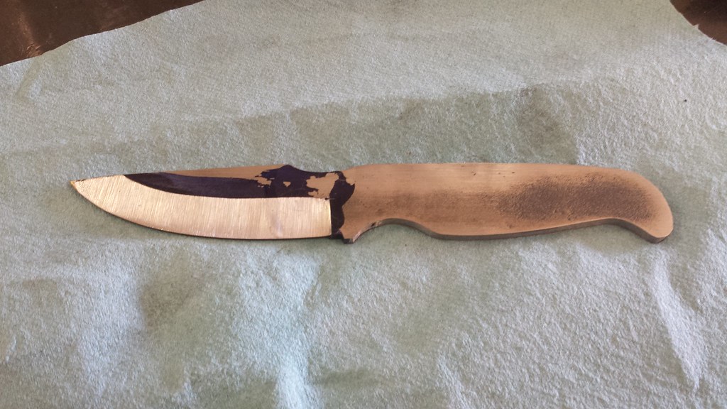

This is my first blade of the three which makes it the very first blade I profiled and ground bevels on. The hollow grinds are not very consistent. I felt most comfortable grinding these at about 1/3 speed with a 120grit belt. 1/3 speed on my grinder is probably about 1200 feet per minute. This knife will get a milled black peel-ply G10 handle w/OD G10 liners attached with countersunk stainless socket head screws. It has a 1/4" lanyard hole but I've not decided if I will use it or not. If I do put a lanyard hole in the scales, I will add a flared stainless tube in the hole.
Bob
I took the blade from the previous post back to the grinder to see if I could clean up the hollow grinds with a 220 belt. I made it significantly worse. I do believe this one is now ruined. It is at zero edge in several spots and it is very inconsistent. I know a lot of people think the hollow grind is easier than the flat but I just can't seem to get it. I think I will have to cut up some mild steel and just practice. I'm pretty disappointed in how this one ended up.

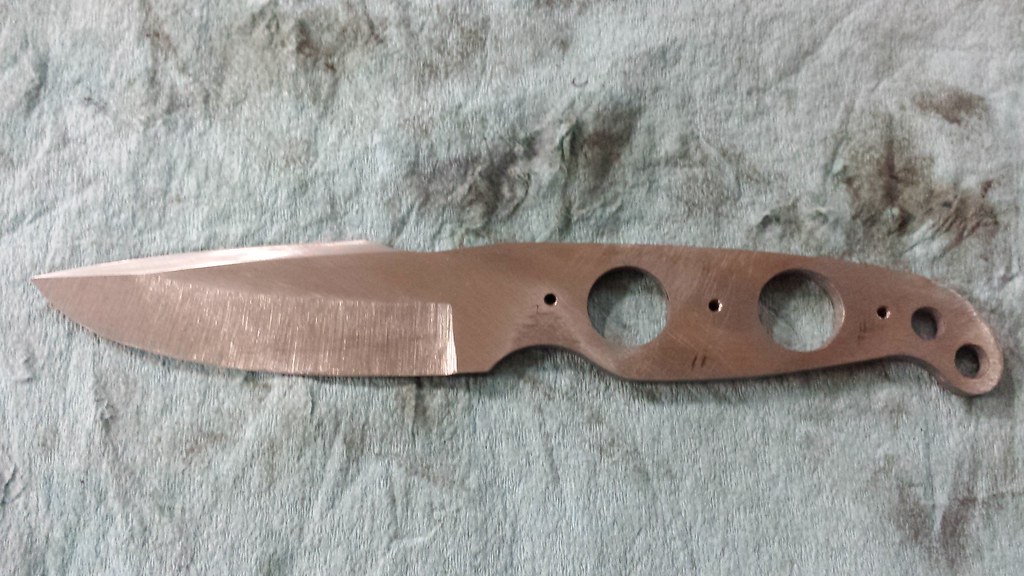

This is the third knife. This is 1/8" 440C and I think I'm just going to drill holes and send it out for HT. It will be flat ground and I will try to do it all after HT.

Today I followed Stan's advice about temporarily pinning the bolsters on. Pinning and shaping the bolsters went nicely. I really hammered the pins to make sure they wouldn't come loose while shaping. So getting the pins back out was a pretty serious task. I got them off eventually. I would say my lesson-learned here was when you go to knock the pins back out, support the blade as close to the pins as possible on a very solid surface and hit the punch with plenty of accuracy and confidence. I started out a little tentative and wasn't getting much done. The pins and opposite bolster came off the knife as one piece. I cut the pins off the back of the bolster and punched them out into a piece of a 2x4. Wish I'd have thought to take pictures of the ordeal.

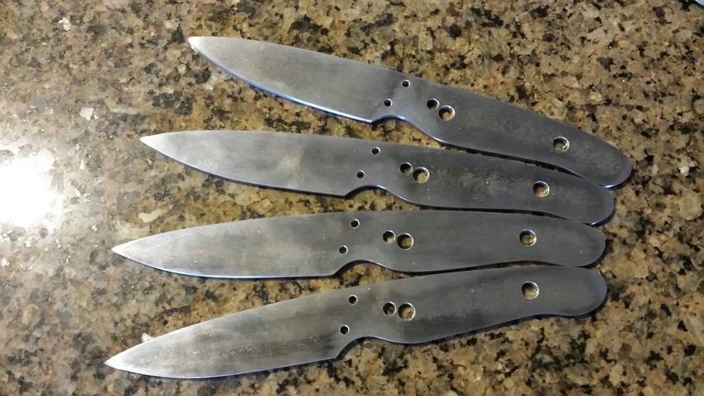

I also drilled the holes in the blank for the third knife. I actually drilled holes on four identical blanks. I guess I won't have a first knife; I'll have first knives! But I do have a first screwed up knife so maybe that counts for something. The two pin holes next to each other are because I haven't decided on handle options for all of them yet. The two 1/4" holes are for if I use bolsters and the additional 3/16" hole is for if I don't use a bolster. Best laid plans...right?

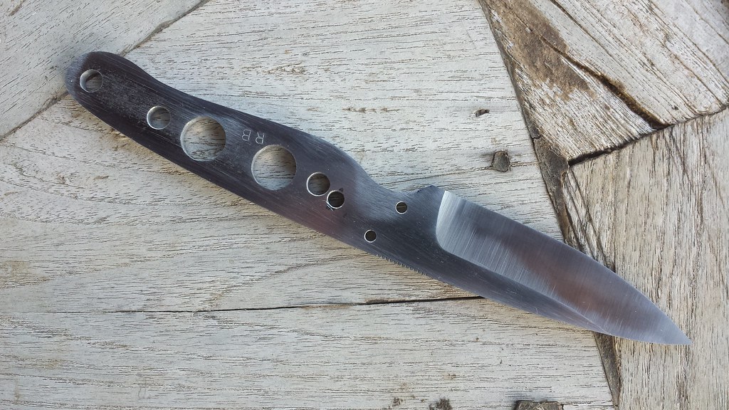

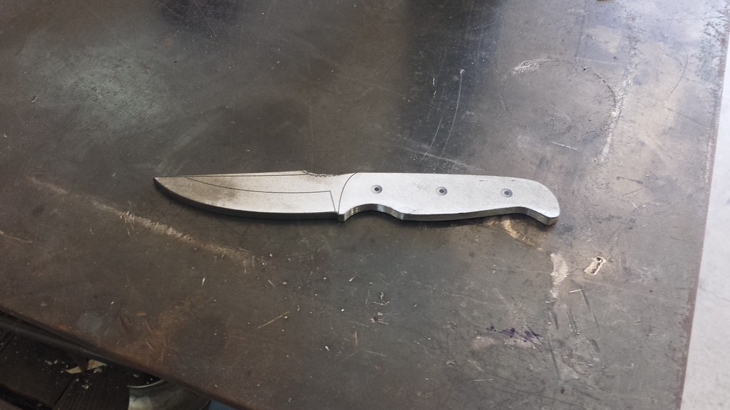

After thinking about it for a while and having a little success grinding another knife using a simple jig, I decided to go ahead and grind these four identical blades (shown in previous post) before heat treat. Here's one of them; all four came out about the same.
I'm starting to figure out my belt sequence. I am knocking the edges off freehand with a used 50 grit Blaze. I'm bringing the edge back on a 45 degree angle and then running a quick 30 degree grind on the sides just to keep the grit on my other belts. I'm not cutting all the way into the lines like some do; I don't feel I'm accurate enough to try that. Once I've knocked the sharp corner off, I switch to a new 60 grit Blaze, clamp the blade to a vise jaw from my Kurt, and grind down to my lines. I just do a straight plunge about 1/4" in front of where I want the final grind to end up. I then switch to a 120 grit Blaze to refine the grind and cut the cleaner plunge. I'm hanging the 120 grit belt over the edge of the platen about 3/16" just to soften its cutting action slightly when shaping the plunge.
I'm still trying to figure out what to do after the 120 grit. I tried a Trizact A45 but it is too stiff to work into the plunge. It does cut really flat though! I ordered some Norzon 120 and 220 grits and some 400 grit Hermes RB346MJ A/O belts from Tru-Grit to see how they work for me. I've already determined that I'm not a real fan of the J-Flex belts because of the bump at the splice.

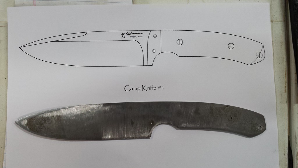

Here's some of my recent progress. I asked for feedback on this design a while back.
CAMP-KNIFE-01 by Ranger_Bob, on Flickr
I made a couple small changes to the profile and then made this pattern in 16ga steel.

Then cut out a blank.

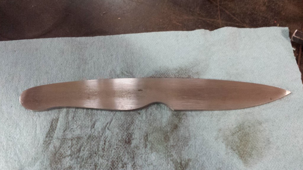

After a cooling off period, I cut out and ground a new knife. I also ground the tip off and re-shaped the tweaked blade. With the shorter blade, I thought it felt pretty butt heavy so I decided to put handles on it to see what the balance was going to be like. It's too heavy, I'm going to drill some holes in the tang to cut weight. You can see I have a pretty good batch to send out for my first heat treat.

Since I was working with my first handle, I decided to shape it a little. It is just shaped on the grinder, mostly with a slack belt between the idler and the top of the flat platen with a little bit of small wheel on the finger notch. The scales are just held on with standoffs.

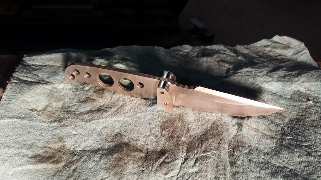

This is the knife from post #15 that I kind of screwed up the ricasso. I ground out a notch to clean up the mistake. Today I finished fitting my first guard. It is made from 304L. I slotted it with a 5/32" 4-flute, carbide end mill. I then carefully surface ground the flats of the knife on the flat platen until I achieved the fit shown here. I don't know if I will be able to duplicate my success on future projects but, I'm pretty happy with this.
