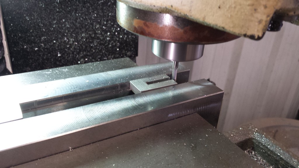

Another update. I posted a pic of this clip point, recurve tanto in the "What's going on in your shop?" thread. I made the guard for it from 304L. I've gotten fairly bold with the slotting process so it doesn't take me all day to mill a slot. I'm using a 5/32" 4-flute carbide endmill and slotting at .050" depth of cut per pass at about two inches per minute. I'm sure I could run it quite a bit faster but this is as fast as I feel I can comfortably stop the power feed at the end of the pass.

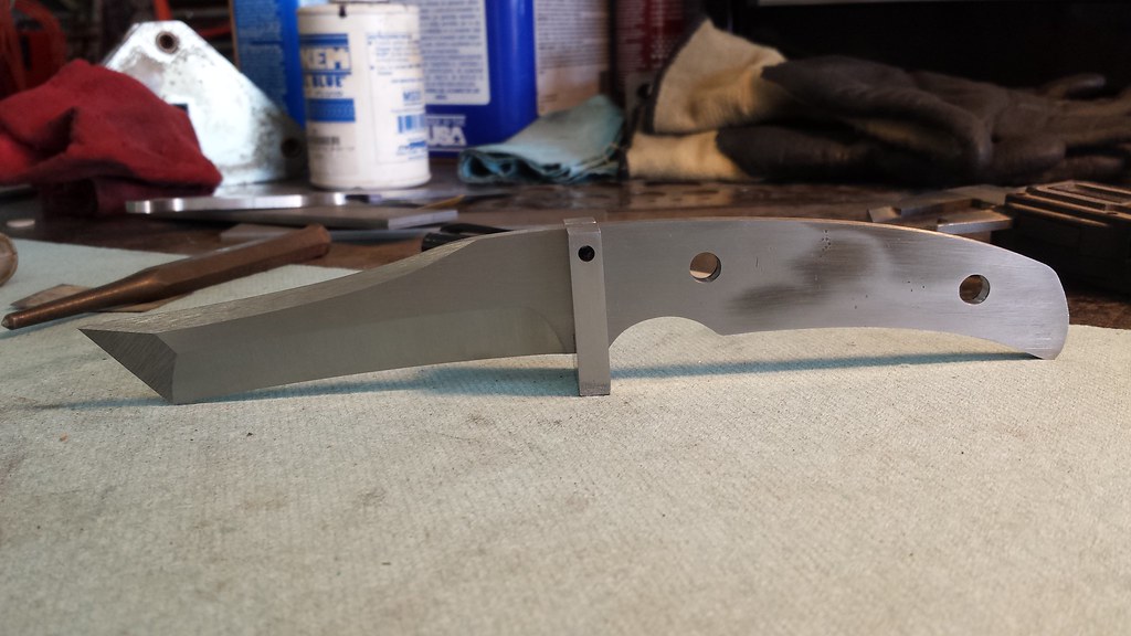

Guard in place on knife.

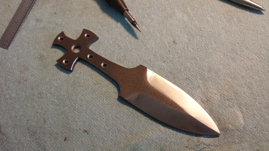

My wife and I were hanging out on the beach in Florida a few weeks ago with some friends. My buddy Jeff and I were talking about how I screwed up his knife and started over and his wife said she wanted a throwing knife. I decided to oblige her. I took my inspiration from Danny Trejo in Desperado. I know nothing about throwing knives but after a little googling, I made this. It is 5-3/4" long from 1/8" 440C. I used my reloading scale to help determine balance with some weights and then removed what I felt would be the equivalent amount by drilling the holes. The chamfer on the holes is how I fine tuned the balance. This is my first dagger grind. I did it all freehand on the flat platen. Far from perfect but good enough for this project.
