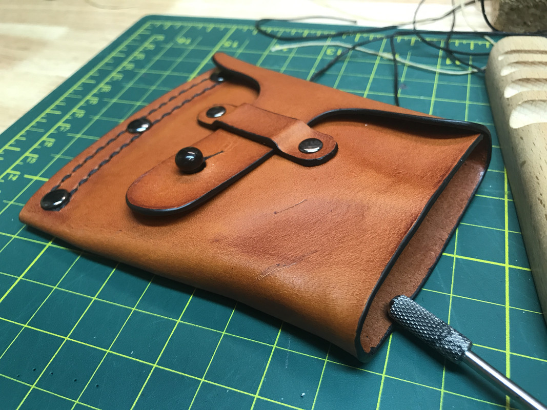

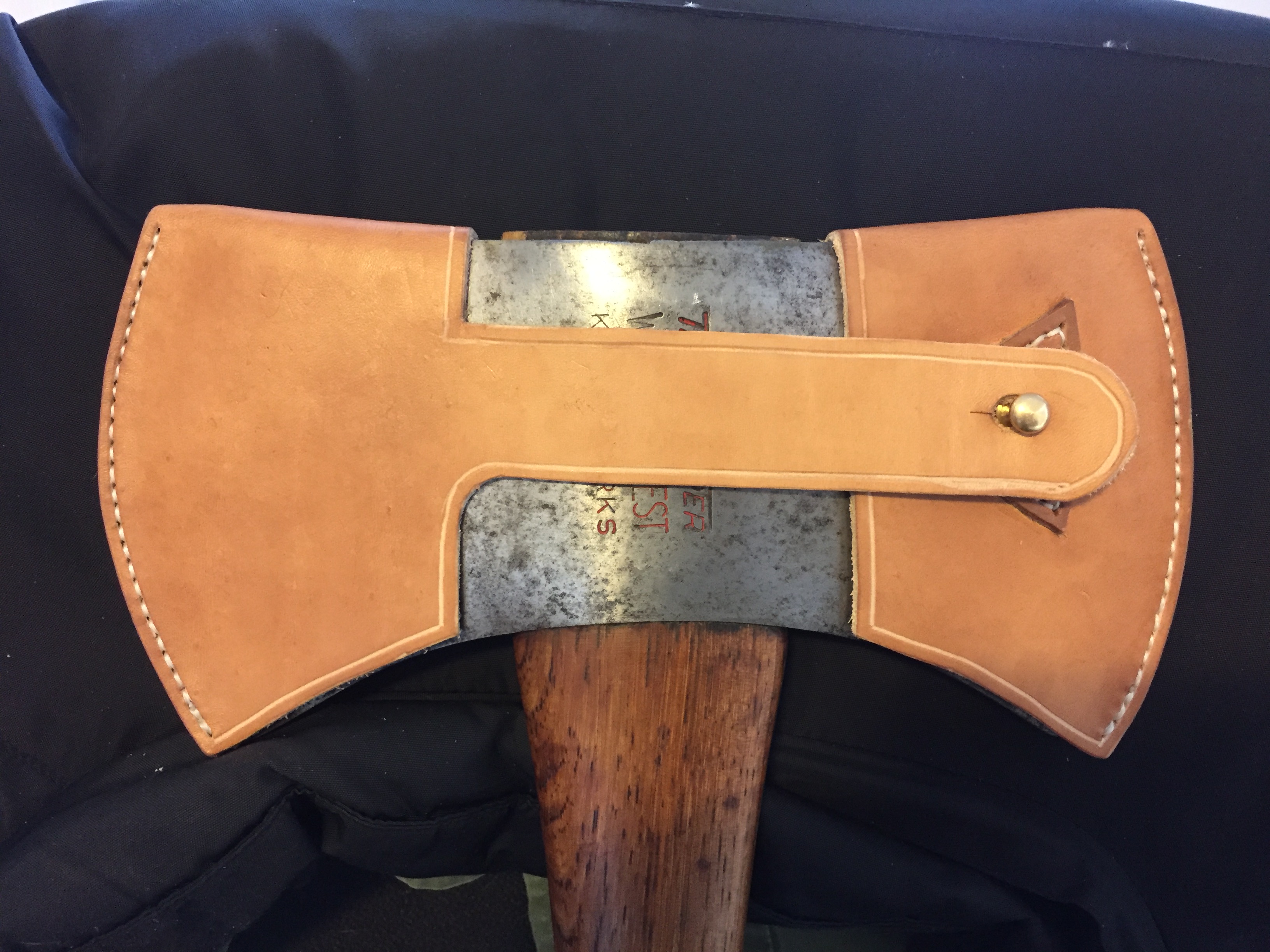

This is one I made for a customer. They wanted a belt sheath for a Rinaldi Trento hand axe. It has a swiveling belt loop.

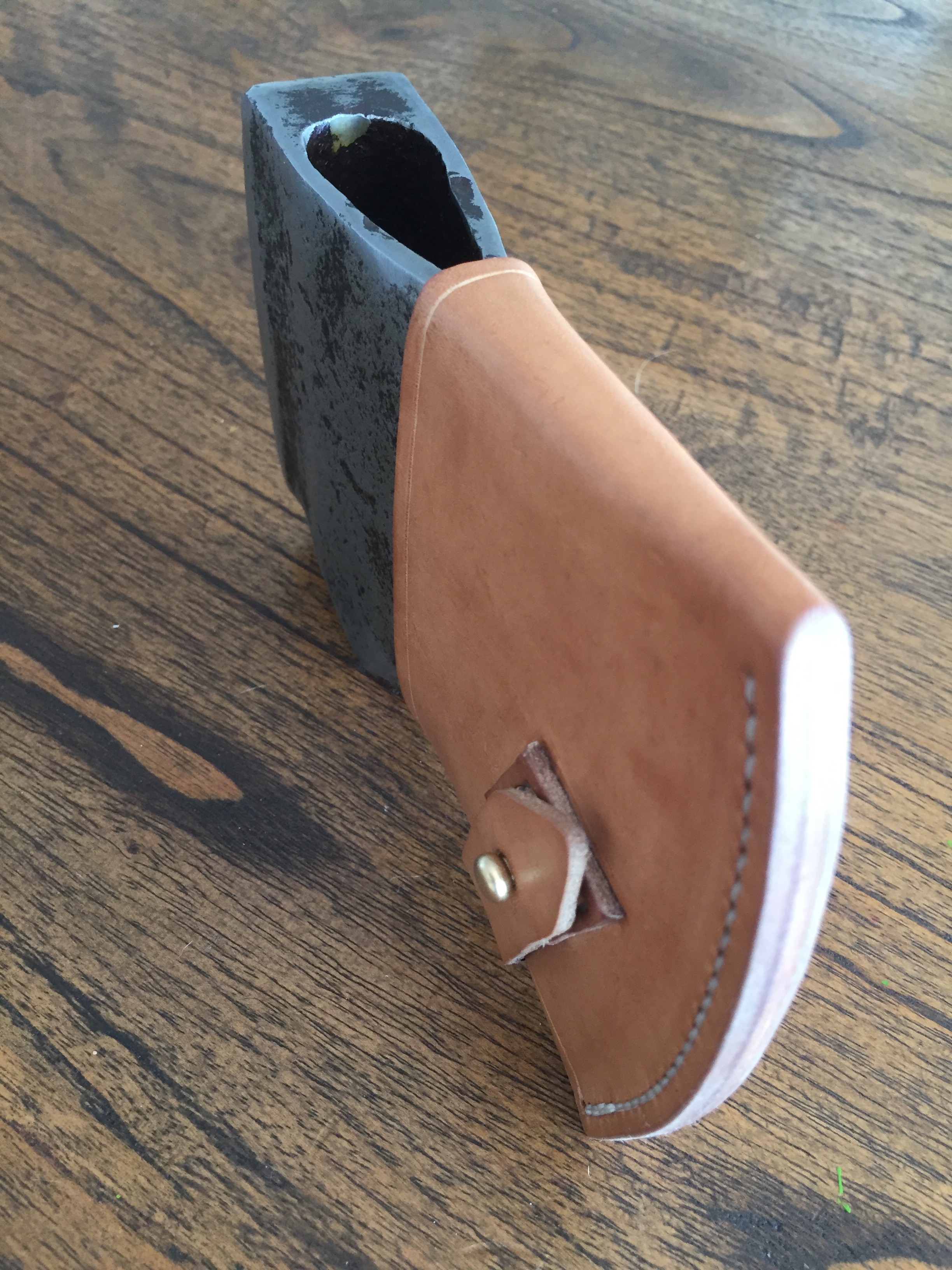

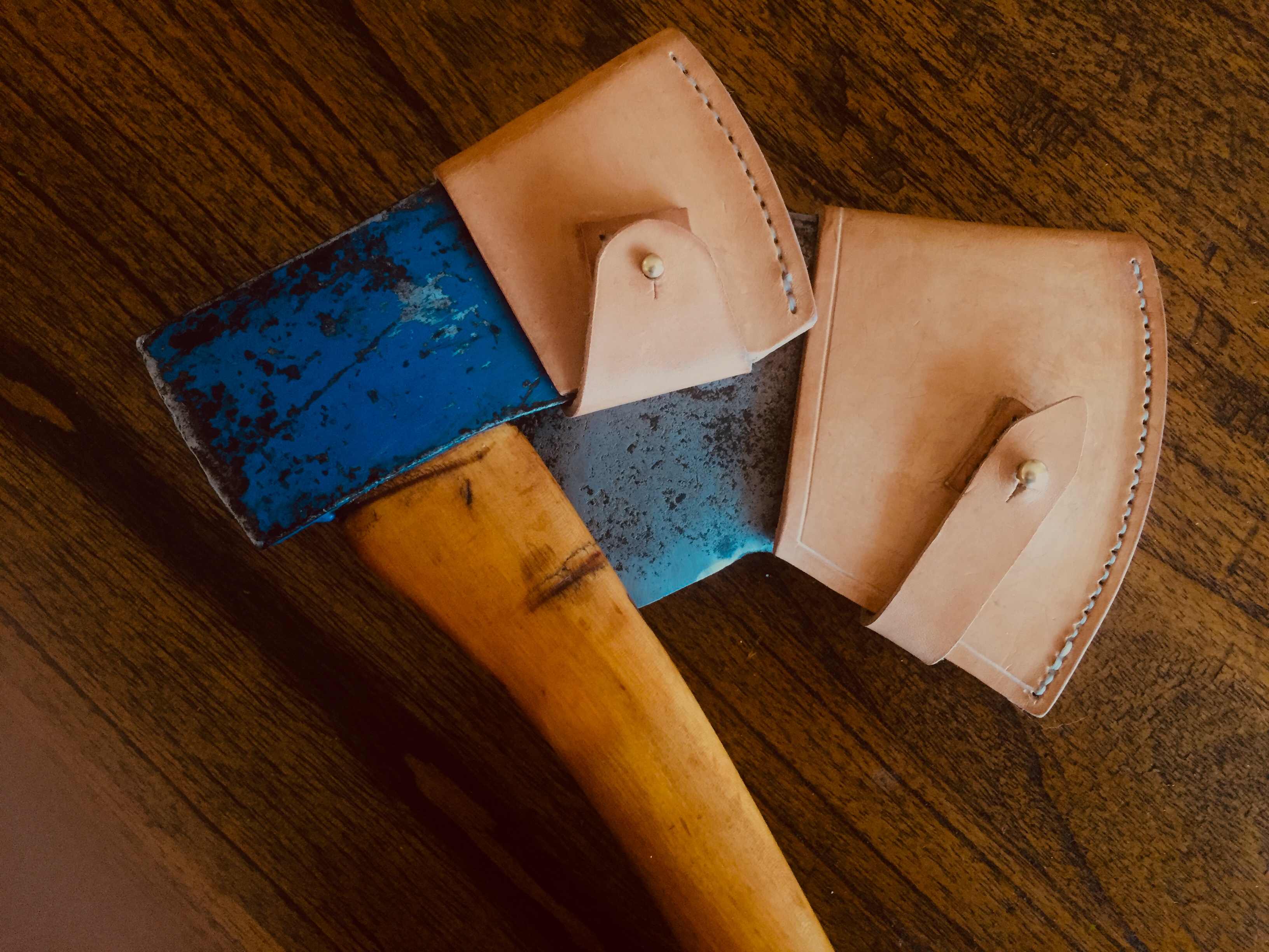

Thanks for posting that info.... and, actually, for sharing your idea of using root barrier.Here's a mask I made for the mini maul I have down at my family's camp. The original leather one got misplaced by one of my relatives so I used one from inventory to do the fitting work.

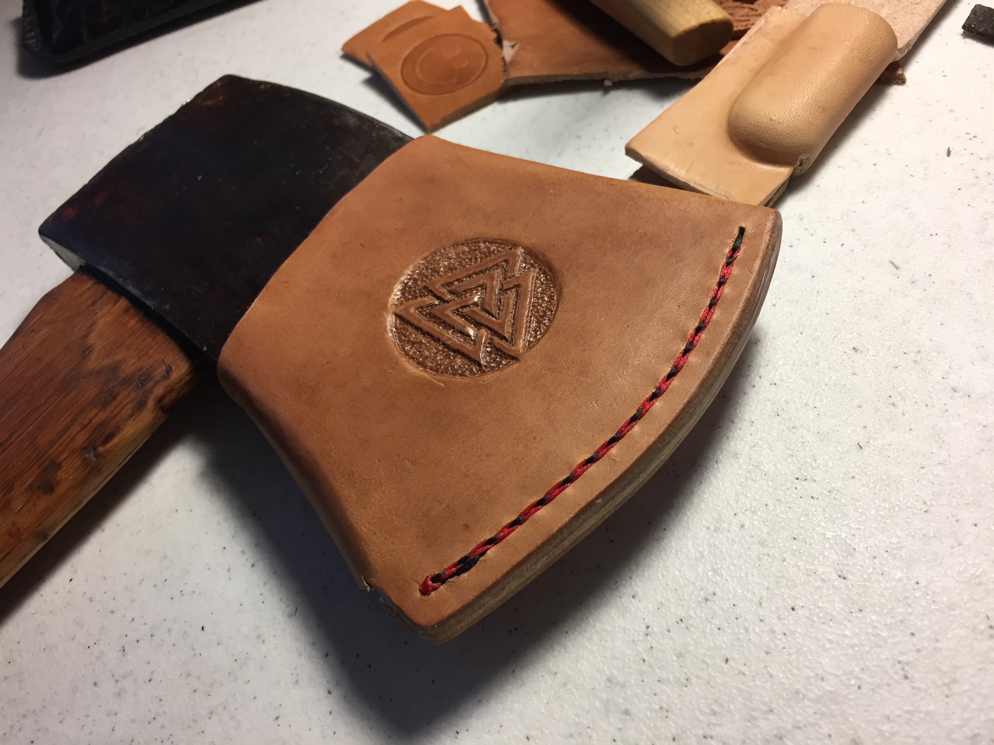

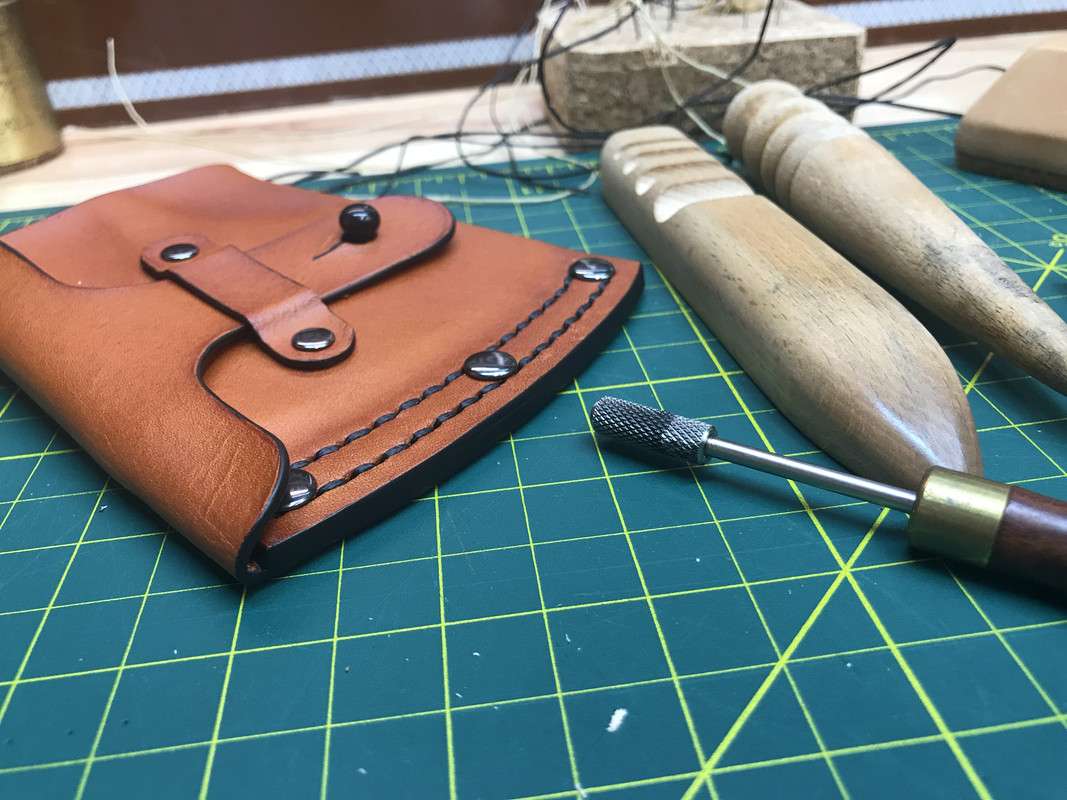

Well done Josh!! Finishing up the edges nicely makes a big difference in the overall look of a project. Did you make a stitching horse for yourself?I finally tried sewing leather. And I used welt construction for the first time. I purposely made it really snug. It barely fits but that's exactly what I wanted!![]()
I also have never burnished the edges either. I used water and the round part of an old file handle. Then I went over it with wax. It was a very simple sheath which is why I decided to try something new. I'm Happy with it!
Being my first time stitching I didn't know I needed one. But after pinching it between my knees while sewing I can see the advantage of having one! That makes your legs cramp in weird places after awhile!Well done Josh!! Finishing up the edges nicely makes a big difference in the overall look of a project. Did you make a stitching horse for yourself?
For sure! A chisel shaped stitching iron to punch your holes is preferable and you can only get your girlfriend to hold the thing for you so many times.Being my first time stitching I didn't know I needed one. But after pinching it between my knees while sewing I can see the advantage of having one! That makes your legs cramp in weird places after awhile!
I used a small dremel drill press for the holes. I need to get a few more items now that I'm doing something new.

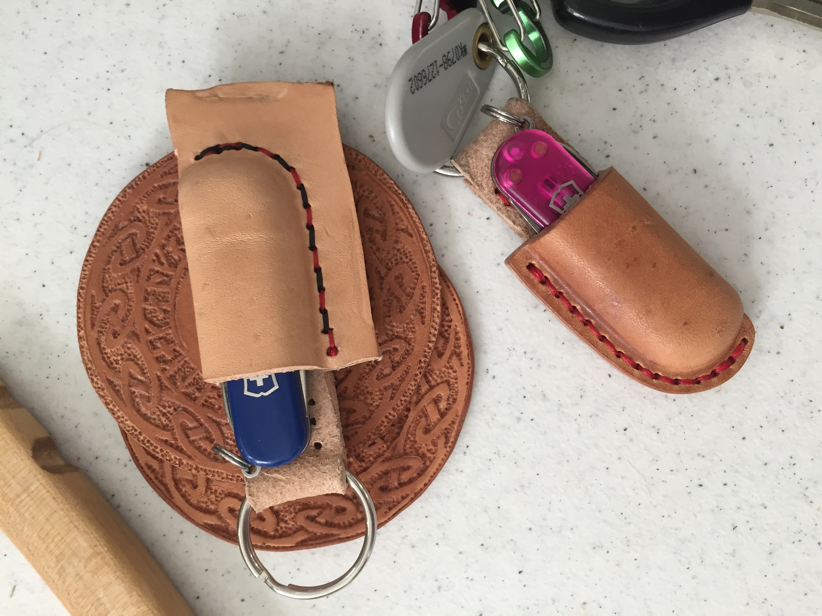

Real nice work! What’s the formed leather project behind it? Earbud case?
Thank you for the kind words! That is a cool little design and your stamping work there is quite sharp. That’s some tough seeding in there.Thank you! The formed piece is a keychain slip for a Vic Classic. I've been making a slew of them to give to friends and family for the Holidays this year. Stocking Stuffers. Here's a finished one I did for my wife. She was the test subject and she likes it. I am doing a few now with a vinegaroon black which looks pretty sharp.
