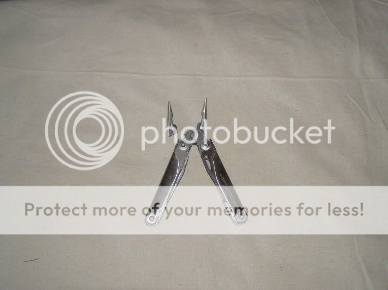

I was using the pliers to pull open a chain while hanging a light in my dining room. Fairly stiff chain, but not that big. I was holding the chain in one hand, twisting it open with the leatherman, and SNAP! I finished the job with a channel lock. I was twisting hard, but it wasn't like I had it in a vise or anything.... This one is going back for warranty work!
PS - I forgot to say, I think LM's ought to be able to handle this sort of thing. It makes me think twice about multi tools....
Man, that looks like a nice, even break - straight line, too.
Is there some structural line where it broke?

The break is very "grainy", almost like some fairly dry mud that you smeared your finger over. Whether or not it means anything, I don't know, but I was pretty surprised when it let go...
But no, no obvious structural line or stress riser or anything like that.

Multi-tools are mass-produced, investment cast pliered, wonders that are most comfortable in the light-medium use roles. Venture into heavy territory and that is where problems start happening, twisting is pretty much a death-knell to most multi-tools since it directly affects the thinners, weakest part of the plier head.
As soon as I encounter a job that requires even moderate twisting I pop the multi back into my wasitband and find a real, forged set of pliers.
