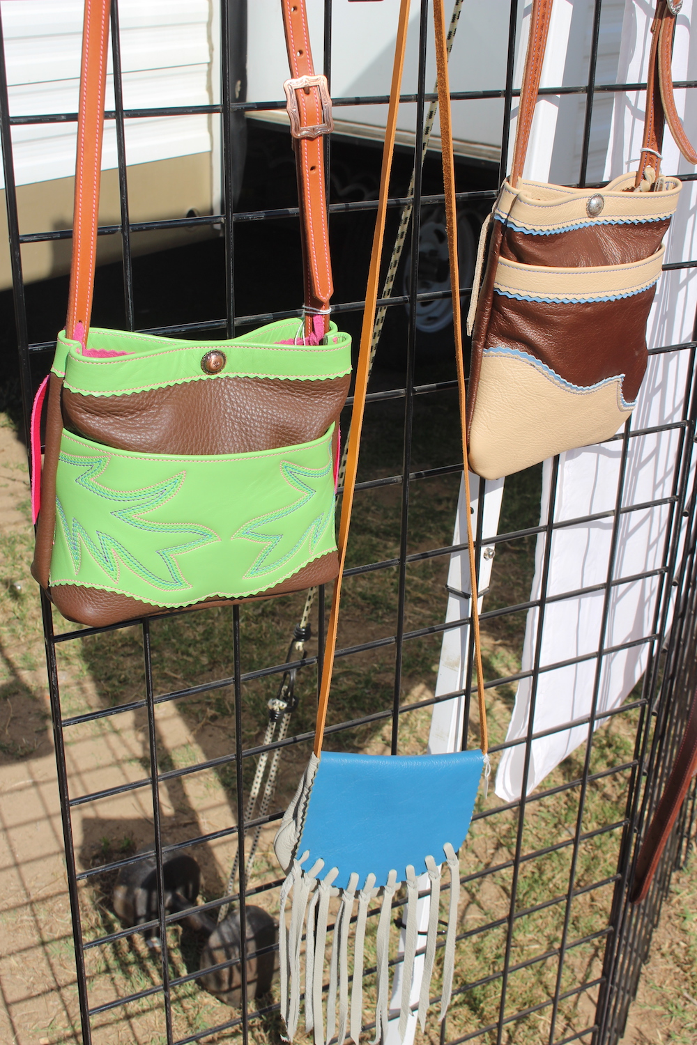

Always love to see your threads and works, very beautiful holsters. Sorry for off topic question. Dave, did you ever made a filigree belt with floral or maybe sheridan carving? What is the most often used for background in this case, between two layers of leather? I saw turquoise and blue background it looks very good.
Thanks Maverick. I've not done any belts that way but have done several checkbooks. I used a contrasting, very thin, garment type leather and then the regular lining. So to do a belt I would want a fairly hefty top layer to carve well and to have body to stand up to the filigreeing, maybe 8 oz or so. Then a very light 2/3 oz contrasting color and then a 4 oz lining leather. If I was using a veg tan for the lining leather I'd maybe split the lining even a little thinner. Lots of cool colors out there. Here's a pic of a few of Nichole's purses at a show in July.
That green is a glazed goatskin, very thin and comes in lots of colors. Nichole had a lady call her up a few years back and said she was going to the Superbowl so needed a purse in the Seattle Seahawks colors. This green was left over from that project.
Yeah, exactly! Very thin contrasting colour leather that's what I need for it. At the beginning I been thinking about atlas or satin ribbon with metallic gloss I like, but it is different material with leather and it wouldn't allow the belt to naturally stretch, I think.
Very nice purses
Thanks a lot for advice!
Ya bet if you're looking for metallic they make many leathers with a metallic finish. Very often used in rodeo chaps. Springfield has quite a few. Thanks.
