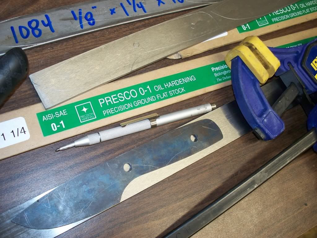

I am just getting started on these, check it out!
I'm making 5 in 1084 high carbon and 10 in O1 tool steel. A few are for orders and a few will be available for sale! I have a ton of cool handle material lined up including my handmade micarta and some cool lined combos!
I made a template from the original in O1 steel and heat treated it so it will scribe tons of knives.

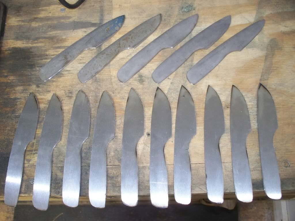

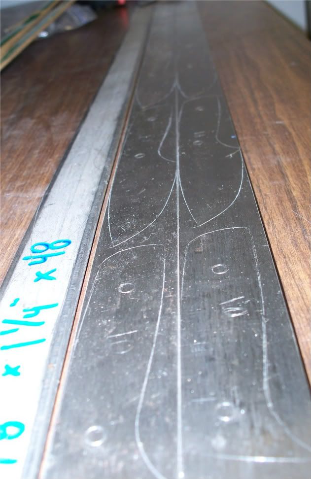

15 scribed out!

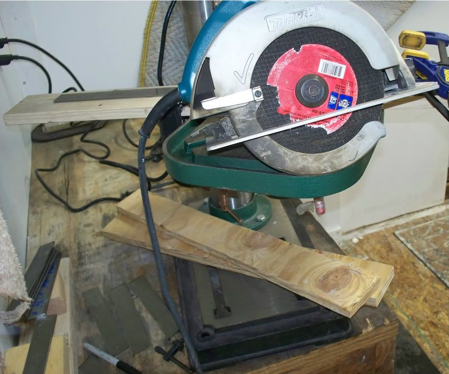

I cut the bars up with a friction blade in a regular carpenters saw.

It's 9 pm and I just got in from working on these and a few other knives. I have the holes drilled and chamfered on all 15!
