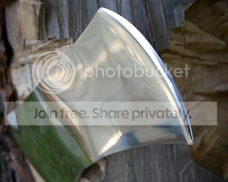

I am sure you guys remember.....a couple days ago I posted pics of this Vintage Collins Legitimus head that I came across.
Well, I got some time to work on it.
It is now the hardest thing that I have to photograph, due to the reflections. But, here is a shot at taking some decent pics of it.
It is not perfect, but I am more than happy with it. It was never meant to be a show piece. I just wanted to get it ready for use again.
I have a 36" hickory handle on the way, but it won't be here until Friday. It will still take a bit before I am done because I plan on doing the sanding, linseed oil, beeswax treatment to the handle.
After that, in my experience, re-handling an axe is easy. Doing it correctly is a real test of patience :D

how did you go about doing this? just on the grinder until all the rust and patina was gone?
looks like a totally new axe from this end.

Pretty much. But most of it was patina, so I really didn't remove material. Just made some dust fly :D
I did the top and bottom against the flat platen. Then on a slack belt, I took just a hair off that edge.
The remaining was done with an 8" wheel, down through all the grits. I saved the edge for last, which was just done on the slack belt, again through all the grits, finishing on leather.
Sounds like a lot, but it really wasn't bad at all.
You can see a couple spots in the picture, where there was a small pit, and it is not shiny. Since it is a user, I did not think it was worth it to remove enough material to make those go away. It is good enough for what I want.
