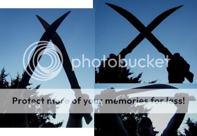

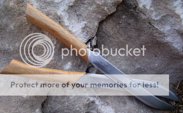

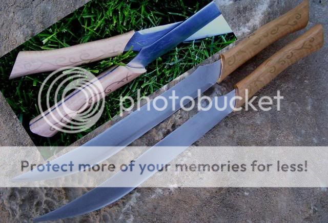

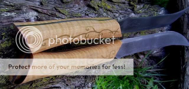

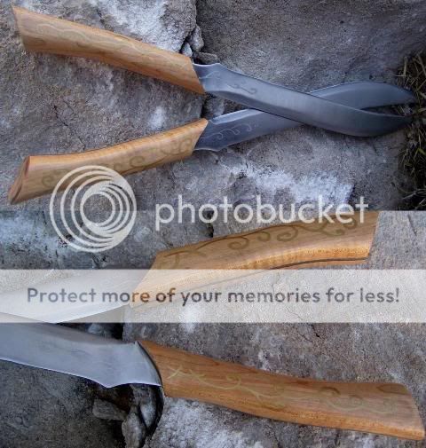

Here is my version of the Legolas Elvish Long-Knives Influenced by the movie “Lord of the Rings”. Hope you like it.
VIDEO: Story of Legolas & His Knives, Fight Scenes, Our Making Of, & Slicing Demonstration of Our Kniveshttp://www.youtube.com/watch?v=_9nrOwWwQAA
Character of Legolas & His Knives:
Legolas Greenleaf was a Sindarin Elf who became a part of the Fellowship of the Ring. Legolas was Prince of Mirkwood, the son of King Thranduil, a descendant from the royal line of Sindarin elves. Legolas primarily uses two weapons when engaged in combat with the forces of evil. The first of these are his Elvish long-knives. Legolas carries two of these, and uses them both with deadly precision. Legolas prefers to use his bows over his knives, and only uses them when he is forced into close combat or runs out of arrows, such as in Amen Hen or at the Deeping Wall of Helm's Deep. However, when he does use them, though they do not match Aragon's masterful sword splay or Gimli's power with the axe, they are quite deadly and can easily kill orcs or Uruk-hai.
Shop Details:
Old Saw Blade Steel was cut out and Normalized @ 1500 degrees until non magnetic, three times, to remove stresses and align crystals. Heat Hardened until blade became nonmagnetic, then quenched in 125 degree quality oil. Tempered the blade to a straw hardness @ 425 degrees for 1 hour, letting it air cool and repeating once more. Blade was file tested and is shown to be very hard.
Measurements:
Total Length = 21“
Blade Length = 14 “
Blade Width = 1 3/8 “
Blade Thickness = 1/8 “
Handle Length = 7 “
Handle Width = 1” x 1 ¼ “
Handle: Tiger Maple Wood with 4 hidden pins & epoxy. Elvish Hand Etching. Also some etching on the blade toward the handle
Weight = 18 oz each
Asking $185 plus $15 shipping fee, if shipped in the US. You can send through Paypal to ScorpionBows@mchsi.com or mail M/O to our address (see web site for address). Includes both knives. At an extra $45, we can provide a leather back sheath.

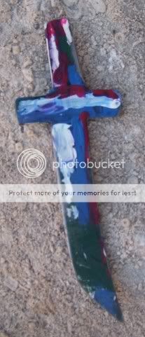

Guys. My son Kyle (6 yrs old) made a knife with me and has been begging for me to put it out on the forum to show off. He drew it. I helped him cut it out and he filed it down and painted it. Wants to be like his daddy. So just for grins, here it is :thumbup::
My son's knife is SOLD! Way to go little buddy! Thank You!
