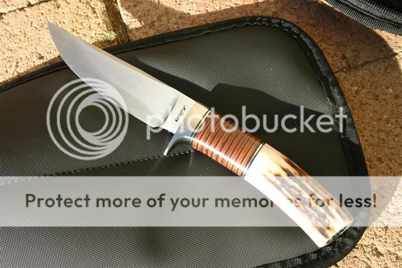

Don't know who did this one.
Scagel-ish. I'm personally not a big fan of guardless knives, but this one is cool.
Thanks, Mike. Snagging random internet pics it's hard to give good credit sometimes.

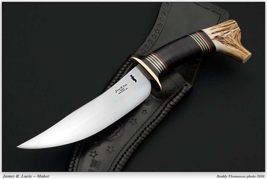

Before he sold his Scagel collection, Dr. Jim Lucie wrote and illustrated a large book on Scagel knives. He also donated a copy to the library in Spring Lake, Michigan.
I received the following from Paul Kessler:
This was a knife that Dr. Lucie made. I have been told that Dr. Lucie considered this one of the finest Scagel style knives that he has made.
The leather spacer's in the handle were originally from William Scagel's shop.
This photo of the knife is in Dr. Lucie's book about W, Scagel.
I have spoken with Dr. Lucie often and have become friends with him.
After his book was published Dr. Lucie asked me if I would consider selling this knife back to him so that he could pass it on to his daughters.
I did sell it back to the family.
Please feel free to post this photo to your thread on the Forum.

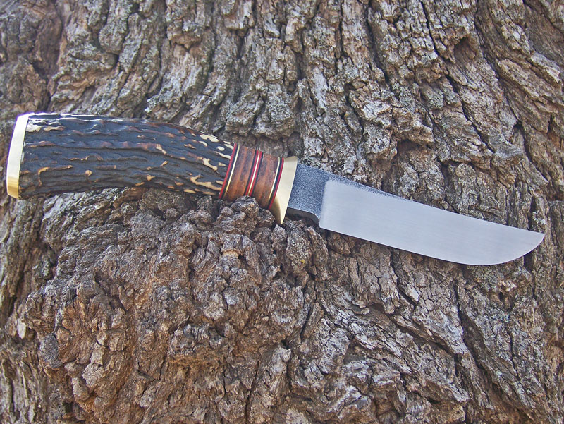

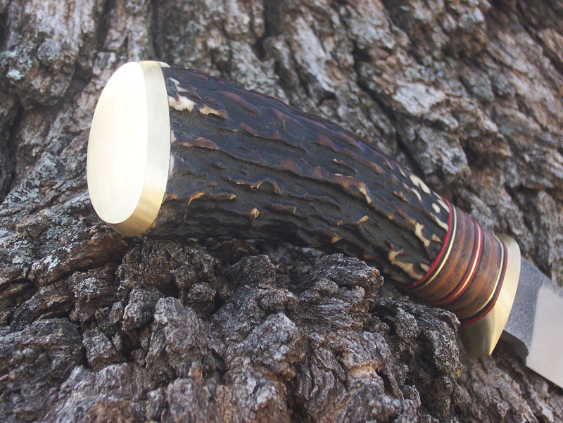

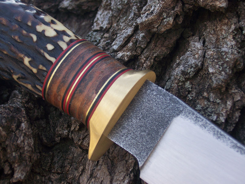

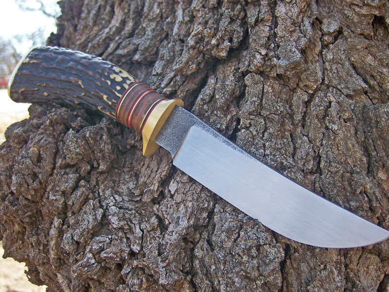

I got a nice Sambar taper at our knife club Christmas exchange, but it was too short. What do you do with short stag? Make a Scagel, of course. After the thread above, now it's time to show the knife I made.
This knife is 1080 carbon steel, mill scale on the flats, 600 grit satin finish on the bevels. In true Scagel style, the guard and butt cap are brass, with fiber, leather, and brass spacers. This knife is held together with a threaded rod and nut under the butt plate, and the butt is pinned on with four pins. Good luck figuring out where the pins are. This is as close to as flawless of a guard fit as I've ever done. OAL is 10" with a 5 1/4 blade.
Profile
Tip looking back
I like big butts and I cannot lie
No gaps!
Take a plunge, even
