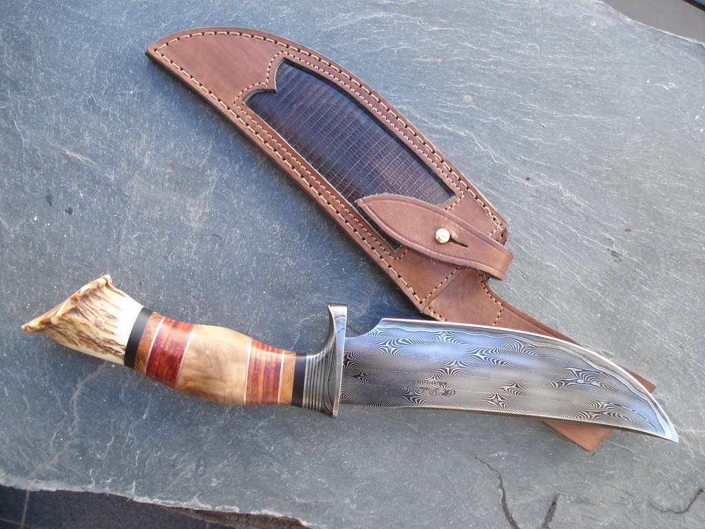

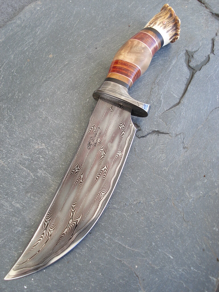

here is one of mine
Mauricio daletzky-juan rossi collaboration
san mai with a series of seven twisted bars of 1010 and 1070 on the outside, separated from the core of 52100 by a thin layer of 15n20 to add some contrast.
