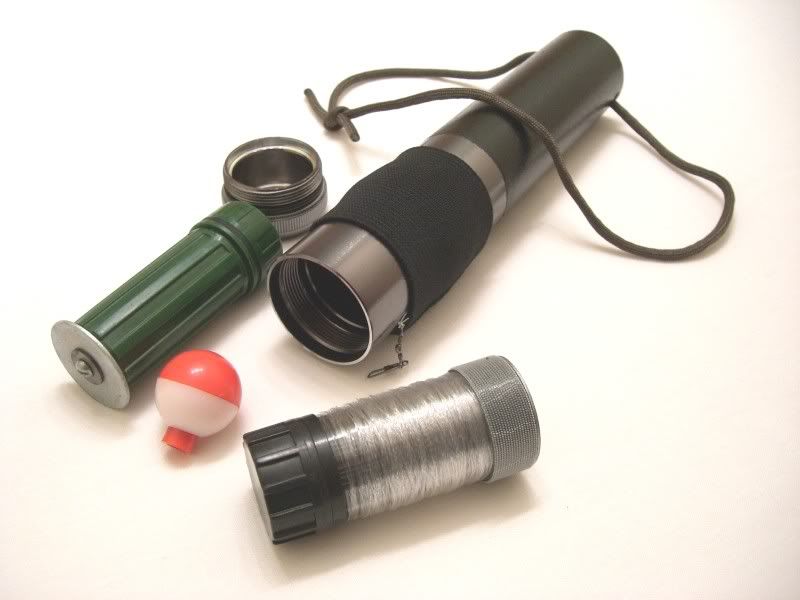

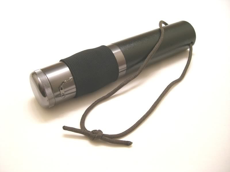

Here's one I made.
Even with standard spinning gear it took me a while keep fishing line untangled.

That's pretty cool Silas. I like the separate container for all the hooks. Good idea!

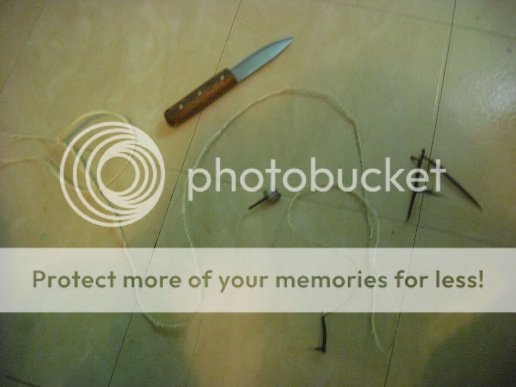

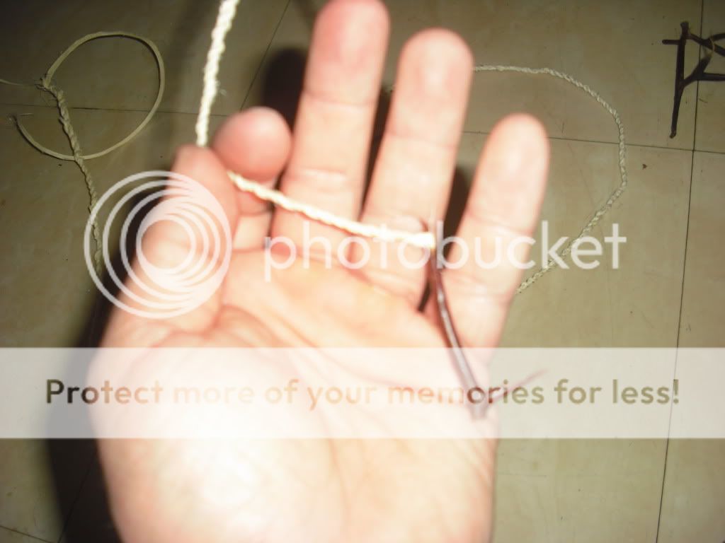

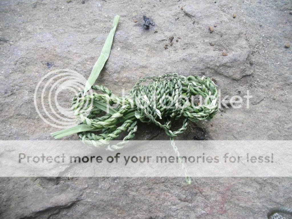

i don't Carry a specific fishing kit... But here are a few I've made our out of primtive supplies.. I've gotten some hits on both rigs.. But haven;t pulled anything in witht hem yet... also as a side note... (if you roll natural cordage up wet and leave it for a spell it will mold...
Wysteria bark cordage and black locust thorn hooks
catttail cordage and black locust thorn hooks
improvised fly
I have a set made of dogbane as well but haven;t take a pic of it yet.. but I think that will be the winner maybe when combined with a gorge hook.
