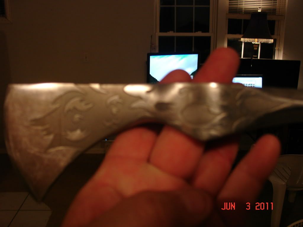

and,while it took forever.
i had all the wrong tools with the right will. started with a spike hawk out of the box with the intention of a weekend present for a friend.
oh. how was i so,so wrong.my machinists friends told me,nasty, to get a smooth, glass like finish you must file. and file. marry a girl,have children and all the while you must
file for 24 hours a day.
so i filed. i had old and i bought new. i bragged on my filin' until i got hung up on-twice.
i read every piece online i could find about how to get that orange peel off of my Hawks.(all the while filin',ruining a good cell phone and a key board with the metal dust)
i tried melting lead into the screw hole one night after a bad run at poker and was laid up for almost two weeks(which,in this condition, i did not file any metal mind you) from having my nose two inches away from the fish weights and torch. i might add i melted this mess in a ripped open beer can with the stereo blasting in the barn.
i tried various mediums for my acis etch after i had given up on the perfect polish. finally settled on contact paper-good choice but clean your metal first and don't cut too deep nor handle it over and over again-it will let the acid seep in.
and it did.
so i freehanded my pattern,painted three coats of Krylon,peeled the sticky and went for it.
here is the painted head about to go in. i cleaned with a Qtip and alcohol
made a jug from a Coke bottle which let me roll it around all the time- i did, one hour one side , flipped it. one hour other side,flipped it. 15 mins,15 mins and out,rinsed. should have left it for at least two more hours as i wanted the etch deep. but with the coke bottle i could just twist the cap and rotate it. then just opened the cap to pour it back into the bottle it came from
the lines got all blurry because i did not clean it well enough and handled it too much. so the etch was a mess. i will polish it out and do the haft,then post more pics
