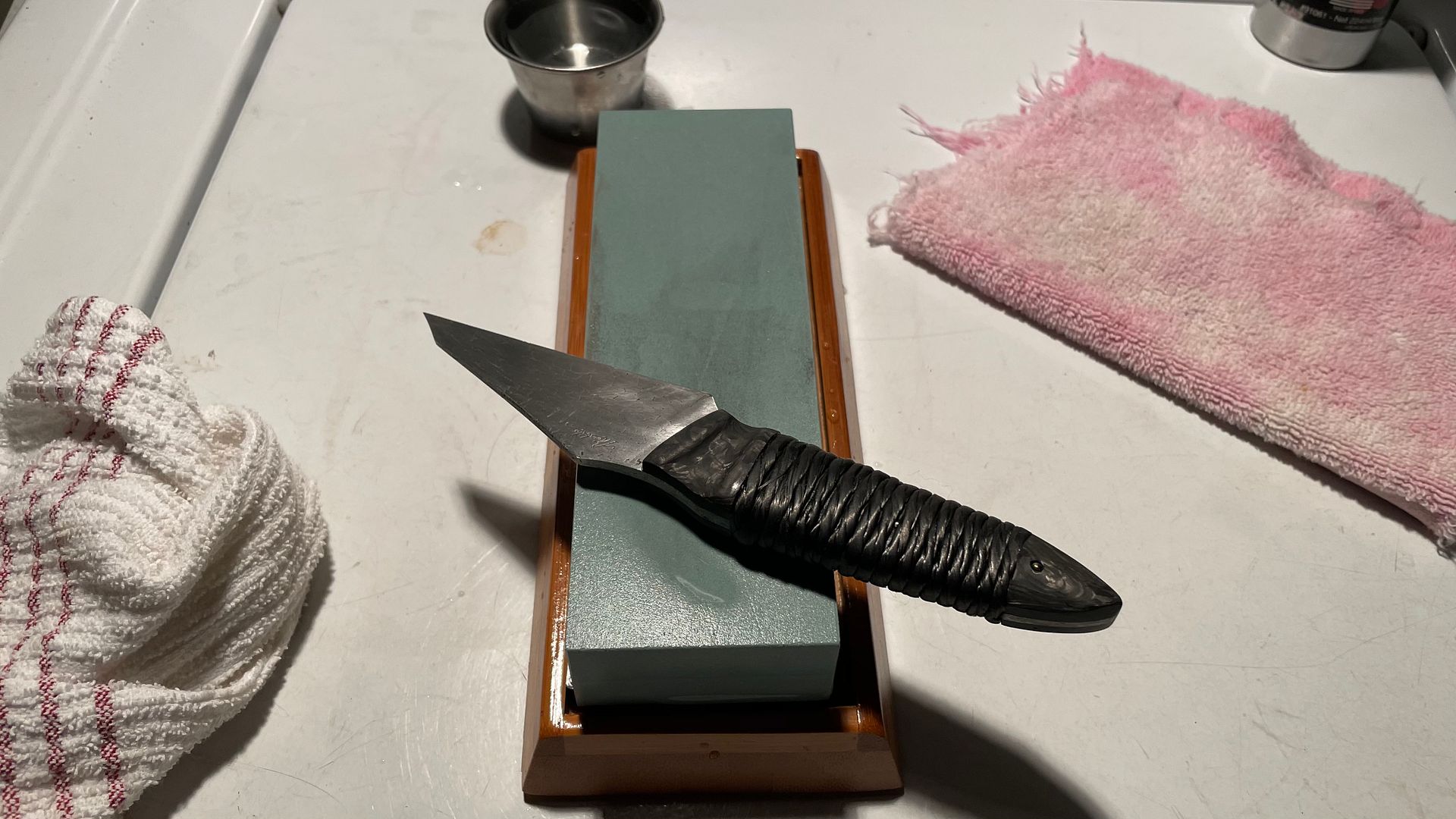

I’ve been beating up my edc enough these days that a quick session with a jewelstik would not suffice so I broke out a new wet-stone
I’ve always been a free hand stone sharpener when I was a kid it was an Arkansas stone and oil
What works for you ?
Knife is a Mirabile WHARNCLIFFE
