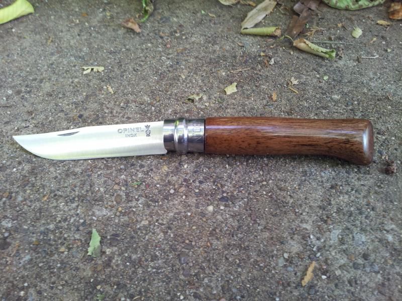

I thought I knew the answer.. but I'm guessing I might need a few more tips..
How do you get f shine? did you sand through the grits up to like 2000? or use a buffing wheel..??
Got myself an oak inox #8 and strted with 240, 400 and 600 grit but need to order in some higher grades.. or am I wasteing my time?
The stainless blades on some of the pricier 'exotic' wood Opi's are factory-polished, unlike the satin-finish seen on the less-expensive ones. I'm assuming this may be one of the polished ones (the ebony-handled models aren't cheap, at $50+).
Having said that, the satin blades can be polished with a very tight sandpaper sequence (400/600/800/1000/1200/1500/2000 and beyond), followed with Flitz/Simichrome or similar polish made for hardened metals like stainless steel. The tighter the sequence is, with the narrowest gaps in grit, the better the results will be.
David
The other trick to getting a mirror finish is to sand at right angles to the previous pass.
I'll take alternating passes of spine to edge and then tang to tip. Continue with each pass until there is absolutely no sign of the previous pass. By working at right angles, it's usually pretty easy to see marks from the prior pass under light. This trick helps ensure you stick with the next grit up long enough to work down through the previous grit. With higher grits (800 and up) I'll work both directions with hte same grit before moving up.
Yet another trick that I have used is a good set of cork belts and the right polishing compounds applied on them.
I believe this gives a much cleaner and more crisp finish than any buffer. It will not lift out logos either.
Kevin

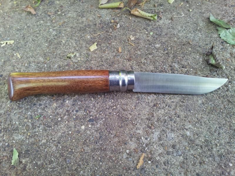

I did a little stain and sharpening job on this #8 for my wife:

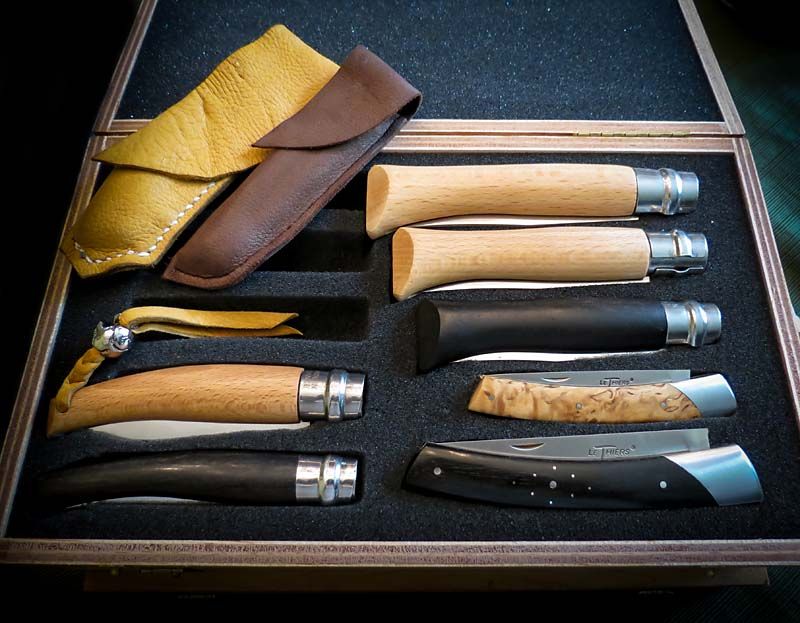

a quick photo of my French Quarter...for now at least!
Left side is the
#8 Garden
#8 Slim in Ebony
Top right is the
#10 it's a very good size folder!! but manageable
#9 also pretty good size knife
#8 in Ebony, polished blade and that's the one I had engraved with the Celtic cross
Le Compact Le Thiers by Chambriard in Curly Birch scales
Le Compagnon Le Thiers by Chambriard in Ebony scales
That'll do for a while, the box is one I picked up at work and converted as a holding case, safer than just setting in the drawer.
The two slip sheaths, the lighter coloured one is glued and hand sewn elk skin, hard to hand sew that stuff, the second is a thinner leather I glued and had my wife sew on a sewing machine for me, she didn't care to do that but it came out ok, those are for holding the Le Thiers by Chambriard knives, I designed them so the longer flap covers the opening helping to keep out the crud/dust and crap that floats around in my pocket.
G2
edited to add the Celtic cross engraving they put on for me
