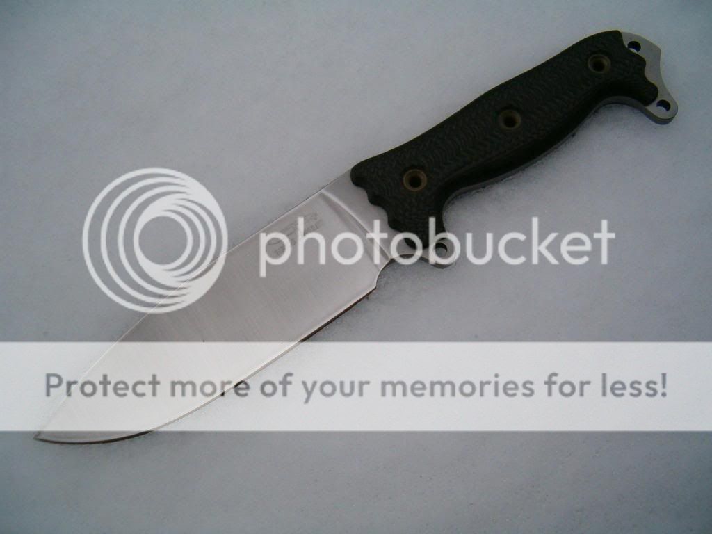

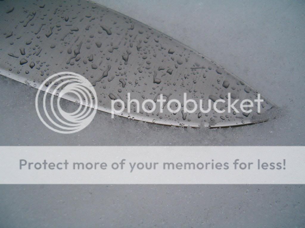

since there was a recent thread about good edge angles

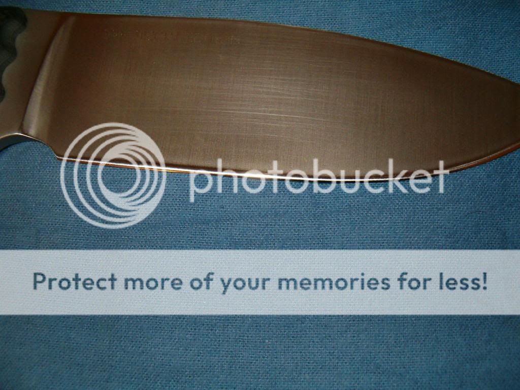

not really sure what the angle on this ASH1 07 SE is, but the edge was super thin (thinner than my BAD), then i took it down even more and convexed it :eek:. here it is after sharpening a second time to get a ding out (from impacting a rock):
biting into some fairly tough wood:
and no damage. not even a roll

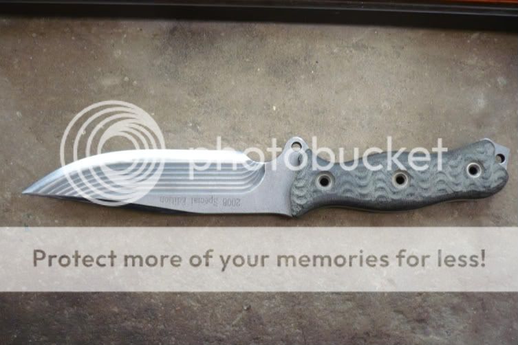

Jerry, i know you like the skinny a lot as a fighter, but i would crap my pants if i had to fight somebody with an 07 SE.

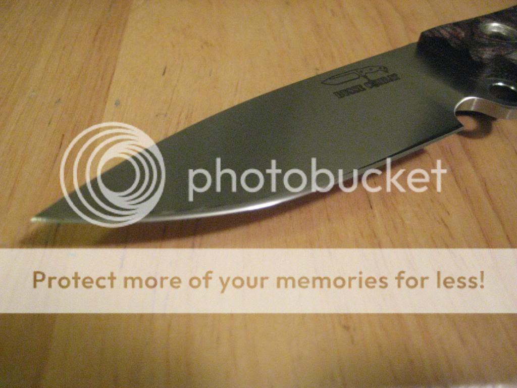

These two with the convexed edges are very sharp. They pop hair, and push cut paper like no one's business.
The Red/black handled BAD I traded for an Ash 1 cg probably would have been the thinnest slicer If I had been able to keep it. I had started polishing the edge on my strop.
My CG ash now sports a convexed edge, but not near as thin as the SS. The edge still push cuts paper and pops hair though.

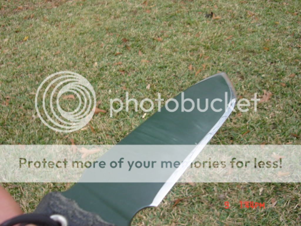

reprofiled ASH-1 after fire wood duty

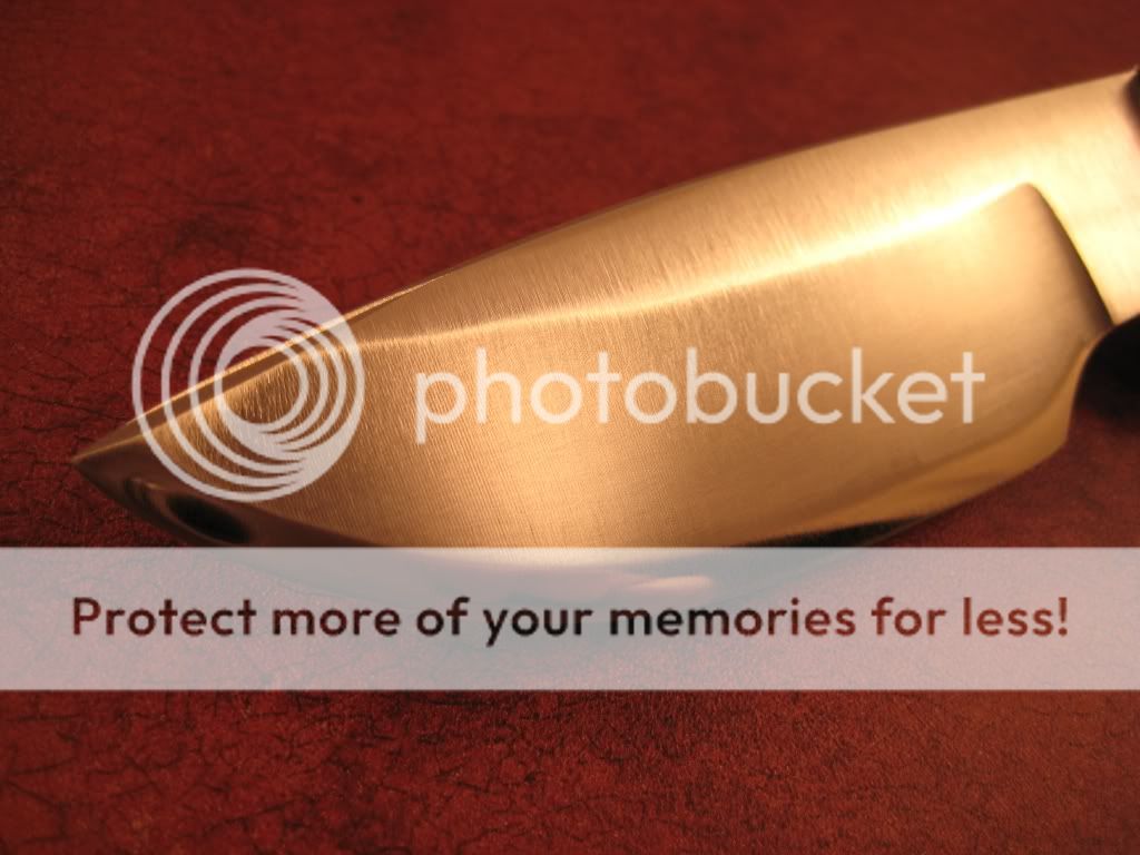

Here's a set of .220" GWs, on left is from Busse, on right is my doing.

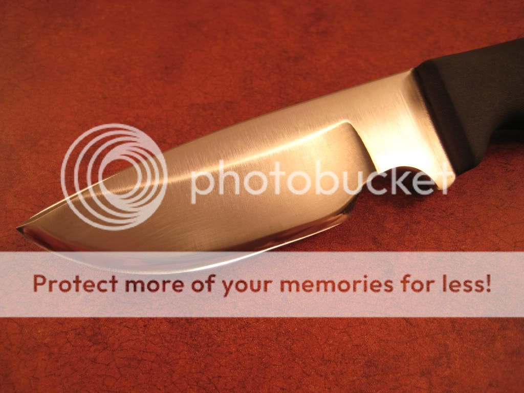

Stock on right, my doing on the left:
I haven't used it much since then but if I did I would be careful!

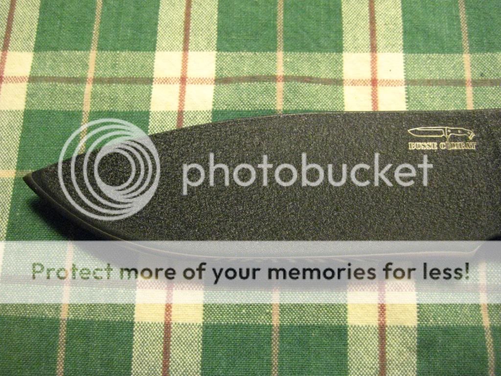

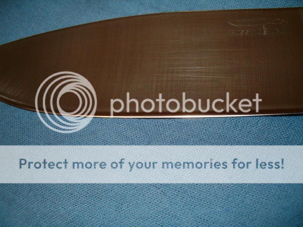

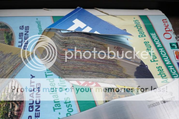

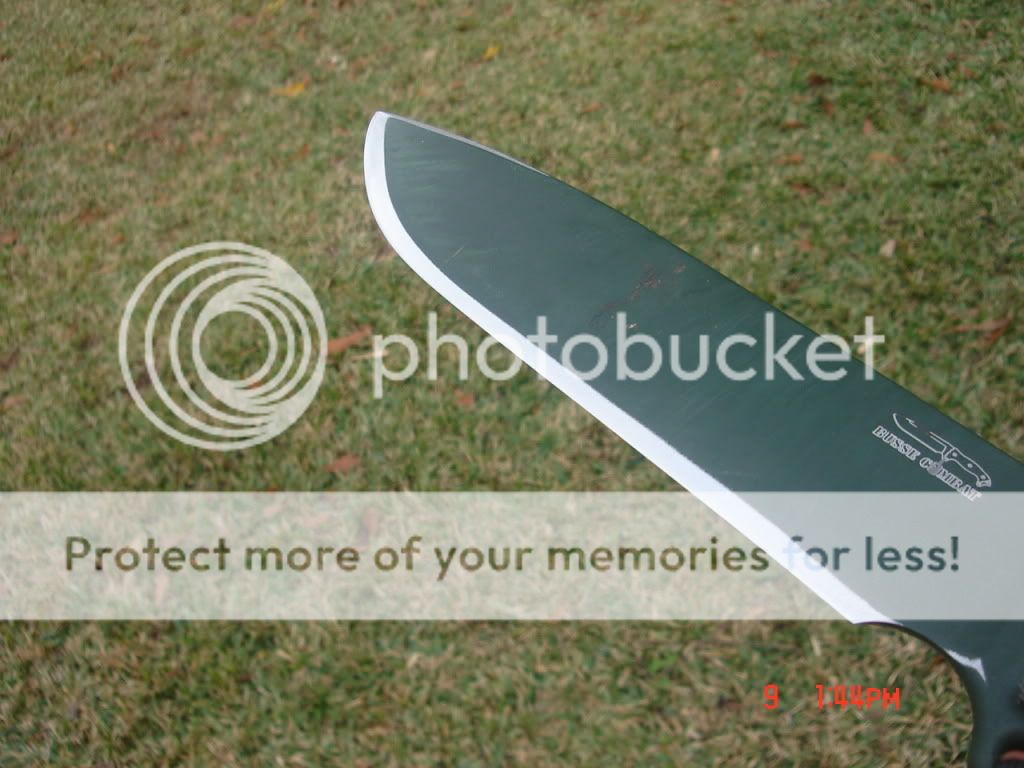

Here is my Satin FBM reprofiled and stropped to an approx 20 degree convex or 40 degree inclusive
The cuts through the directory were smooth and done to determine if the edge would roll....because too thin is as much a problem as too thick...it did'nt and seems the optimum for me.

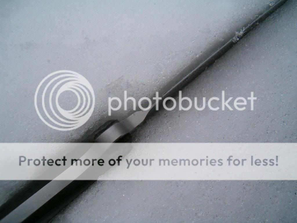

Here is my Jackhammer which I reprofiled the convex edge slightly....thinning it down to reduce resistance and take a sharper edge...this is approx 18 degrees convex per side and 36 degrees inclusive. I also sharpened the clip which is an obtuse 25 degree per side or 50 inclusive.

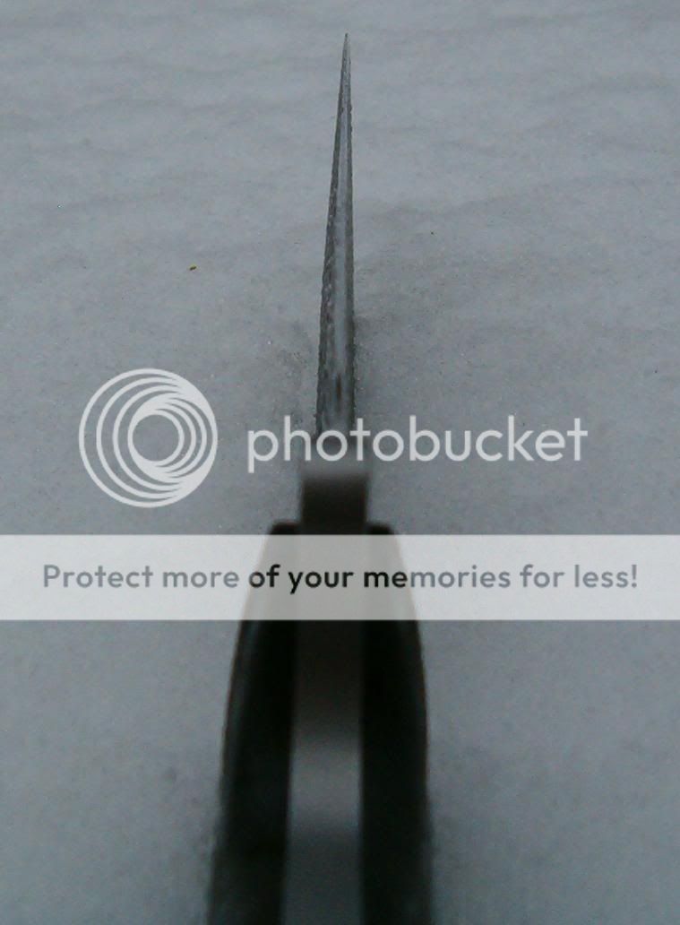

You didn't do all that work by hand did you? If you used a grinder or belt sander how did you avoid ruining the heat treat?
Yep, I did it by hand. :thumbup: It didn't take too long on the DMT XX Coarse, Coarse, Fine, then sandpaper.
