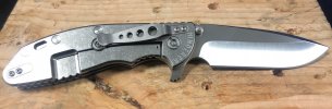

Been meaning to get one of these holey clips for a while. Ended up removing the ano from a blue stonewashed one. Also, all hardware is de-anodized Hinderer Ti stuff. Thanks to ferider for the plug on the ti torx head clip screws from that knife supply place.
Gorgeous knife, talk about a little envy :) Is that an original grind from the Ranch ? Also, how do you de-anodize, looks like you kept the clip stone-washed.
BTW, not sure I should have given the pointer on the screws, they are sold out for a while now .... J/K. Found another source for some real pretty T8 2-56 screws: https://ticonnector.com/product/2-56-button-head-screws. You can see them on the Slicer in post #4285.
Hey, thanks a lot man! Yes that is a custom spear point 24 ground by the man himself. Saved up for a while and pulled the trigger earlier this year. For sure my grail of grails.
For removing anodization in general, I’ve been using a product called Alumabrite. It’s some pretty caustic stuff used for cleaning dirty aluminum boat hulls (I know, gnarly right?) lol
I usually cut it one to one with distilled water, and have an additional cup of distilled h20 nearby to dunk the parts in and deactivate the cleaner. Even diluted, it works quick so you want to be on the ball or it could start to dull the Ti finish. If that happens, a polish always clears it up.
Hope that helps. If you or anyone has questions, don’t hesitate.
