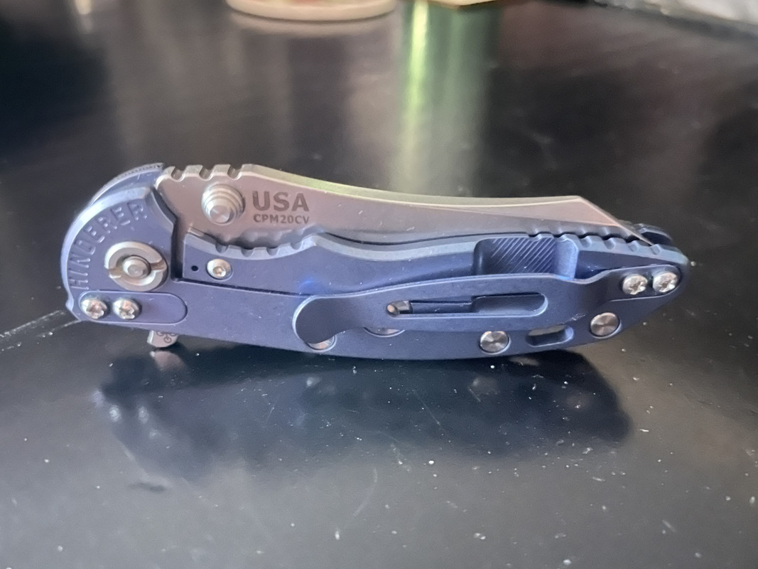

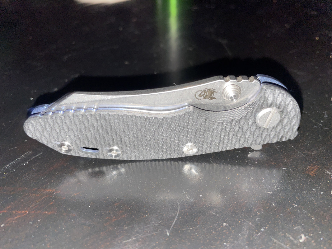

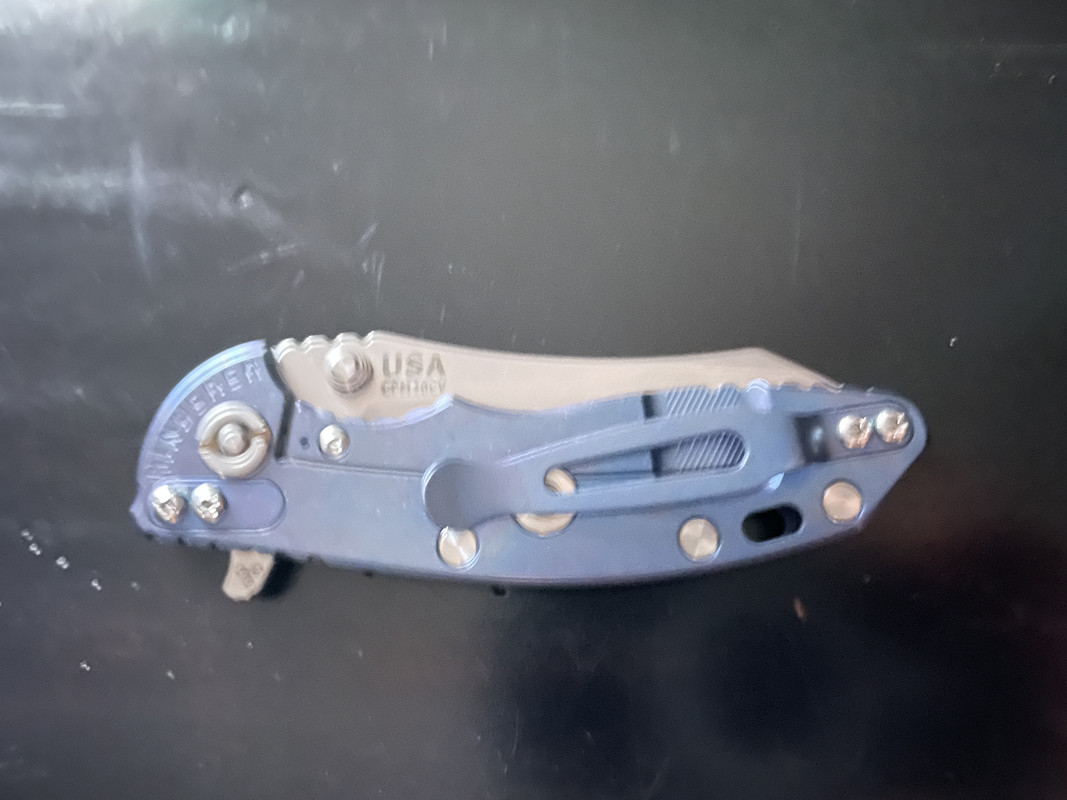

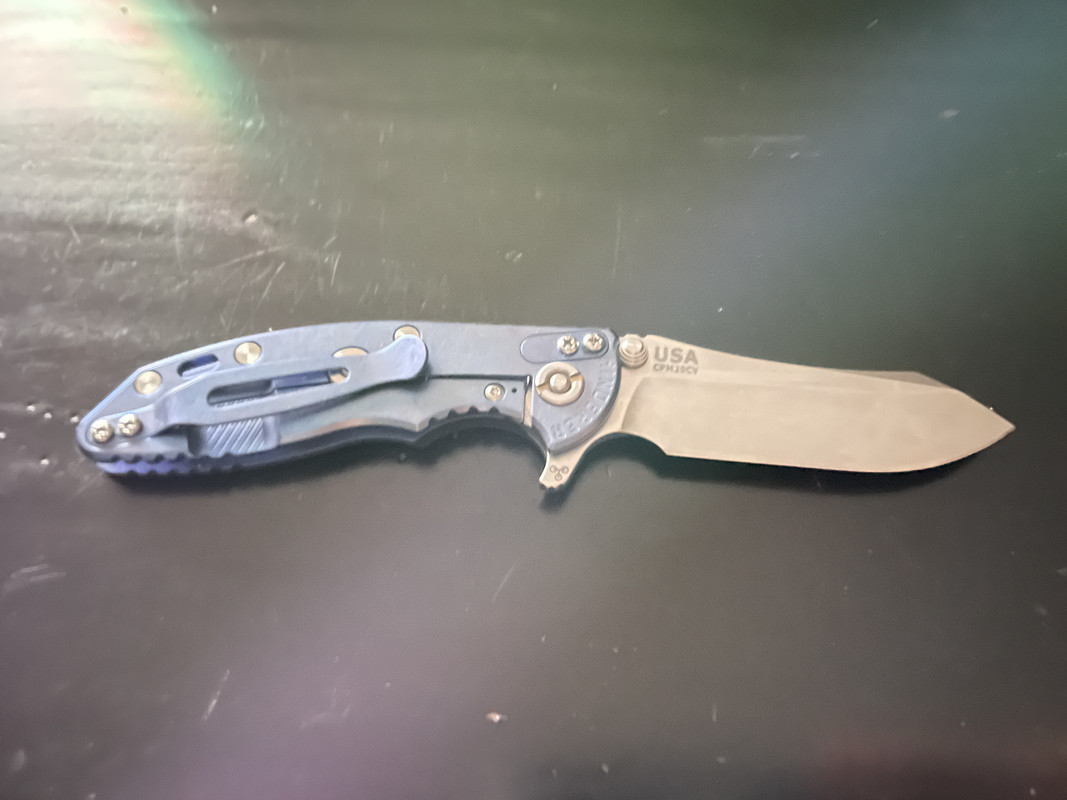

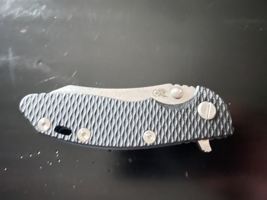

I’m a little worried about this XM-18 3.0 though because the frame lock barely engages the tang and if I push with a little force on the spine of the blade it fails. Not sure if I can adjust this somehow to correct or if my only choice is to send it for warranty repair/replacement. Any advice? I did remove the nylon washers and spacers and put the bearings in. Everything seemed to go back together correctly even the stop pin.
Yep my guess is that its not centered well and the blade tang is cocked a bit to the lock side.Center the blade as good as you can. Then, use it some more, they do wear in ...
Thanks. I did check centering before and it’s dead center. I assume the bearings don’t have to be placed facing a certain way correct?Yep my guess is that its not centered well and the blade tang is cocked a bit to the lock side.
Correct.Thanks. I did check centering before and it’s dead center. I assume the bearings don’t have to be placed facing a certain way correct?
Just send it back to Hinderer. These are high-end products and you shouldn’t settle for bs. It happens. I’ve sent knives back to them and they’re great to deal with.I’m a little worried about this XM-18 3.0 though because the frame lock barely engages the tang and if I push with a little force on the spine of the blade it fails. Not sure if I can adjust this somehow to correct or if my only choice is to send it for warranty repair/replacement. Any advice? I did remove the nylon washers and spacers and put the bearings in. Everything seemed to go back together correctly even the stop pin.
I would love to no where you got this scale from! because I have a older hinderer bowie I would love to put this on, thank you.
double checked centering again today in daylight and I guess it was just slightly off to the lock side. Adjusted and now it's perfectly fine. I appreciate everyone's advice, I was really hoping I wouldn't have to send it in for service. On a positive note, it's very sharp, unlike my 3.5. Really like them both though. Great solid knives. I like the skinner blade much more than the recurve.Just send it back to Hinderer. These are high-end products and you shouldn’t settle for bs. It happens. I’ve sent knives back to them and they’re great to deal with.
