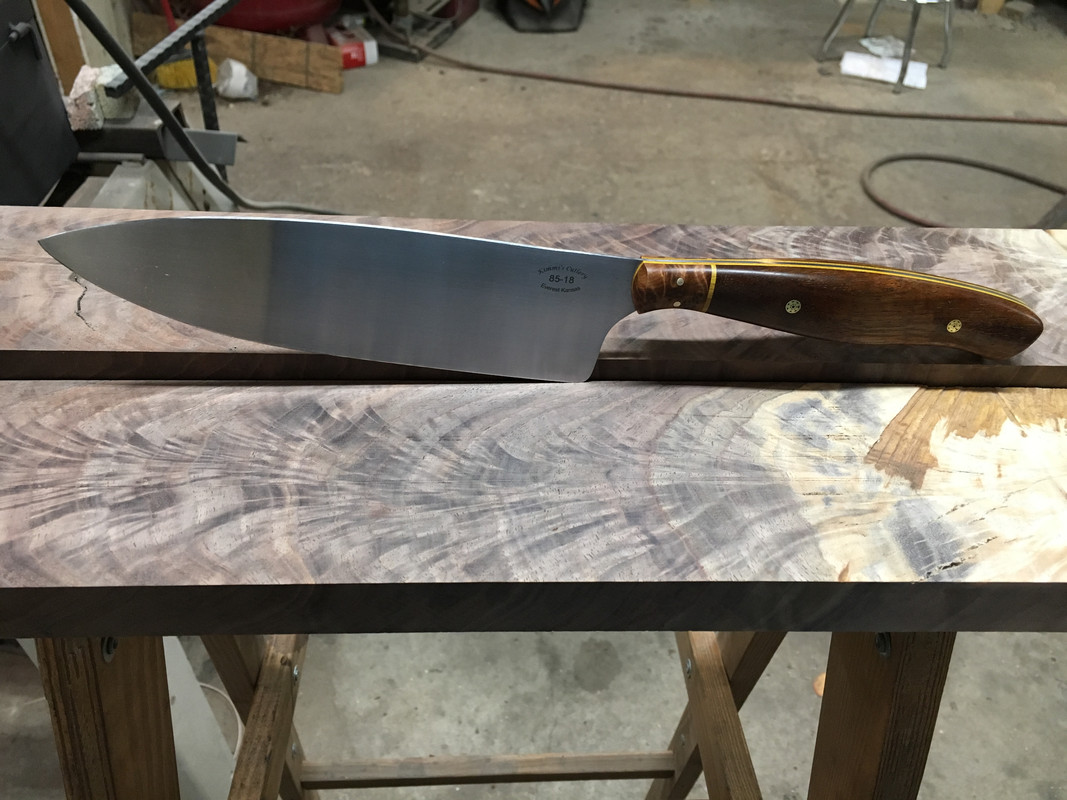

re-purposed 15n20 bandsaw steel at rc63-64 with a salvaged rock maple handle.

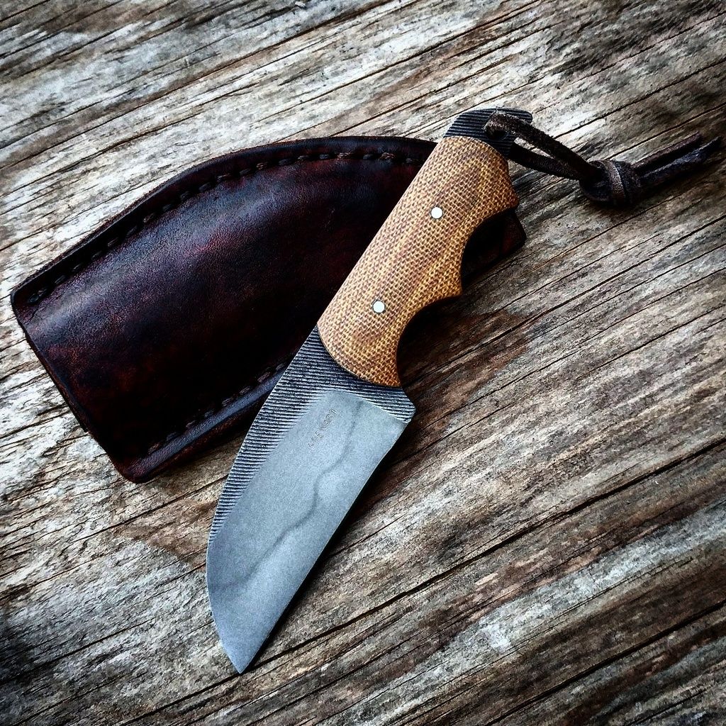

Here's a smaller EDC knife I forged out from an old K&F file. The style was inspired by some of the smaller knives that Don Fogg made in the past.
A picture for size reference:
Sorry, wanted to add one more shot that I liked ;) . The spine is polished and blued all the way around and rounded at the choil for comfort:

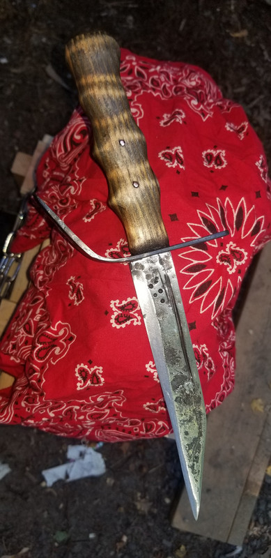

This Seax is the first knife or anything for that matter that i've ever forged. It was forged from an old open end wrench. The second thing I ever forged is the guard made from an old round file. The handle is recycled wood from a shipping crate and the pins are made from twisting together strands of solid core copper wire.
