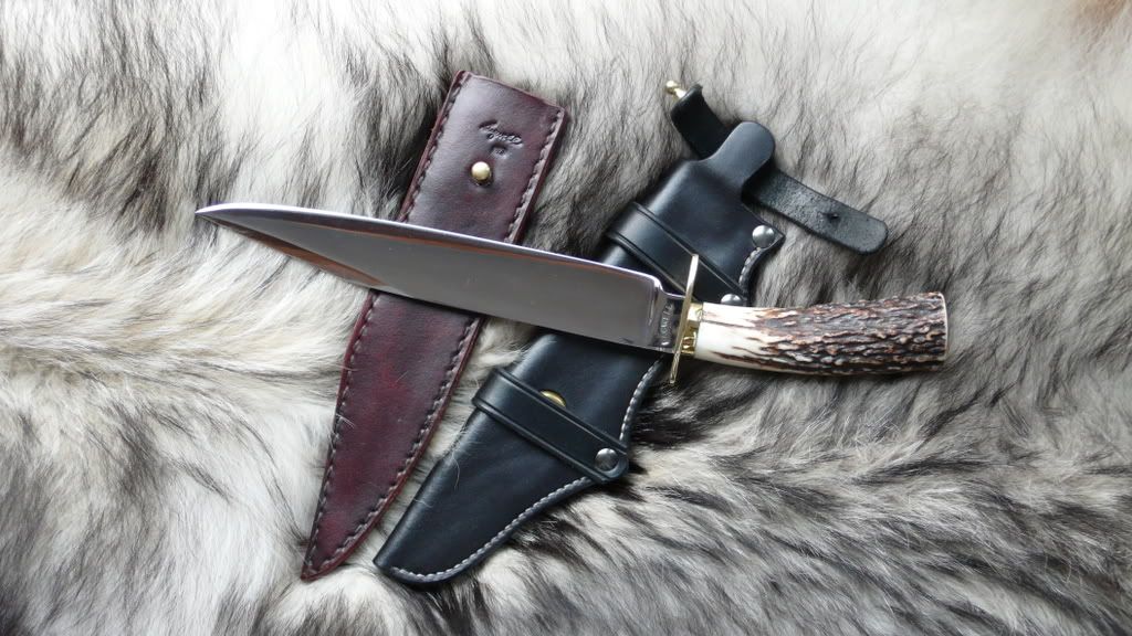

hand-forged mini-bowie from an oceanographic vessel's rudder bearing (and cage):
