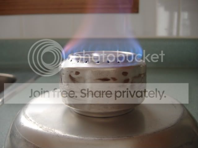

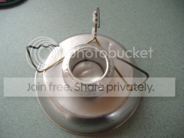

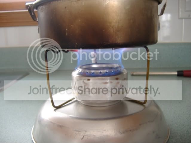

Halcon stove: http://thehanddrill.com/halconstove.htm
I made a wind shield out of some aluminum flashing that I had around, which improved the flame concentration. The whole shebang fits in a 400mL Ti cup which I used to test it out with.
The bottom line as far as I am concerned is this: It's nice to have the ability to make a functional stove out of something as common as a single soda can, but I'll stick to my MSR stove when backpacking.

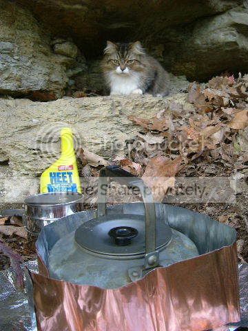

Tea in my woods with Kittygirl using Sgt Rocks alcohol Ion stove
