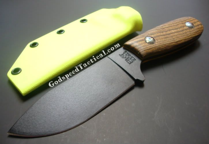

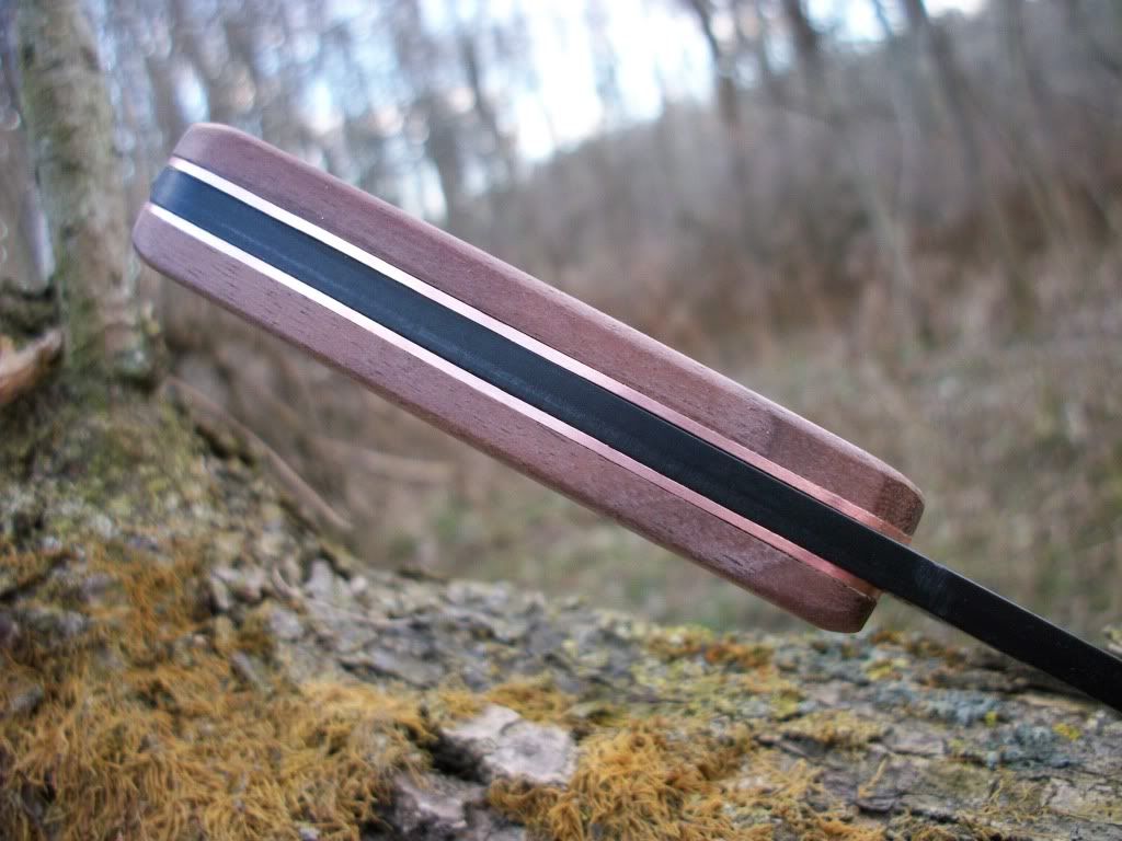

Lets see some wooden scales!
Not mine but definitely cool wooden scale setups

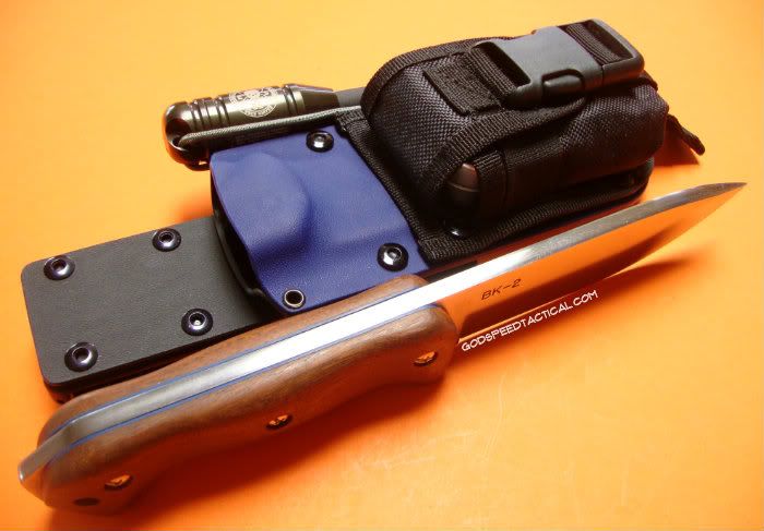

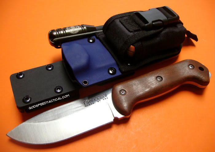

BK14 w/yellow liners:
BK2 w/blue liners

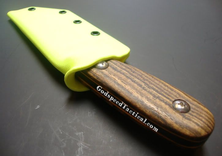

Eli

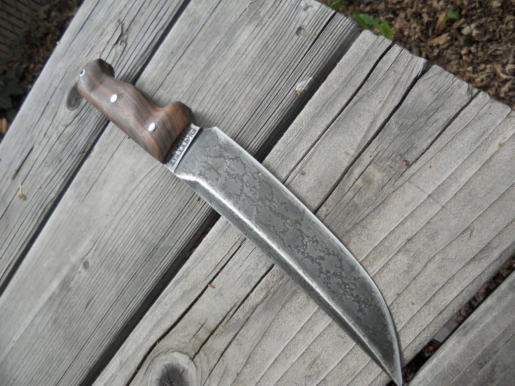

Tommythewho has done most of my wooden scales.
This one is Clich's Snakeskin 5. He did all the handle work on it.
