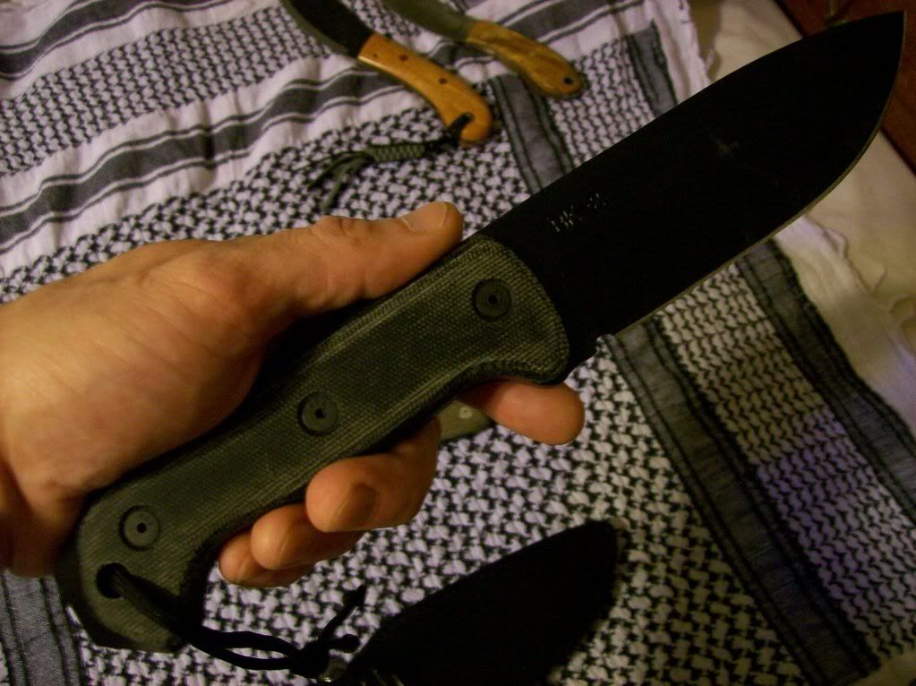

all I can say is what a GREAT knife overall and superb for the money. Im about to order 1 from tomars and I am undecided if I should get the micarta handles to go with it, also Ive heard you can get stainless bolts for the handle as well so I need your help.
can you guys please post pics of your customized BK2's with micarta handles and stripped blades and any other stuff youve done to them? and what do you think of the handles? worth the extra cash?
also where do you get the stainless hardware from?

''The Fasteners for the BK-2, 3, 7, 77, 9 are Socket Head Cap screws #10-24 x 5/8" L.
I was able to get #10-24 x 3/4" L screws that worked perfectly on my 2. The very tip of the screw is exposed but it doesn't bother my grip at all and hasn't caused any blisters or annoyance yet.
I also threw on stainless locking nuts so I didn't have to do the teflon/loctite trick on them.
Best of luck, I'm sure you'll get to see plenty of pretty babies here.
This is my BK2 with Micarta handles. The stainless hardware can be found at most hardware stores--I need to stop being lazy and go get some for myself.:o
Oh, I forgot to answer your other question--I feel that the micarta handles are worth the extra money. They have a great feel, and they just look cool!

Here's mine, from Chestnut Ridge Knife Shop. This is how it came, minus some use. It is black micarta, dark grey really. The sheath in the pic is from Armorall leather, actually from my ESEE 5. My handle scales are flat, and the knife is quite loose in the original sheath.
