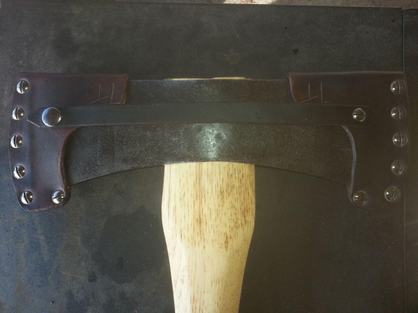

I have gotten some from a local Tandy store, I've found others on the internet.
Nice! Where do you get your snaps?
The "washers" or burrs aren't supposed slide down the rivet.
I use the scrap of thick walled tubing in the above photo to pound the burr down tight. Then if needed, trim the rivet off with a side cutter. This will leave enough to peen the rivet over the burr. I peen them down to where none of the rivet is above the burr. If it's not smooth it could catch on something like clothing or fingers.And IMHO it looks better.

It's easy, beautiful, and says "handmade" like no other. Basics are, use an overstitch wheel to mark the leather, punch the holes with an awl, then, the needle goes through each hole twice. Pliers are helpful to pull the needle through the holes.
