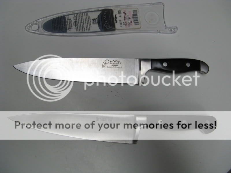

I only have two GOOD kitchen knives, and both are chef's knives:

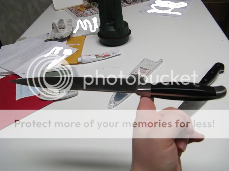

the one on top is my favorite - fits well in my hand, well-balanced(POB in the center of the bolster), and holds an edge well. I picked it up at TJMAXX for twelve dollars and originally intended to grind the edge off and use it as a costume prop. turned out to be so much better than what i had that i dulled one of my old ones instead. :D
the bottom one i found at Big Lots for THREE dollars. :eek:
it's nice too, but it doesn't fit me quite as well, so it doesn't get much use.

Very nice knives, darth kcorbe! My hands would probably enjoy the Sabatier more, but my eyes are drawn towards the Pradel.
