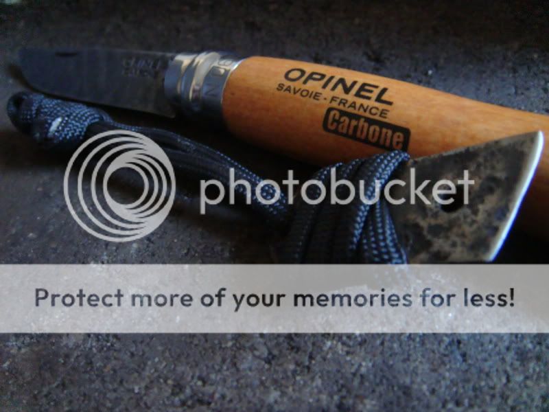

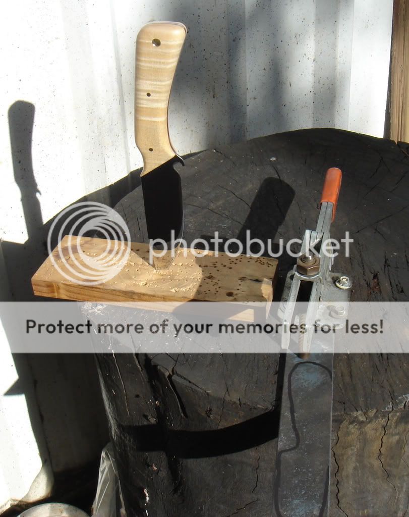

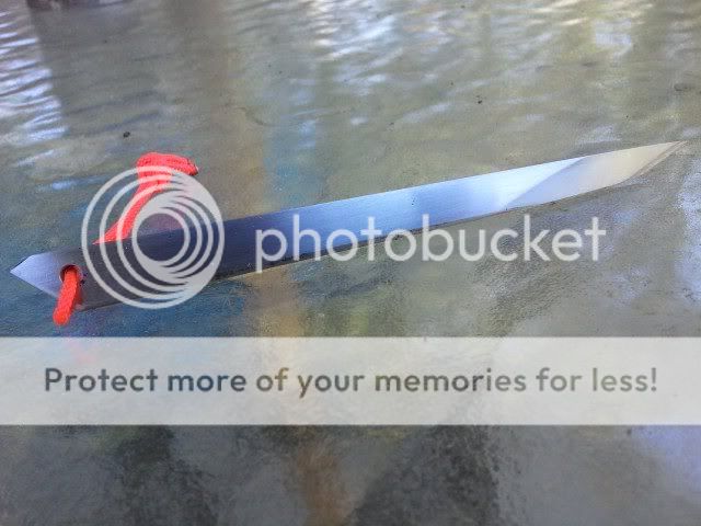

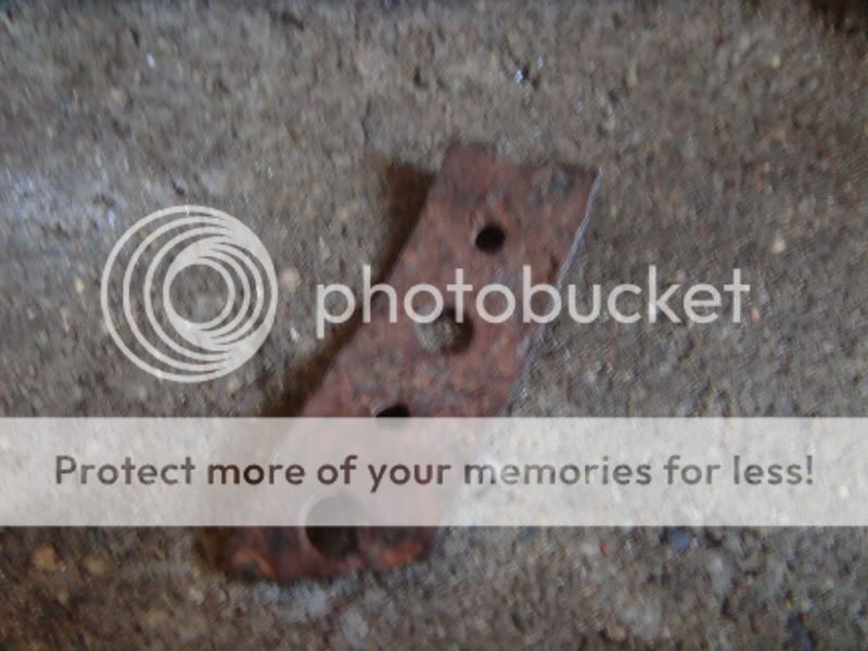

The other day I found this lodged in the dirt outside my apartment, and decided to take my first delve into knife making

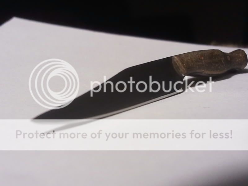

Then after a lot of time sanding, pounding, heat treating and sharpening it turned into a small Dashi

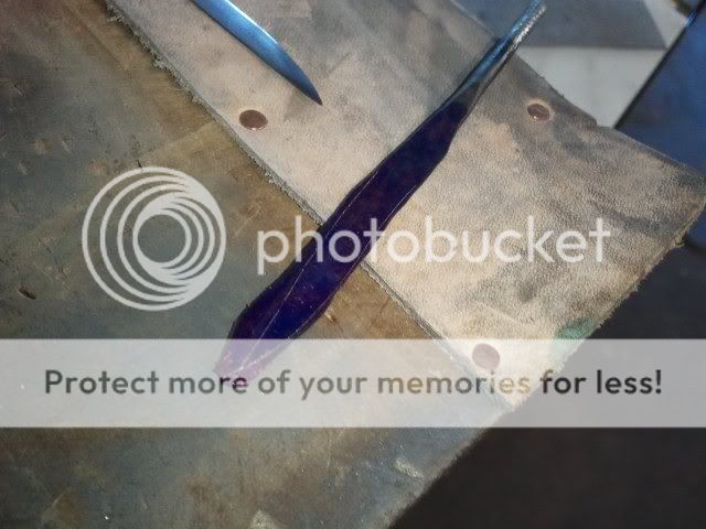

Old knife files sharpened, as I grind down the back of the blade I let it heat enough to turn it blue without letting the blue reach the cutting edge for half-a$$ differential hardening. I actually really like knives I make this way as the edge is still very hard.

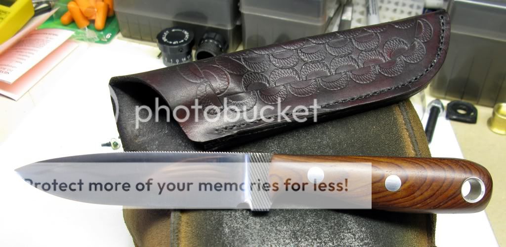

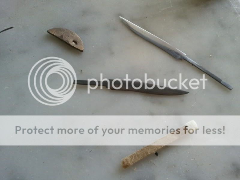

A while back when I was working at a knife store, they changed a Benchmade display which contained some sheets of tool steel from which blade blanks had been cut. I cut one of the largest pieces from it and made this knife, entirely on the belt sander at the store.
Here's some pics
These are some pieces similar to what I made the knife from.
I don't really use the knife, or carry it, but I'm proud of the work I did, and I recently got a belt grinder of my own to start some new projects.

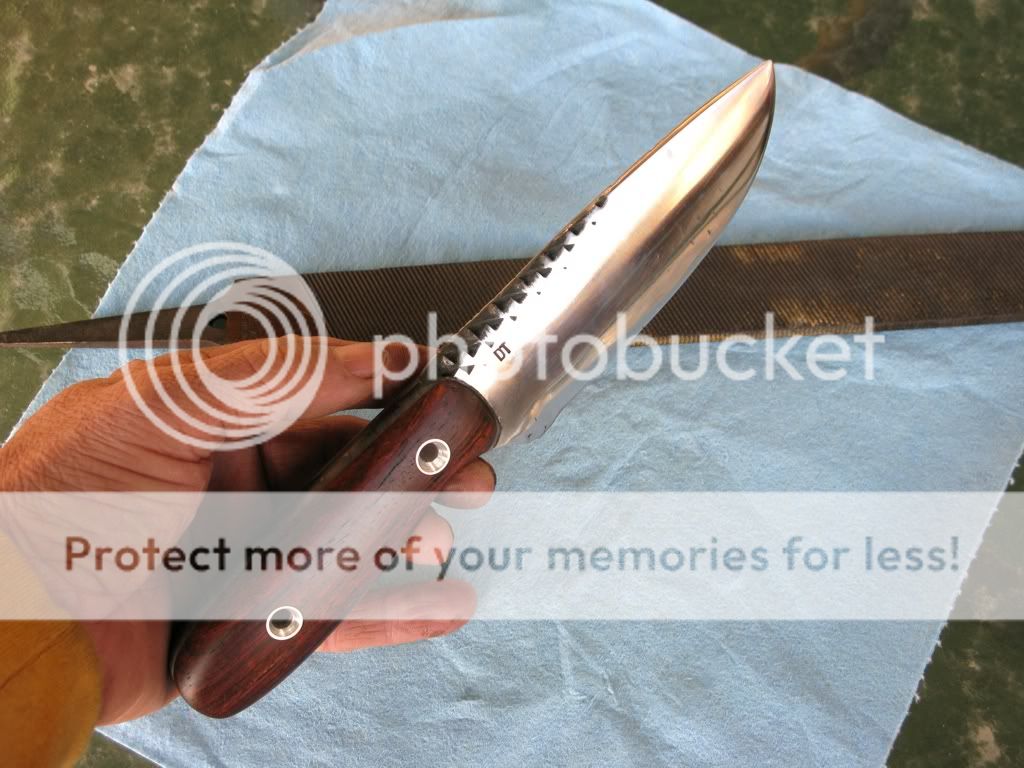

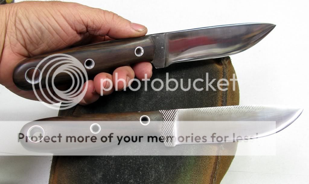

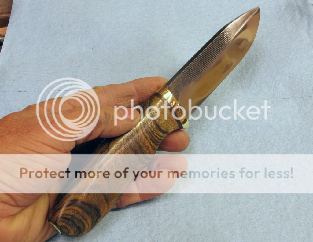

I have made a few from files...

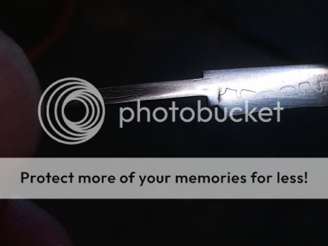

This one decided to show a crack I had previously overlooked after quench...
The crack can be seen in this photo. Yes that is my finger and thumb holding the tang...
I ended up reshaping and refinishing the handle on this one...
and for scale...

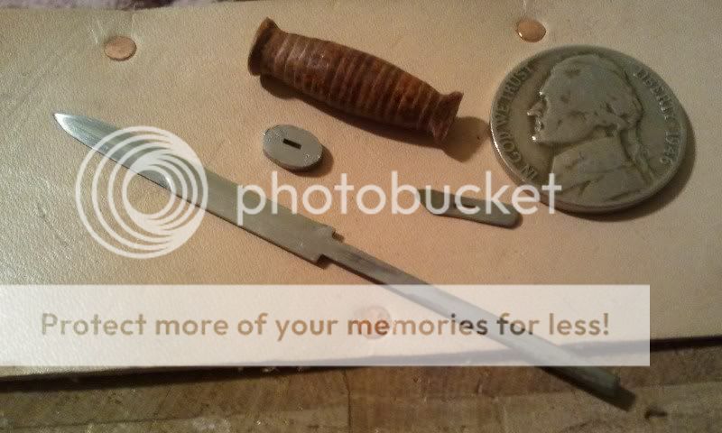

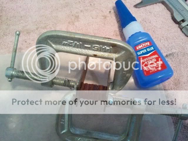

...I made this 1/5 scale replica of a USM3 for the Mini KITH last year. Not from a file, but it is 1080 hardened to Rc 57-58, .020" thick, 2.3" overall, and I believe it was 20 layers in the handle. Through tang construction for strength.
And this is the building of the handle...
Right before final assembly and blueing...
