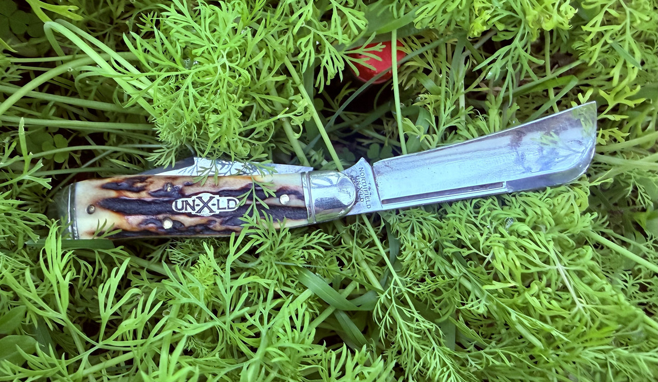

As an example of the color difference between steel and nickel silver, this knife has a steel bolster and all the pins are NS.
