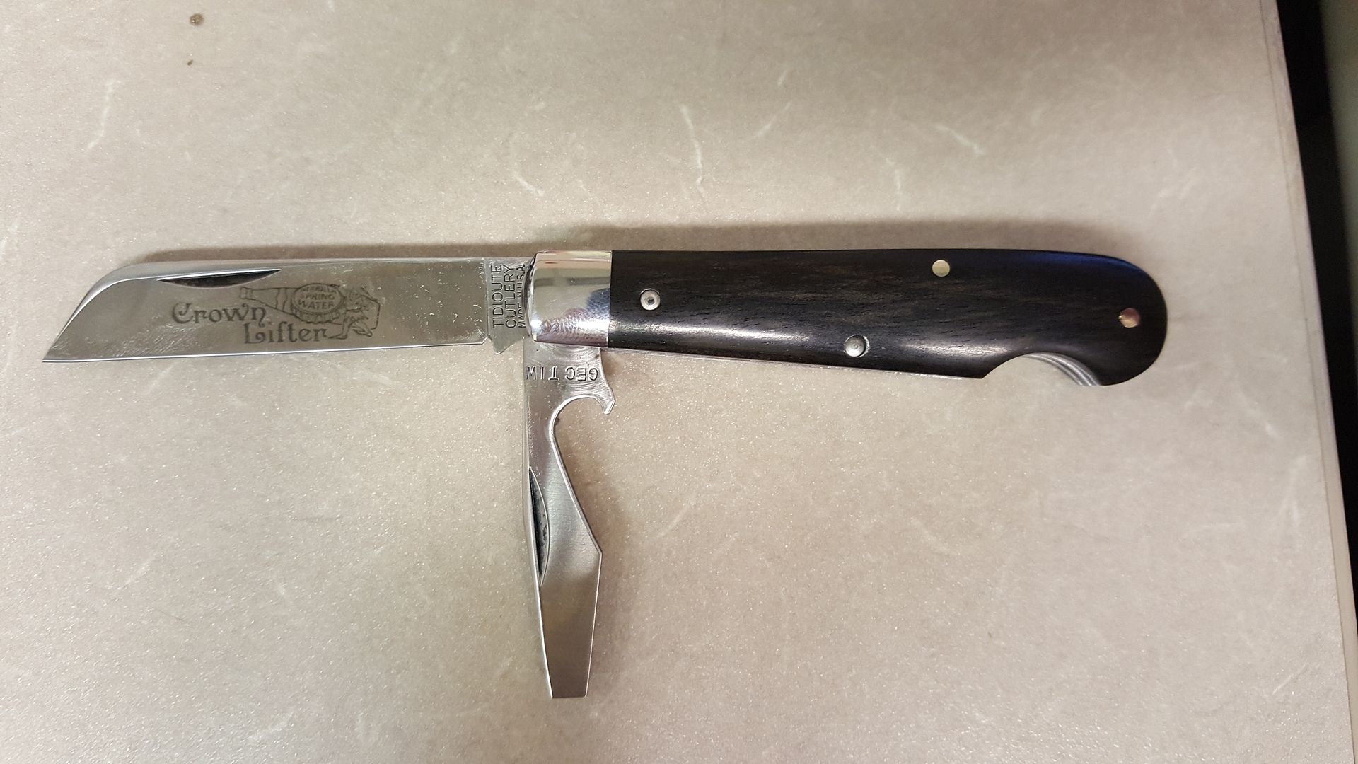

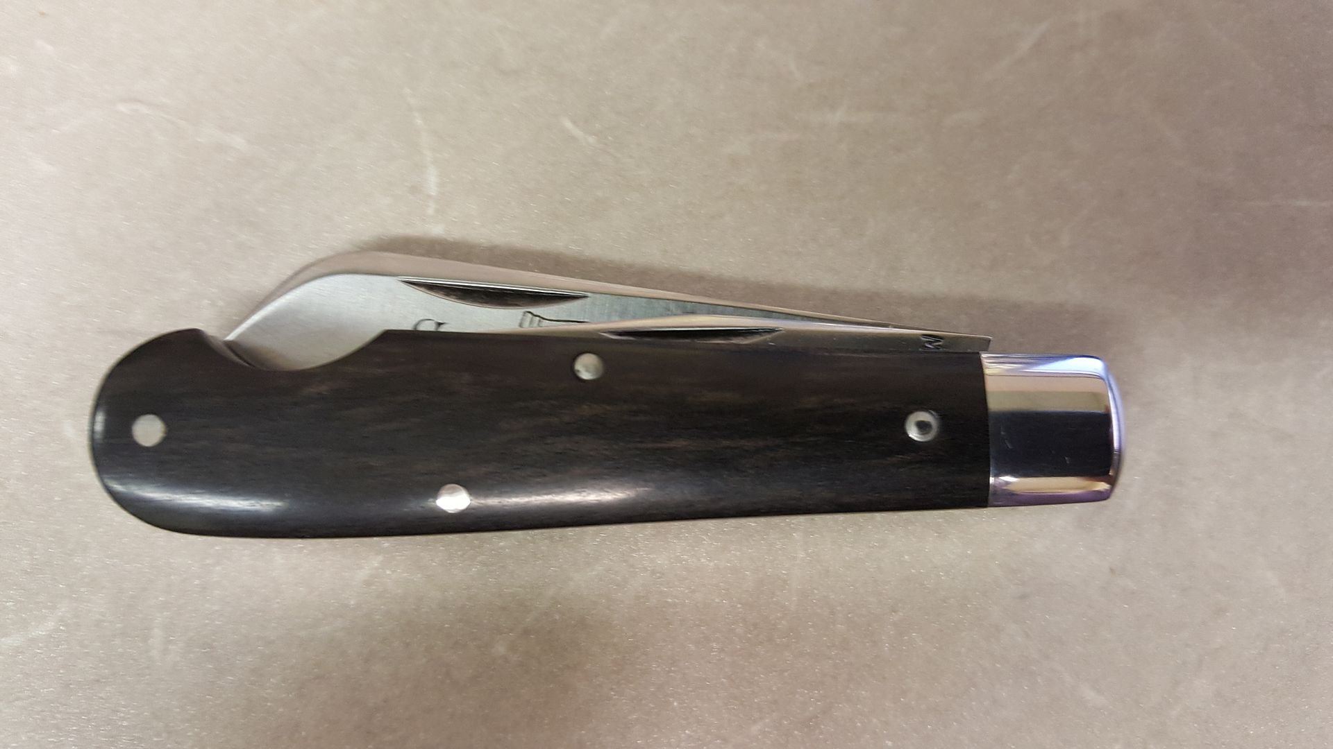

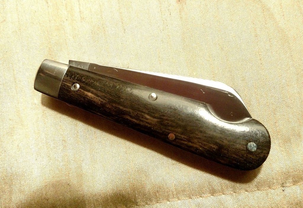

I received my ebony crown lifter yesterday. It is not the full, dark, creamy ebony of the HJ. Mine has very defined light brown streaking in the grain. I'm not complaining as it still looks great and actually like grain patterns. Both scales are matched well on my 15. I'll post some pics when possible.
Here we go. Apologies for the poor pic

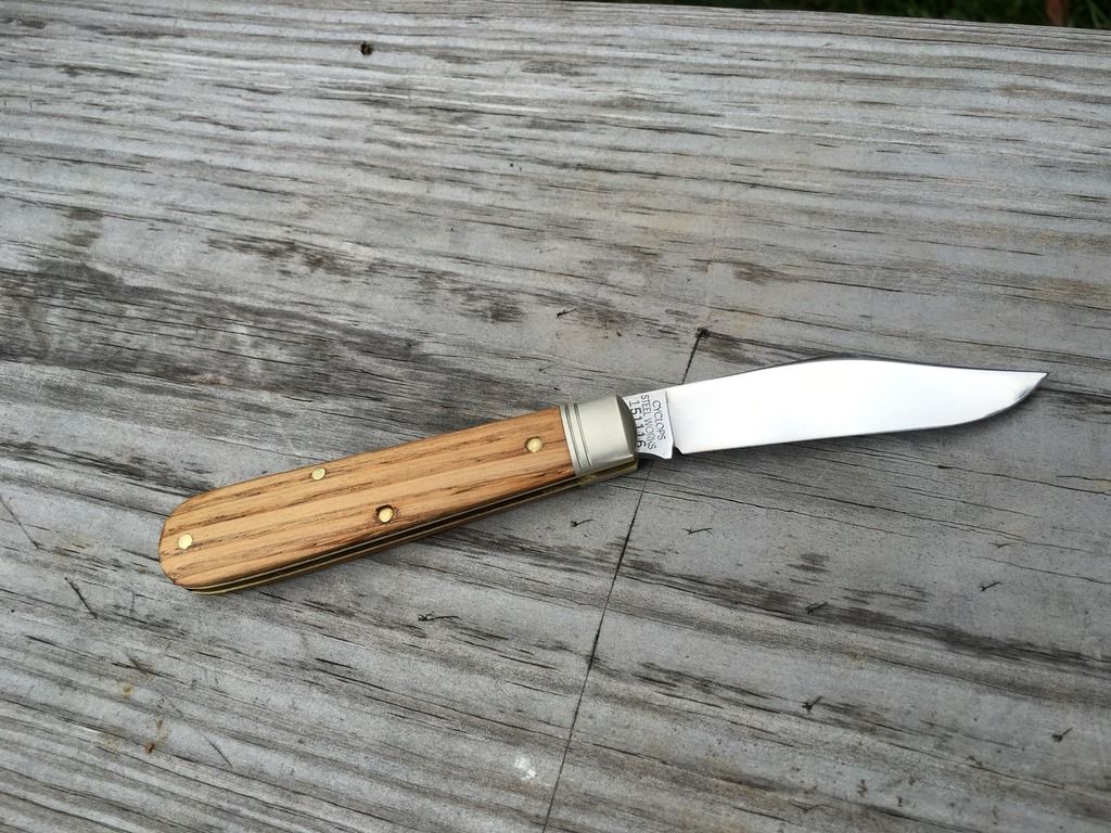

Sure, my friend suggested it. I didn't know much about wood finishes, but my friend does some wood work and suggested a 1:1:1 mixture of linseed oil/paint thinner/tung oil. I think the tung oil is important because it provides the hardness when dry.
I taped the bolsters then sanded the wood lightly with some 2000 grit sand paper. Next I simply painted the finish mixture on and let it dry for 24 hours.
Here is a picture of a knife drying after being refinished.

Thanks, that's a great help! Did it change the colour much?
No, I didn't notice any change? There is now a very thin layer of clear and hard finish. It basically just seals it up. It has added a little more of a sheen.

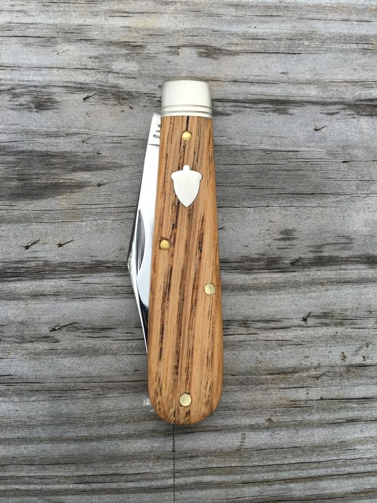

Here is a picture of my Old Barn Chestnut knife. I was really drawn to it because of the history of the chestnut tree here in America. I can still see shoots of the old chestnut trees which sprout up from the old roots of the trees that used to dominate our east coast forests.
Nice looking knives :thumbup:
