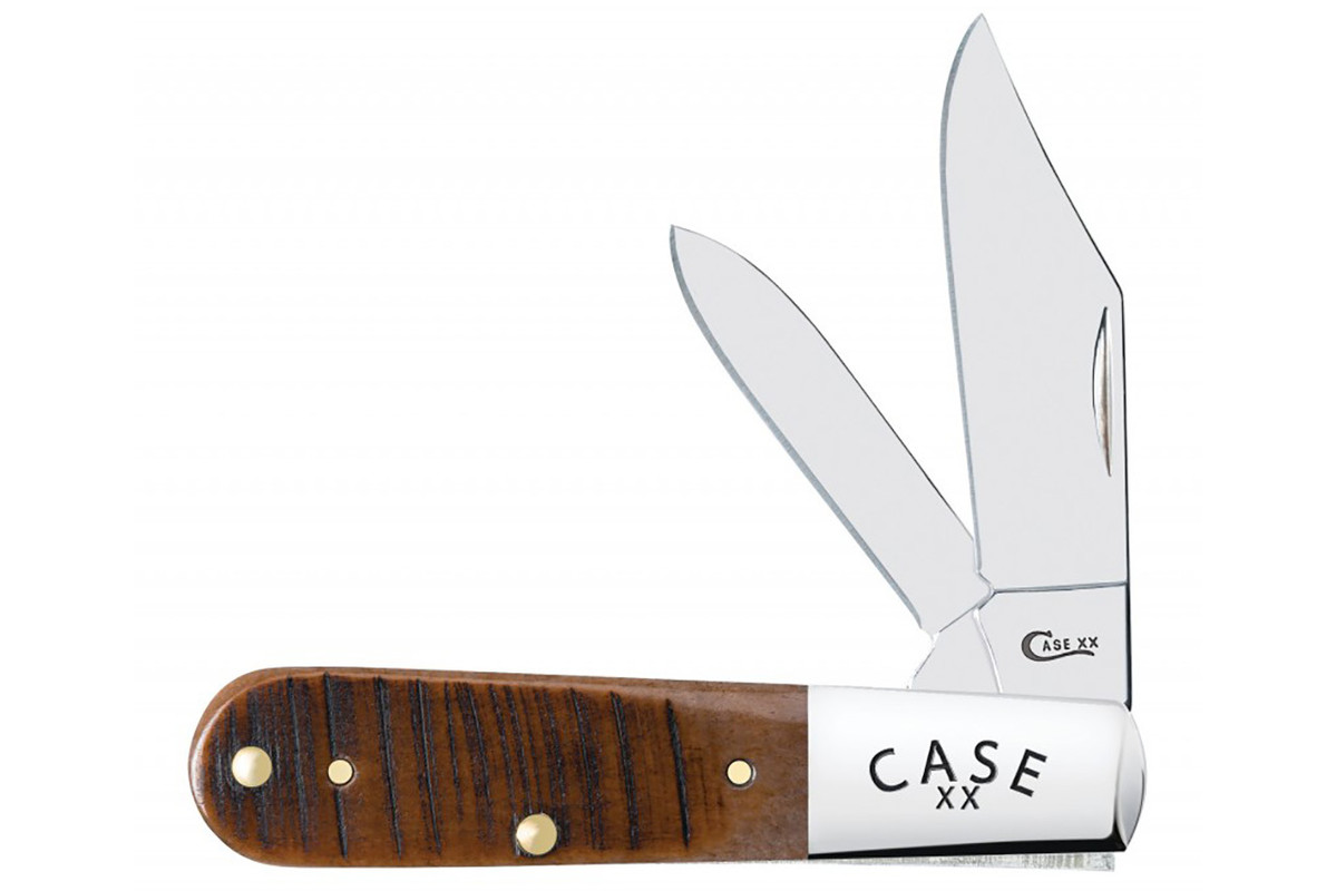

John’s point is well taken, JohnDF JohnDF , but this sow looks pretty good to me! I would be thrilled if GEC could produce jigging like you see on this current production Case sowbelly on a regular basis.
On rare occasions, GEC comes close, but they just do not seem to have the right jig. Case has problems with their dyes, but they have apparently kept their old jig patterns and machinery, or at least replicated them fairly well. Current Case knives are not as good as the old ones, but they can still create a good one every once in a while.

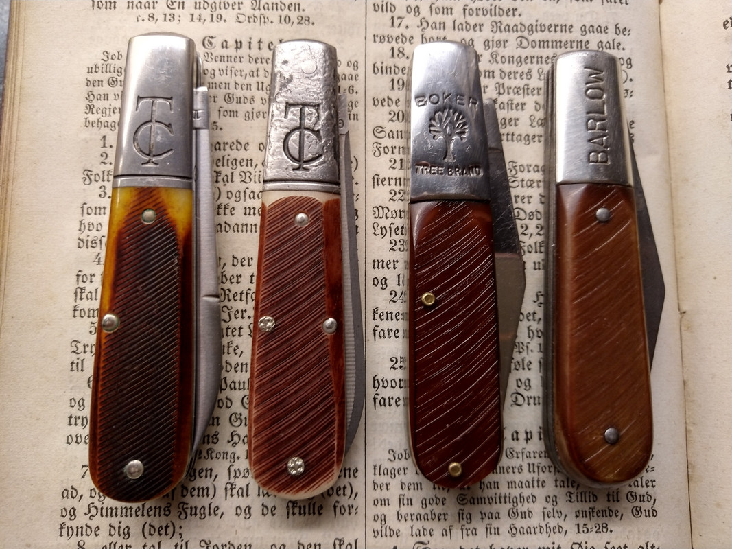

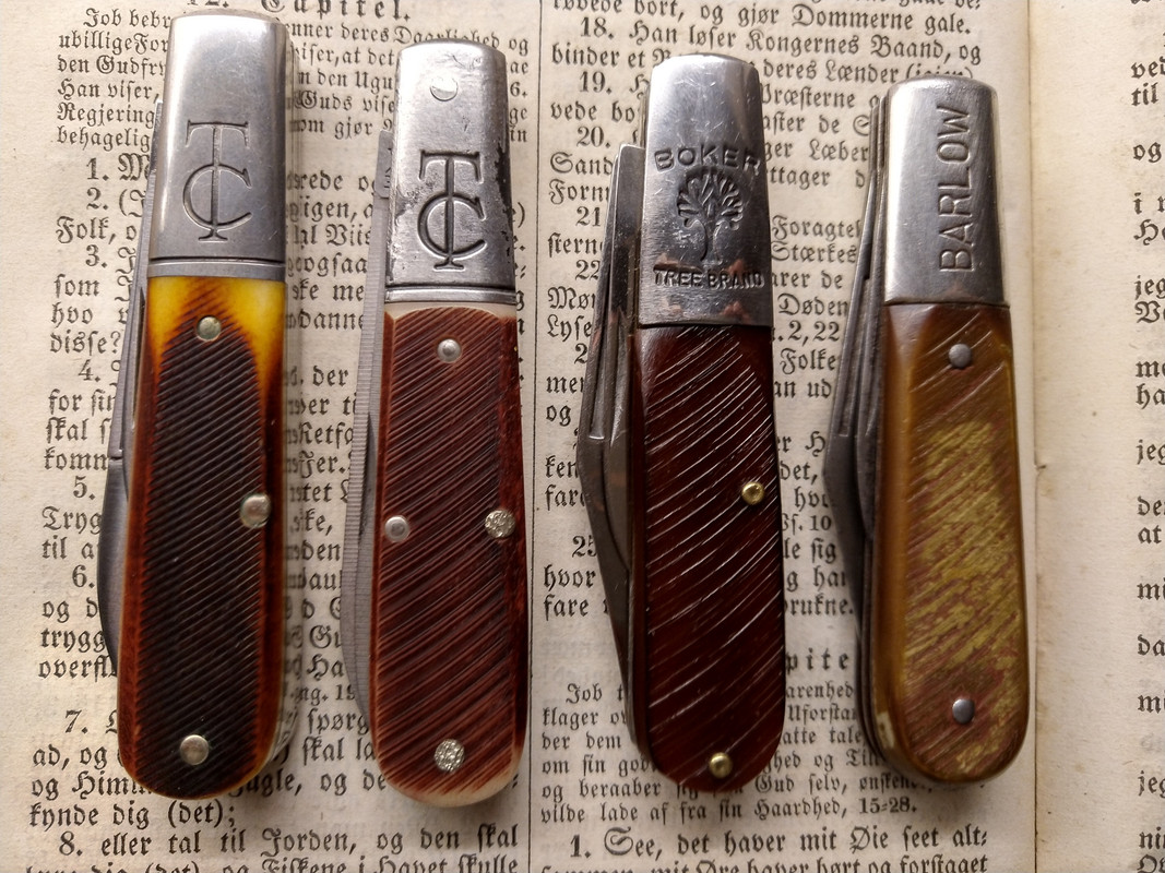

Also, not too long ago I noticed something, that may be very obvious to the more knowledgeable members of the porch, but to me it was a revelation.
I only have these four sawcut bone/delrin/crappy plastic imitation handle knives, by three different makers. But on all of them the right side of the grooves is always the upper one. It goes down the hill from right to left, if you get what I mean. (Excuse the quality of the pictures, it is pitch dark already in Scandinavia.)
Flip the knives, same thing.
I was amazed by the consistency across the makers.
The same is true for beer scout above and I am reasonably sure, that if Leslie Tomville Leslie Tomville showed us the pile side of the knife, it would not be exception to the rule.
