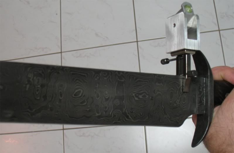

Belt sander with lee valley belts, and a machinist clamp with a bubblejig at a 20 degree angle:
[youtube]ErB5PsnuZ00[/youtube]
What did you do with the blade/handles? Strip it and grind?
I bought it from a forum member who already had it "banned", stripped and cleaned up. When I got her she wouldn't cleanly slice newsprint though, so I gave her a touchup with the 20 micron belt then the leather belt w/compound.
I just like hosing off my users then spraying with WD-40, so I filled in the handle pins with a little epoxy to make the job easier.
I hate digging gunk out of hollow rivets.

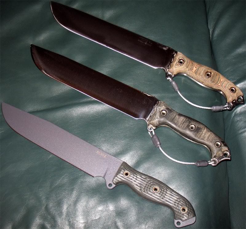

She sure tears through logs. Here she is beside a LE and a BWM:
