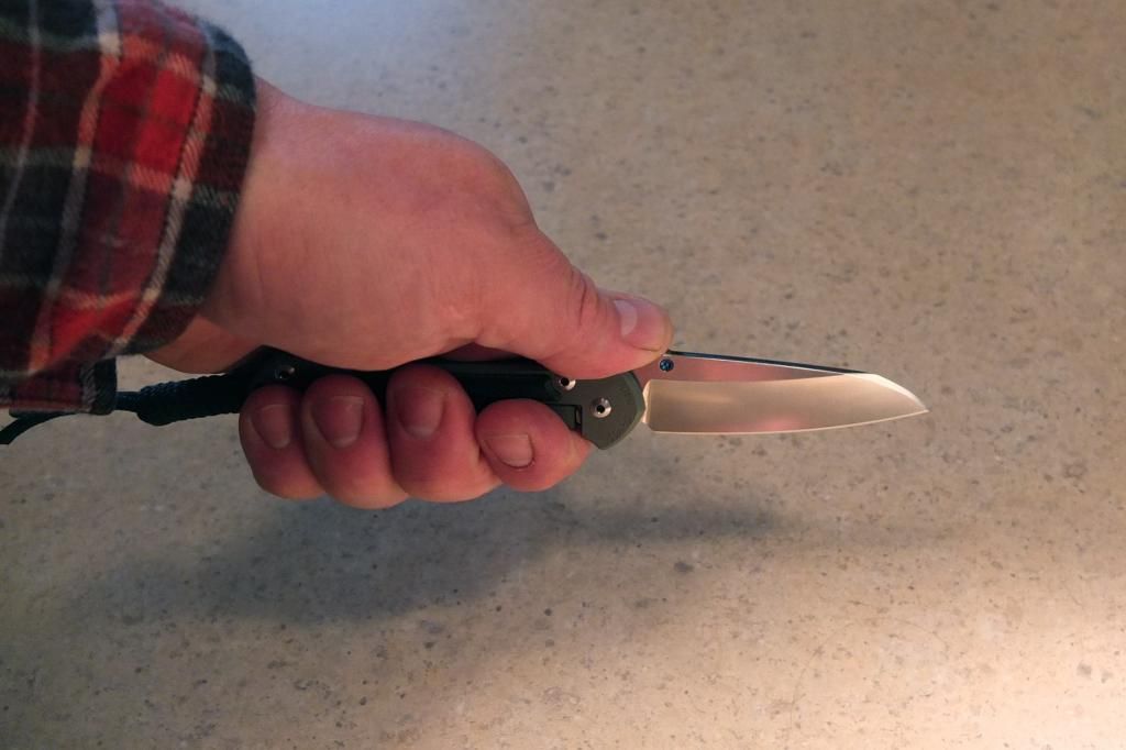

Observation #1: The droopy blade!

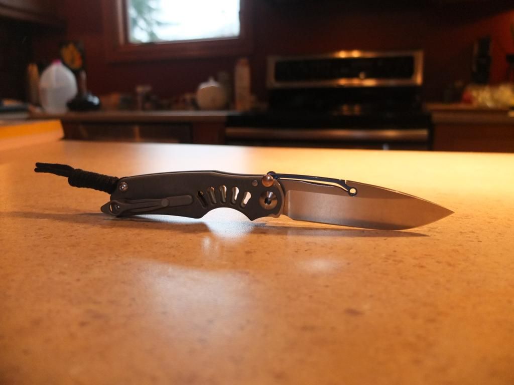

I will start with an observation I have not seen mentioned before. It involves the overall shape of the knife, and the relationship between the handle and the angle of the blade. Much like the Spyderco Gayle Bradley, the Ti-Lock has a blade the droops down from the handle, which engages the material being cut "sooner" than a standard CRK blade. Why this is sometimes an advantage is best explained by Gayle himself: https://www.youtube.com/watch?v=Qk0IxU-fuW4. I am not saying that these knives have much in common otherwise, but that feature they share.

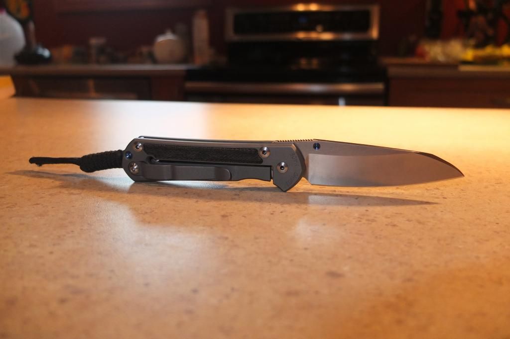

Note how the handle and the belly touch the countertop on the Ti-Lock:
Notice the same curve on the Gayle Bradley:

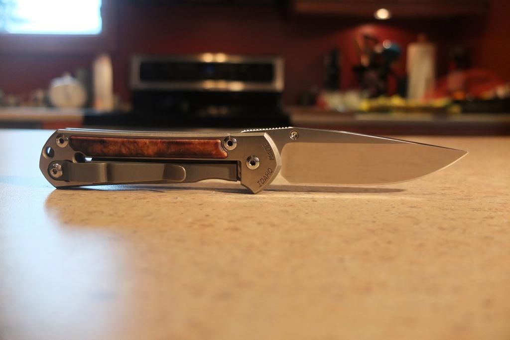

Note the Small 21 is parallel to the counter:

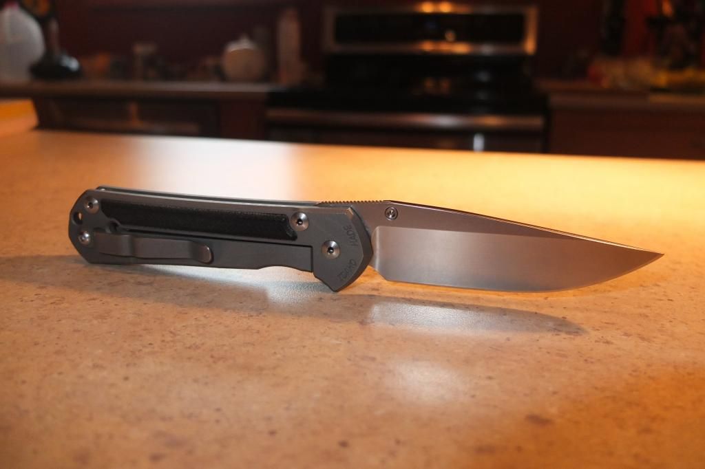

As is the large 21:
The small insingo curves upwards:

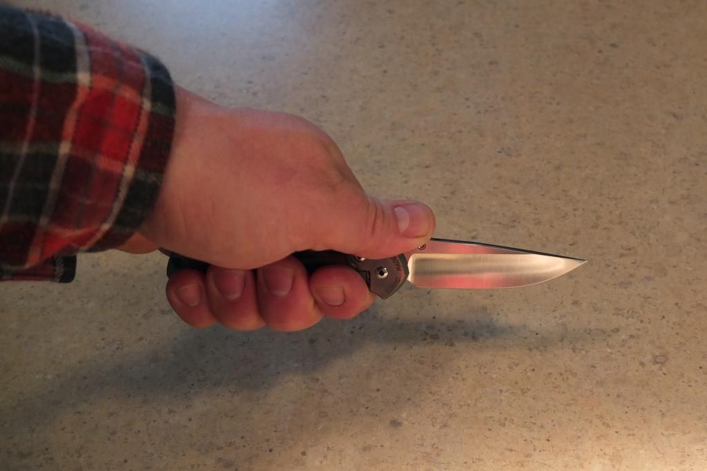

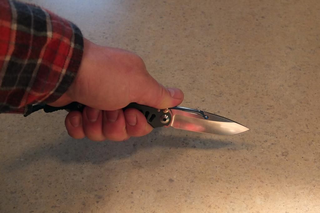

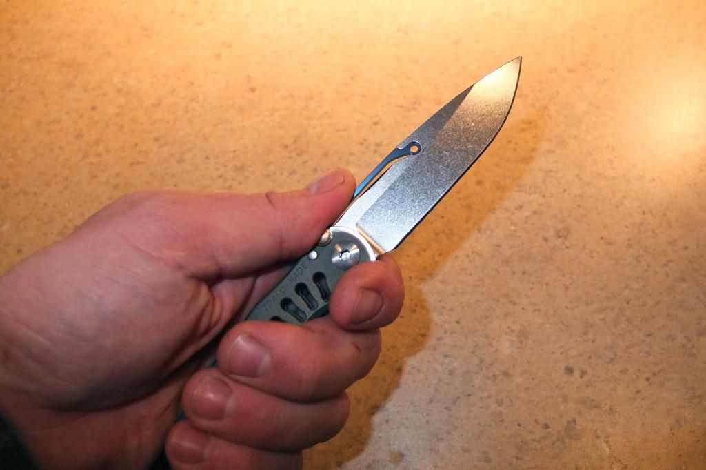

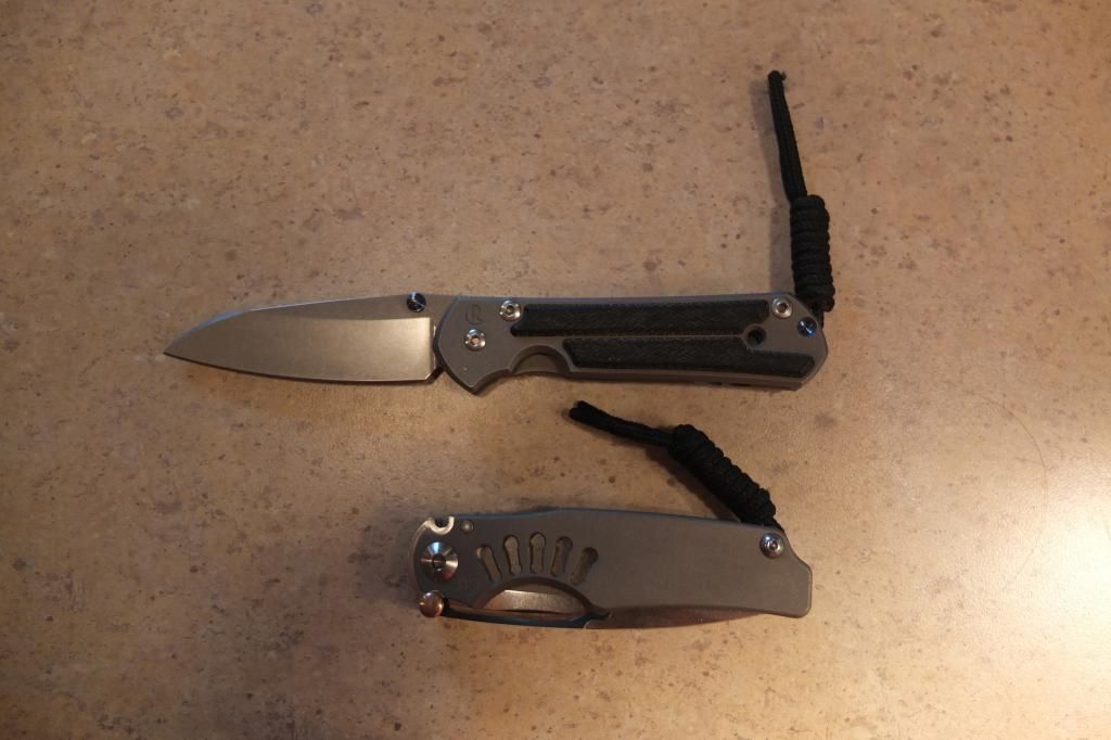

Some might argue this is just a function of the design and shape of the finger-guards on the Sebenzas. To demonstrate that there is truly a droop to the Ti-Lock blade I held each knife with my hand and knuckles parallel to the countertop. This is not a scientific demonstration, but I did my best to hold each knife firmly with my hand straight.
Note how the Ti-Lock blade drops toward the counter with my hand flat (knuckles parallel to counter). This effect is even more pronounced due to how your index finger sits in the main choil:
Similar angle on the Gayle Bradley with the blade dropping down from the hand:
With my knuckles parallel the 21s are basically parallel to the counter:
The Insingo sweeps upwards slightly:

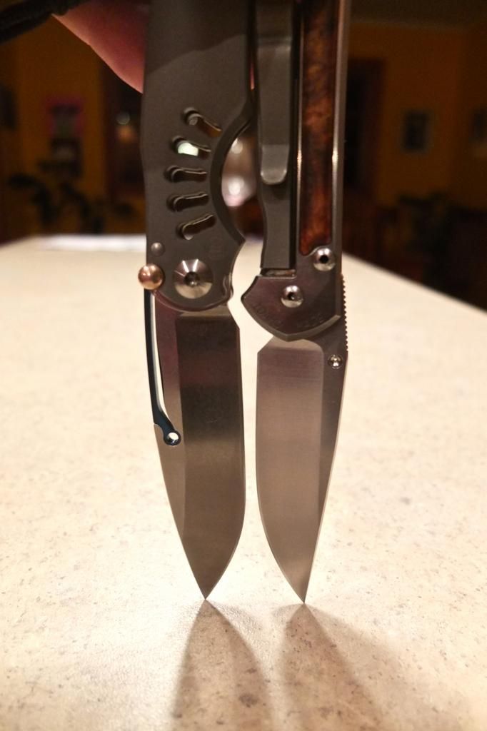

Observation #2: Blade to handle ratio is awesome!

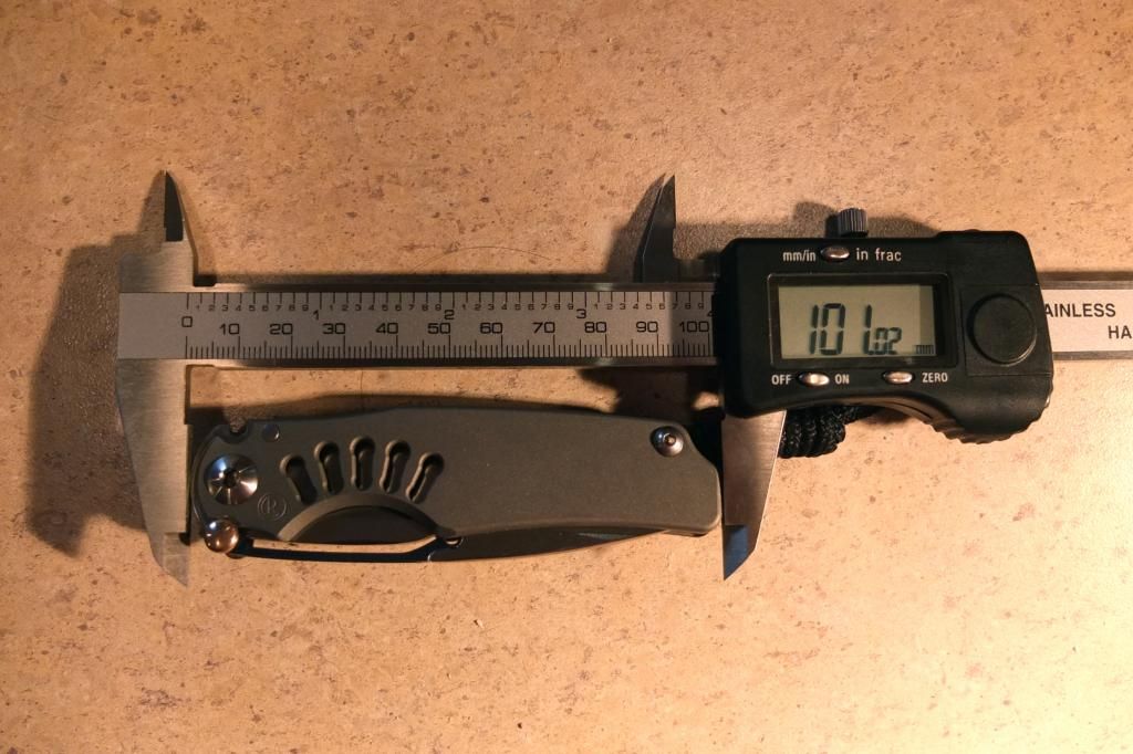

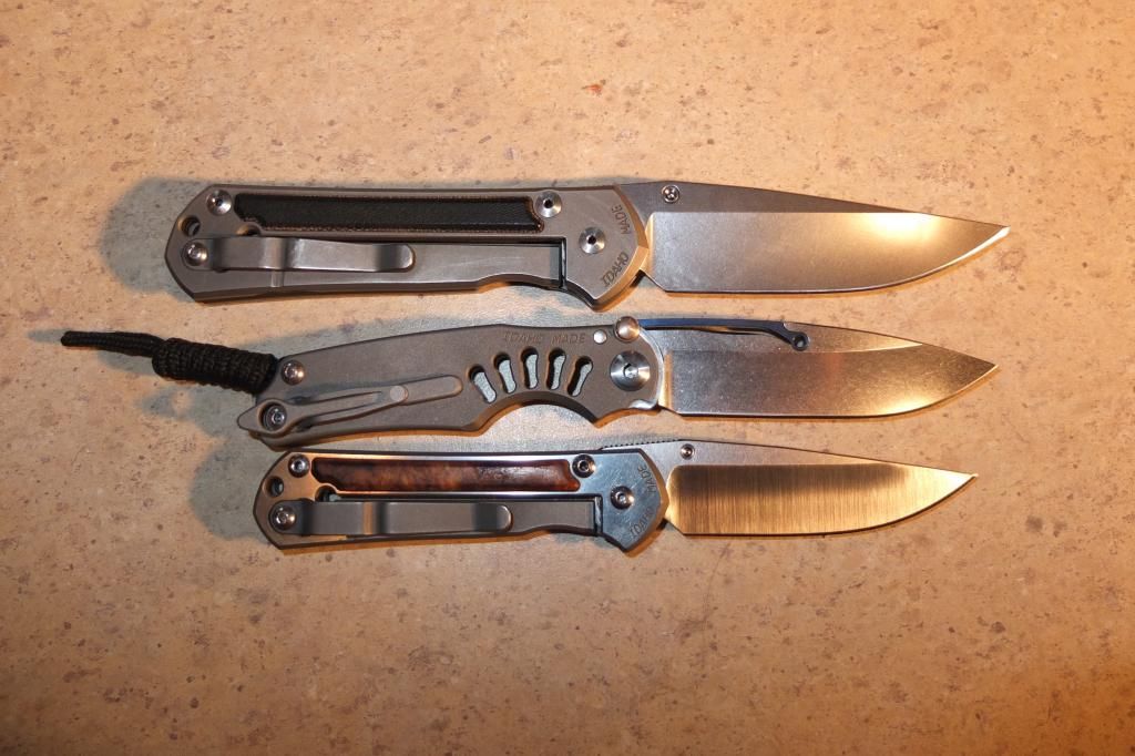

Next up is an observation made many times over, but worth pointing out again. The blade to handle ratio is great on the Ti-Lock. Firstly I will prove to you that the Ti-Lock and Small 21 have the same size handles. I always thought is was a little bigger than a small 21, but it is not. My measurements are not very accurate, but my calipers show the Ti-Lock to be slightly shorter in length when compared to the small 21 (both closed of course). Yeah, it's metric!
Yet for a handle that is either exactly the same, or slightly smaller that a Small 21, you get a significant amount of extra blade with the Ti-Lock. Not a lot, but where it counts:

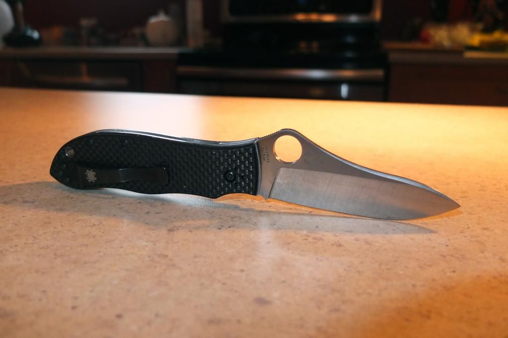

CRK gets this great ratio by doing things a little differently than say Spyderco. With a Spydey, you usually sacrifice some of your blade to create room for the choil. CRK put the majority of the coil in the handle and pushed the blade pivot as far forward as possible. Note the different in pivot position between the Ti-Lock and the Sebenza with relation to where the slab ends and the blade begins.

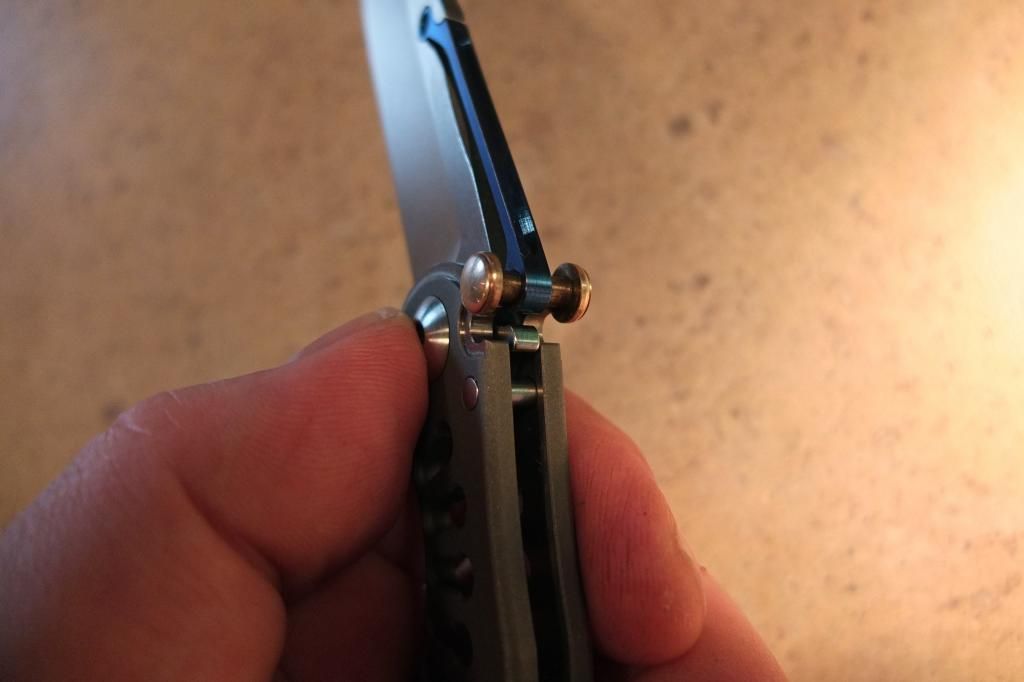

Observation #3: The Lock
Ok, I don't know why this lock is ever considered "light duty". I am not going to break my knife to find out what it's failure point is, but I will offer some info that might help others gain confidence in the design.
Firstly, greatest strength in a folder is required with bearing down on the knife. In the case of a Sebenza, the blade presses against a stop pin. In the case of the Ti-Lock, it presses against two stop pins. The Titanium spring and brass "dumbbell" are not the only thing stopping the knife at the end of the opening cycle. At the very same time the "dumbbell" falls into the slot, the blade contacts a stop pin that is pressed into one of the slabs. This is a really neat feature and makes a great, wonderful sound. You would need to break both the stop pin and the dumbbell to cause this knife to fail when pressing down. These photos show the sequence:
Note the squarish block on the heal of the blade hitting the stop pin:
As far as strength to prevent the knife from closing when pulling it out of material, I don't see the possibility that the lock would fail. You usually would have your hand or finger covering the end of the lock, which keeps the brass dumbbell in its place, and the angle is all wrong for it to release. I feel this lock system is just as likely or unlikely to release as a frame-lock, back-lock, or liner lock, and those locks can be accidentally shifted by your hand. In general, I have no worries about the strength of this lock if using this knife for EDC tasks.

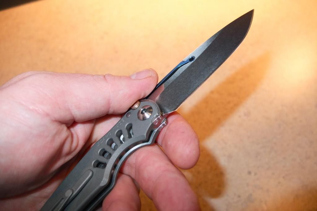

Observation #4: Operation

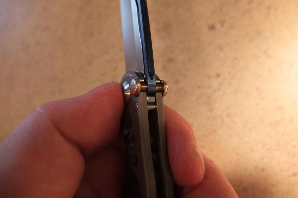

I have had no issue opening or closing this knife, and contrary to Solo's youtube review, I find it fun to play with. The two places the spring loads up give the knife a double-detent feel like a good quality traditional folder. It's cool. I know some struggle with the system, but maybe it is because I am a tradesman and have relatively strong hands. I do not use the nail nick (though it works fine enough), I press on the dumbbell with my thumb to open and lift the dumbbell with my thumb, while pressing with my index finger to close. The dumbbell is machined with a sharp groove or ridge to catch your thumb, so there is no issue with grip

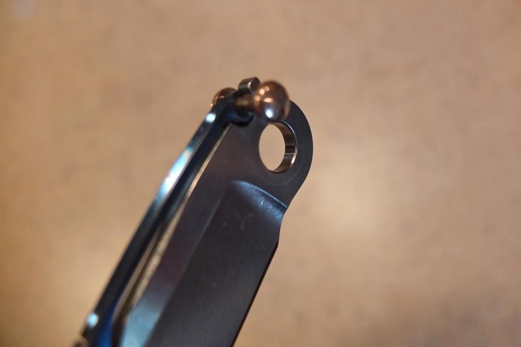

You can see the ridge on the dumbbell in this photo. (BTW look at how beautiful this end of the knife is):

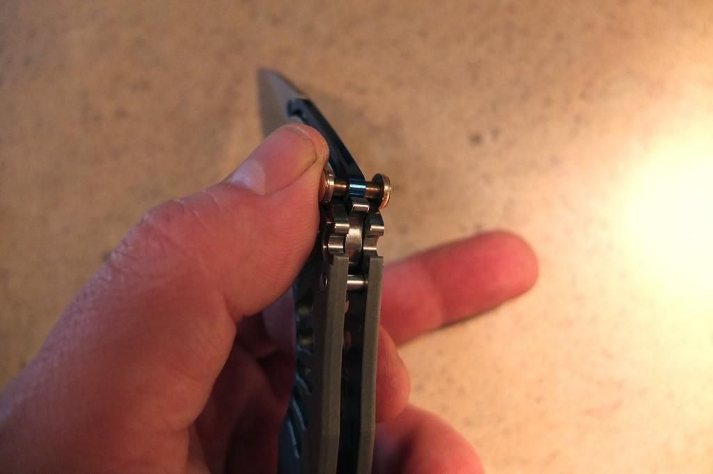

Observation #6: Internals
My Ti-Lock is early run and has a bead-blast outer slab and a brushed inner slab. The Ti-lock was clearly not intended for disassembly. The fit and finish on the inside of my Ti-Lock is not 'Sebenza level'. It is perfect where is counts, in the pivot hole etc, but the inside of the slabs are not beautiful and I doubt they wanted you to look at them. The newer models may have corrected this. Anyways, this knife is difficult to take apart and put back together, so I do not recommend it unless you really want to.

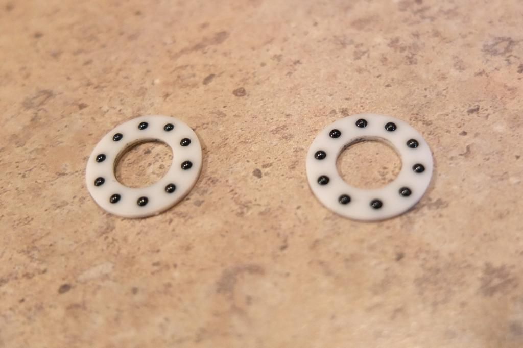

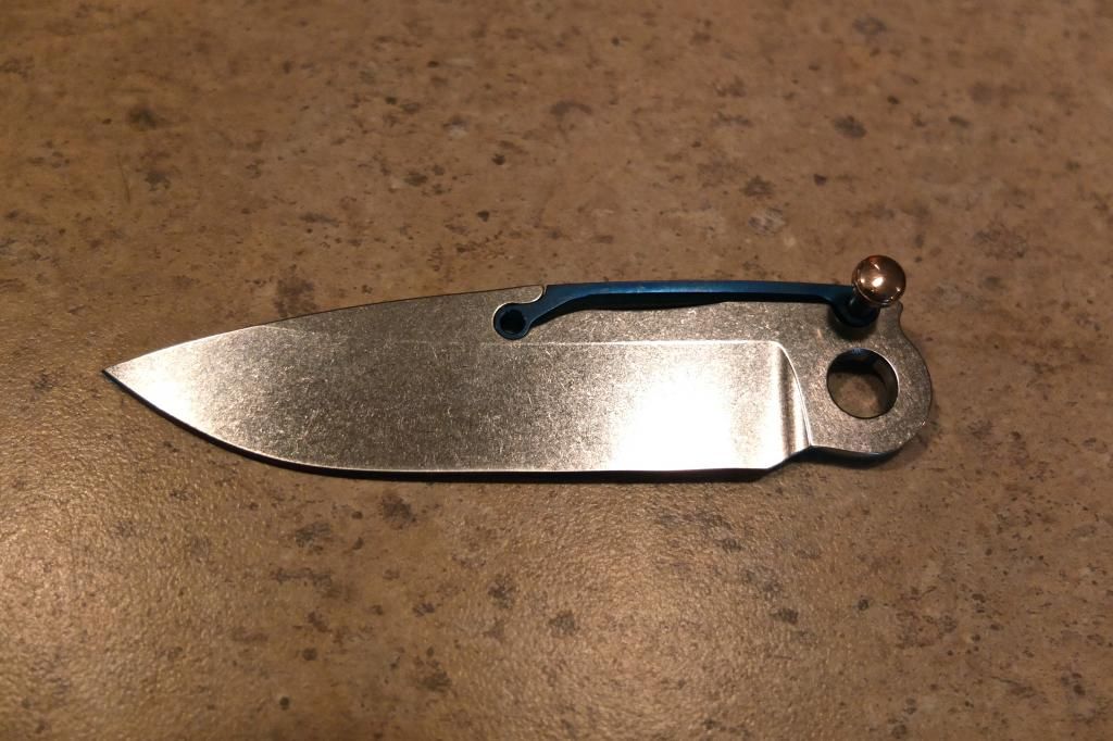

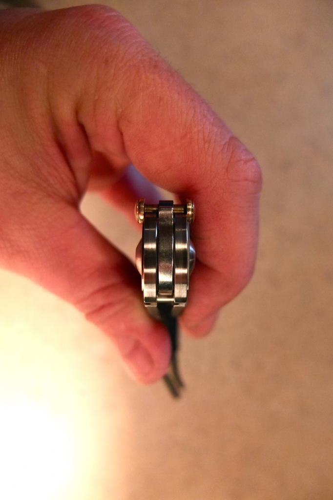

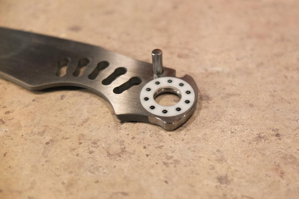

Inside the knife are two Teflon washers fitted with a full compliment of ceramic ball bearings that look like this:
These fit perfectly flush, in cut-outs in the slabs, like this
And the pivot hole has the classic CRK 'grease grooves' of course:

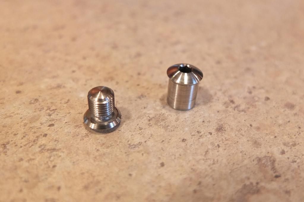

And the pivot screw is similar to the 25 and new Umnumzaan:

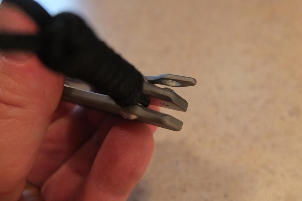

On this knife, the lanyard will fold right back into your pocket, much easier than the 21, due to its position on the single stand-off:
It also has the milled-out 'lanyard pocket', like the Sebenza 25:

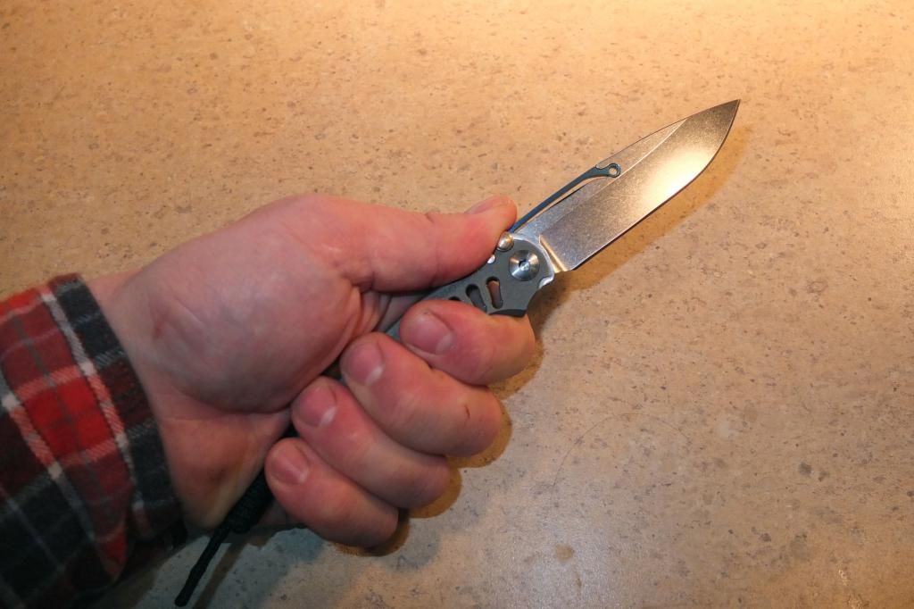

I think ths picture says it all. With the blade-to-handle ratio what it is, it magically transforms from a knife the same size as a small 21, into a 'medium' CRK. Obviously a very different knife, but cool to see where it fits size-wize:

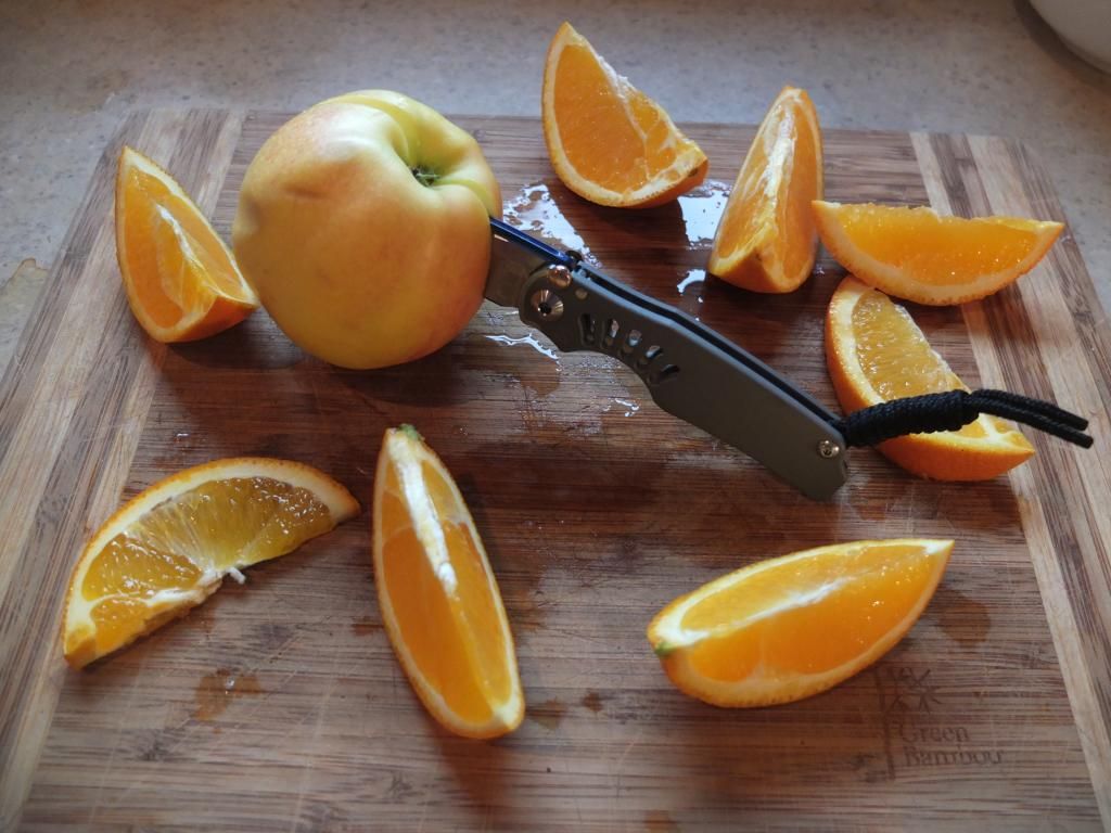

Observation #10: Food Prep
Obviously not ideal, but I don't find the lock mechanism traps that much junk. Quick rinse under the tap and you are good.

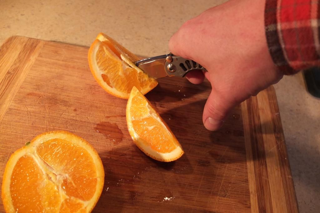

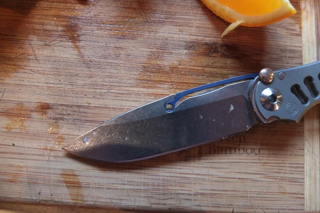

Cutting oranges (while holding a camera)

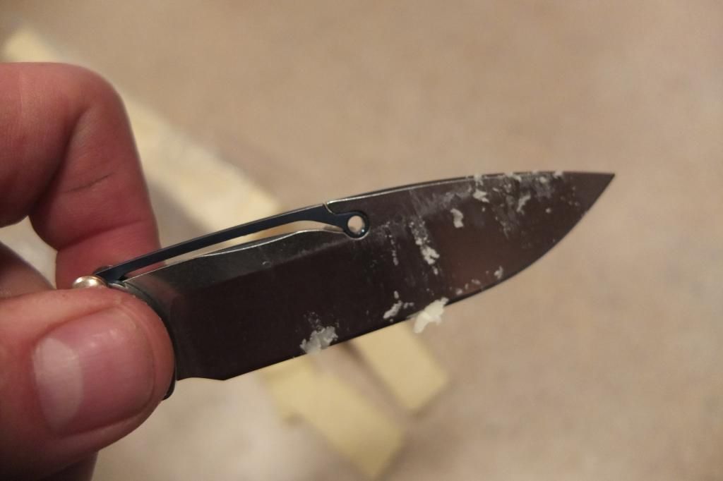

Results in this:

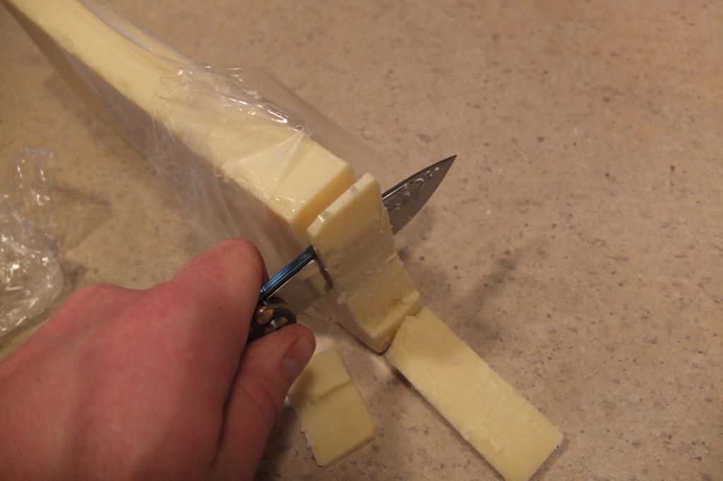

If you cut cheese the smart way:
If you cut cheese the dumb way:
