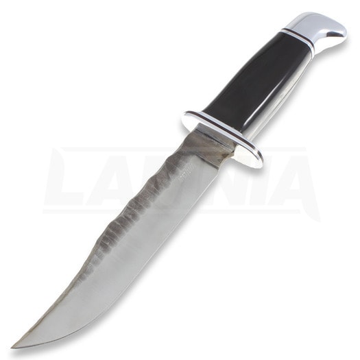

The chip flint seems nice, but more than 2x the price for a different blade finish?! I would go for the cocobolo if I were you. At least you are getting a nice wood handle and brass hardware out of the deal. From what I can tell, the chip flint is just a woodsman (phenolic/aluminum handle, 420HC blade) with a finish that imitates a worn carbon steel blade, while still being stainless. Doesn't seem worth 2x the price to imitate something you can get for cheaper...

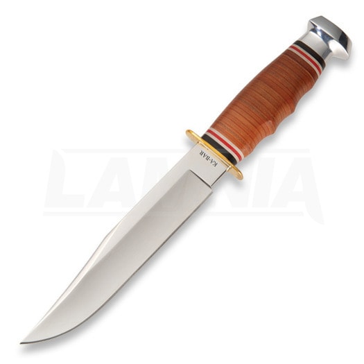

How about this one: Ka-bar leather handle Bowie. Any opinions? Price is much lover than Buck.

I have an old chrome ka-bar marine hunter. It's thinner than a buck special and I think cuts better for that reason (though I love my Bucks too). They still make one in stainless.
The one you're looking at is a USA-made Ka-bar, how bad can it be? They're handsome knives, and I like the long handles with shallow finger grooves: they orient you without dictating your grip.

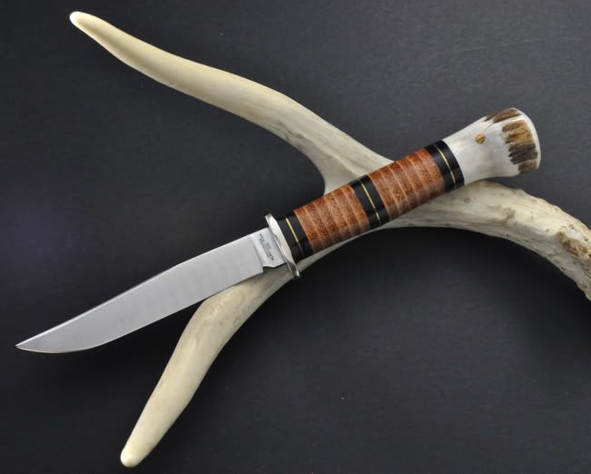

If "slim and light" is the goal, you might gravitate more towards "bird and trout" patterns than bowies. Here's one from Northwoods:
I think you gotta check out the Lite Hunters from Queen. The "Aged Honey Amber Stag Bone" is absolutely stunning. Most models are D2 steel, but the smallest Trout knife is Queen stainless. This one is the Bear Head (not my photo):

The KaBar blade alloy is similar to what Buck uses, but Buck runs their blades a couple of points higher. Also, Buck knives made after 2000 have an ultra hollow grind to them. The Buck will likely cut better. And I think you would also notice the extra hardness points.

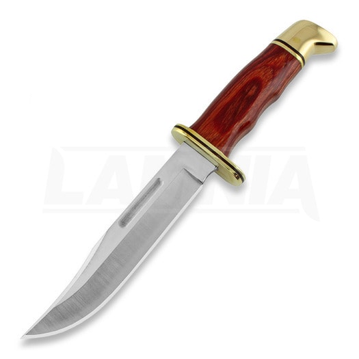

Allright, it seems my choise will be Buck Special (119) with the Cocobolo handle. I have handled some Buck fixed blades and they felt light considering the size. Is this also the impression of others?
IT SEEMS TO ME, a 6" knife like the buck 119 Special is not really a "Bowie" knife yet. Mine is from about 1967 if memory serves and it is just a bit short to be a "Bowie" IMNHO. The BUCK Bowies start at the 120 GENERAL and the 124 FRONTIERSMAN it surely does seem to me and the 120 in particular is light and sleek as can be with a really superbly shaped clip blade. The 124 is noticably heavier and it's handle is just a tiny bit too square in my hands, but still, one fine long blade knife that gets it's job done in fine style. ALL of 'em are great American made knives.
