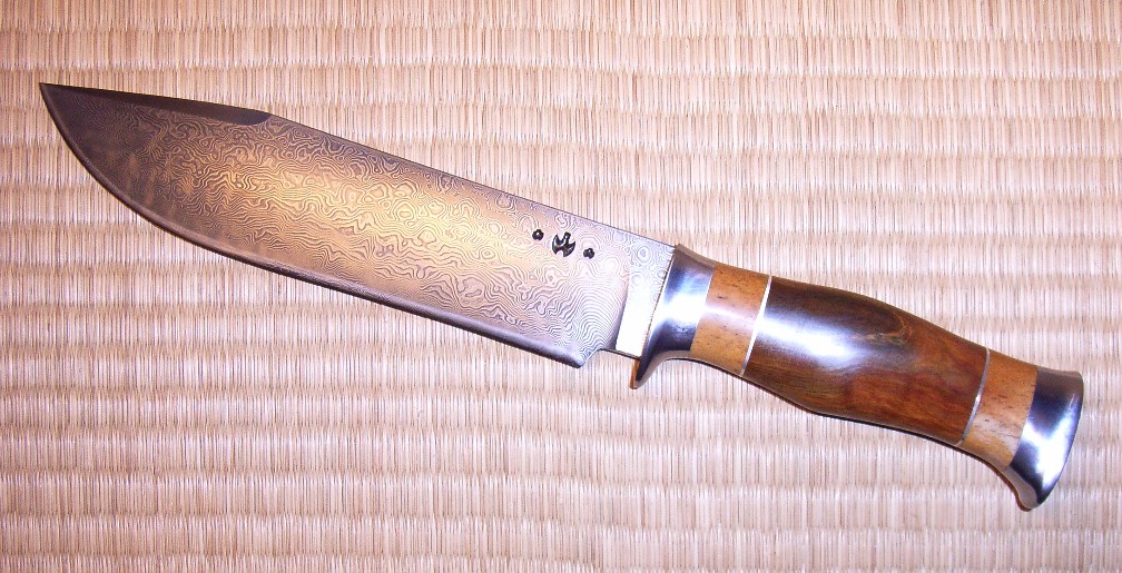

"Bambi Skinner" made by Achim Wirtz. Handle of lignum vitae and steller sea cow bone. Silver spacers.
(not my knife - pic borrowed from maker)

The wood on the Wirtz piece does not look like any lignum vitae I've even seen.
STR's example looks much more typical of the grain and color.

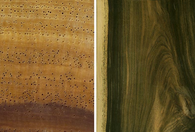

Lignum Vitae has a very wide variation in colour and grain. The goblets below are made from it and are of the colour I prefer over the green shades that I have seen.
Keith, the grain looks right, but not the color. Those pieces may have been stained or treated somehow.

Of course there are natural color variations, but most tend to show some greenish color which is the most "typical" of the species...
So far, I've never come across any really dark brown L.V., but if I saw any I'd snag it right away.

I've worked with quite a few color variations, from tan, to light brown, to dark bluish green, and they've all had a greenish “tint” to the surface. I suspect that even the darkest pieces would show that to some degree. It's one of the ways to identify it. It may be hard to tell from the pics though. Like most things you need to see it in person in natural light. I've never seen one as dark brown as that middle example I posted IRL, but there may be some out there, maybe even some black ones... just very rare. Patina and aging also have a lot to do with it too, I'm sure.
Once you've worked it, you'll recognize the sweet smell.
If you looked over the ironwood article, lignum vitae should also sink in water.
I probably wouldn't have had this much to say about it, but I do think there is some confusion caused by the different uses of the term or name lignum vitae,... like the term ironwood.
