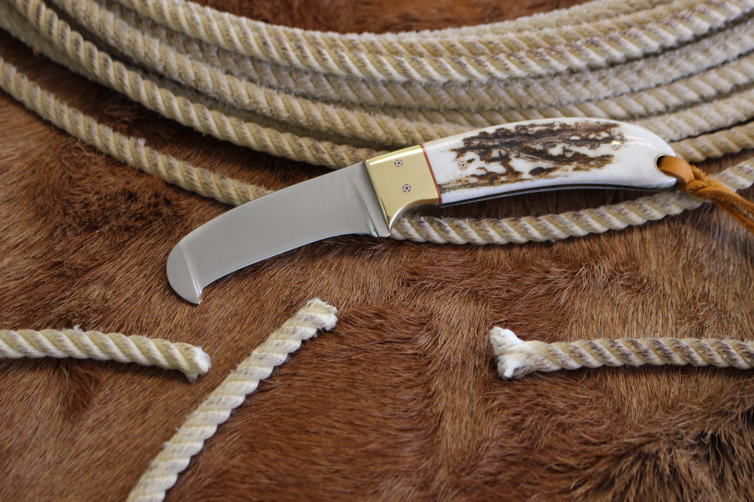

Remarkably similar in design to this one I build called the Packer's Safety knife. A packer in the western world is the guy that leads pack mules or horses around. It was actually designed by a junior rodeo judge that wanted something that he could jump into the middle of a wreck and cut free a hung up kid without stabbing the kid or horse etc. Figured I might have a bigger market with mule draggers (more of them then junior rodeo judges), so I changed the name. AEB-L, .130 stock, convex ground with just the hint of a microbevel. Will slip through rope like ya can't believe. Anyhoo very similar design.
