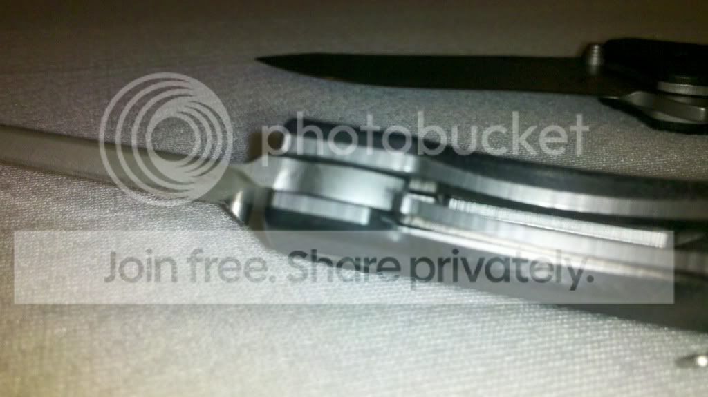

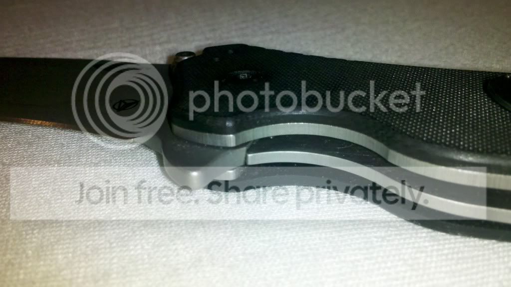

The linerlock makes contact with the tang of the blade that is angled to account for wear as it locks towards the direction of the non-locking scale. Downwards impact to the to the spine of the blade can cause the linerlock to slip back towards the bias of the angle of the tang, closing it. However, if a knife is used properly, I don't see a scenario like that happening. That's like testing to see if the edge rolls or chips while whacking it on concrete. It will happen if done on purpose.
Military:
Speedform II:
ZT0350:

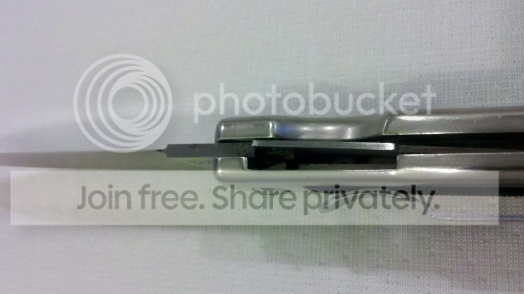

Some linerlocks will not have the angled tang that compensates for wear, or will have been worn down enough, creating a flat contact surface. This will allow the linerlock to fully extend to the non-locking scale, effectively locking it to that side. When a knife has lockup like that, it will survive spinewhacks no problem, providing the rest of the knife holds.
Kershaw 2420:
The caveat is, when the linerlock reaches that point, additional wear to the tang or linerlock contact surface will eventually result in blade play, hence the angled tang to maintain tight lockup as the contact surface wears with use.
