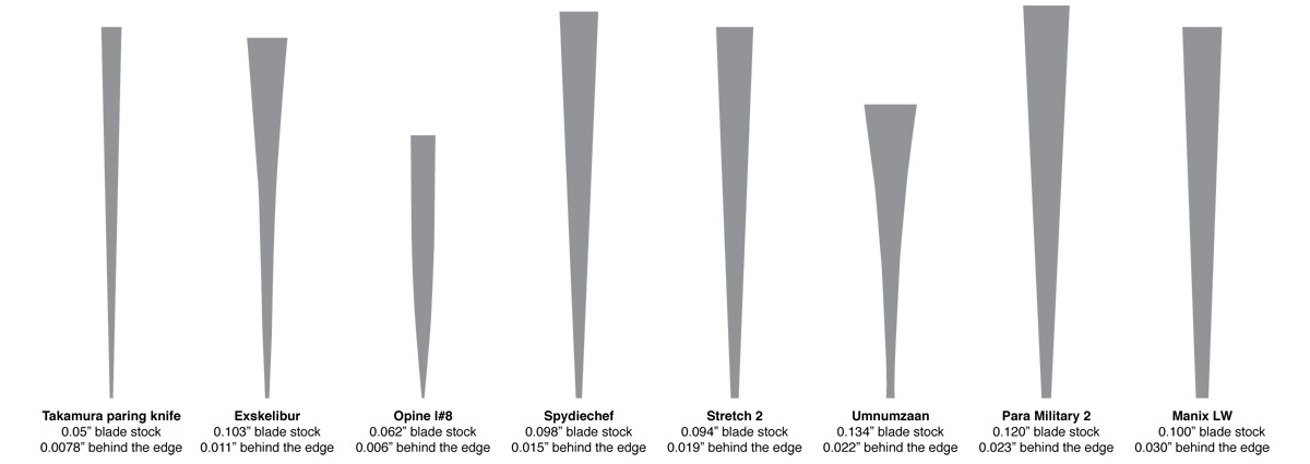

I previously requested info regarding edge thickness of knives listed in the 1st page. What I would like to do is to make rough models of the blades, which may be useful to judge whether a knife is a slicer or not.
Below is the blade shape models of few knives I own, from thinnest to thickest. They are based on my measurements.
For FFG blades, perfectly flat ground shapes were assumed, and straight lines were drawn to leave the thickness behind the edge.
For hollow ground blades (and convex), I made measurements at different points on a blade and adjusted the curves to the measured thicknesses. I did not make the curves semicircular, which would be assumed from the use of a wheel grinder for hollow grind. So the curves may not accurately reflect the shapes of the hollow ground blades.
The blade stock thickness of each knife indicates the thickness where the blade width is around 1" (with the exception of Opinel), but not at the thickest part.
