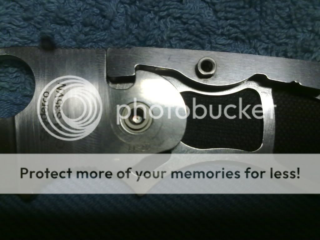

Here are examples from STR about lockbacks being made in different ways:
While working on yet another lockback upgrade for a forum member it occurred to me to post a comparison of two lock backs that are both considered to be very high quality well made folders. Both of these work and work well and there is technically nothing wrong with either one. Both pass spine tap tests. Key word there is taps. I have my doubts about the one passing a whack though.
The next time someone asks you what makes Spyderco so great, think of this thread, this picture, and remember that from the perspective of STR, that has seen the insides of thousands of folders in his life that this is coming from a pretty good source if I do say so myself. The fact is I don't just support Spyderco because of their pretty knives or their fancy blade steel. I know what I'm getting because I've seen it inside and out.
I will not mention the names of either of these knives. If you know please keep it to yourself as this isn't a thread to beat anyones products down. One is obviously a Spyderco, one is not that is all that need be known for the purpose of this thread. But both are sold for a similar price tag and both are lock backs. I'll give you a little help. The top one is the Spyderco.
Note the difference in lock up. Not just the size of the lock but how much of it is connecting to the blade and how deep it seats into the blade. In knife making a couple thousandths is big but a mm is huge. Which would you rather trust your fingers to? Its an open and shut case in my mind.

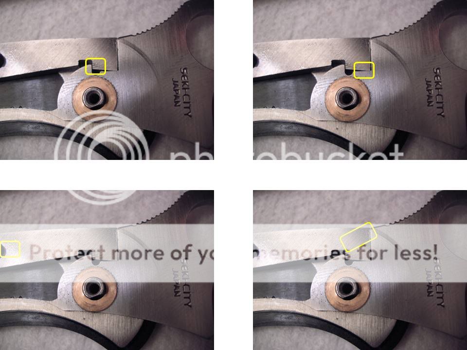

2. No matter the lock. A lock can fail severely. Not one of the two is exempted. The failures of linerlocks have been documented extensively, the failures in lockbacks not, but both can fail severely due to misuse, wear and tear, material defect and lack of care by the owner.
The following are areas that I have heard of that can break on a lock back knife but they are unlikely if the knife is properly made:
Pic1
The point of the lock can be worn or break off. The point of the notch on the right hand side can shear off.
Pic2
Right side of the notch can be clogged with lint, causing the lock not to lock up proparly
Pic3.
The pin and the spring can break if not tighten properly or is secure. Springs have broken, influencing lockup safety. The spacer wherein the spring goes can break if materials cannot take the force of the spring or the knife is assembled improperly.
Pic4
The lock can shear from corner to corner.
Now these are all things I have heard happen and some have been posted, others stated. 1,2 and 3 have happened and references can be found with some googling. Number 4 I cant find a reference for. All and all any lock used in a proper manner will not have a catastrophic failure (ie the lock explodes and just becomes useless) if the knife is used properly, well designed and executed. Deciding between the lock you want is a personal choice.

Fantastic post, marthinus. Thanks for taking the time and effort to put up the pics with the annotations. It makes it a lot easier to understand how the locks work, and how they fail.
