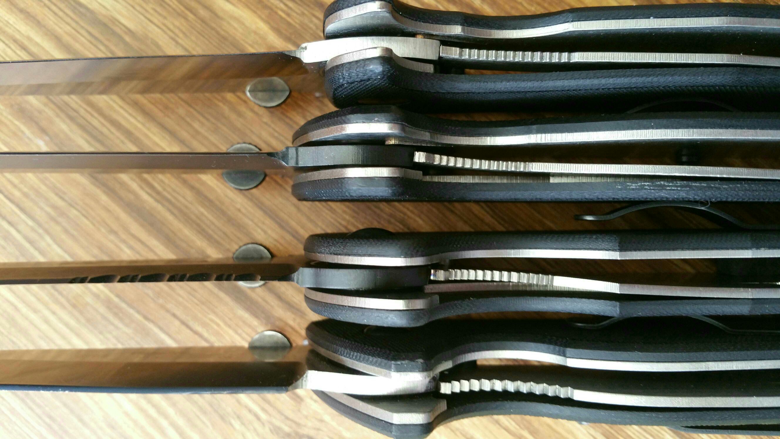

Interesting... I've never seen this on the 20+ Emersons I've owned over the years, both new and used. The lock has always been one of the most consisently dependable parts of these knives... early and solid. After the first few days of use the locks have stayed in that place for the rest of the time I've had that knife. I've never had an Emerson that locked up more than 50% even after a couple of years of use.

I bought that CQC-7A [waveless, year of production 2013] from first owner over a year ago. I opened it hundreds of times since then. Pic was taken when I bought it. It's still the same.

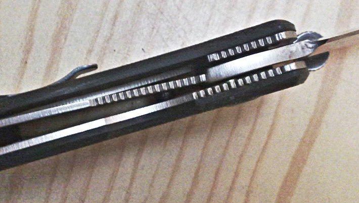

Got mine back, less than 2 weeks! Looks like they installed a larger stop pin so lock up is about 50-75% now, much better. Going to harden it and see how it goes...
Nice turn around time. Any pictures?
Sure here ya go! I bent the liners slightly which seemed to smoothen things up and help those air gaps I was having through the washers go away... then I lowered the lock bar tension, it was crazy high. This seemed to help with % lock up and the massive lock stick I was getting. Now it locks up at 50% and only very slight lock stick, but zero play either.
I did the same thing once. But then my hard grip would unlock it. Is that an issue at all?
Hasn't been yet but then again, I haven't used it hard yet. I did grip it tight and noticed that it does loosen the lock up a tad but not enough to concern me. If I find it an issue I will probably grind the lock bar in a little to subset it more so it would prevent this from happening, we will see!
I'm also planning on knocking the secondary detent out of the way, drilling a detent hole for the primary detent ball and adjusting it for much higher retention and snappiness when opening... been wanting to play w/ optimizing an emerson for a while and now I can :D
Nice lock up now. For me thats perfect lockup. The lockbar is just fully engaging and nothing more.
