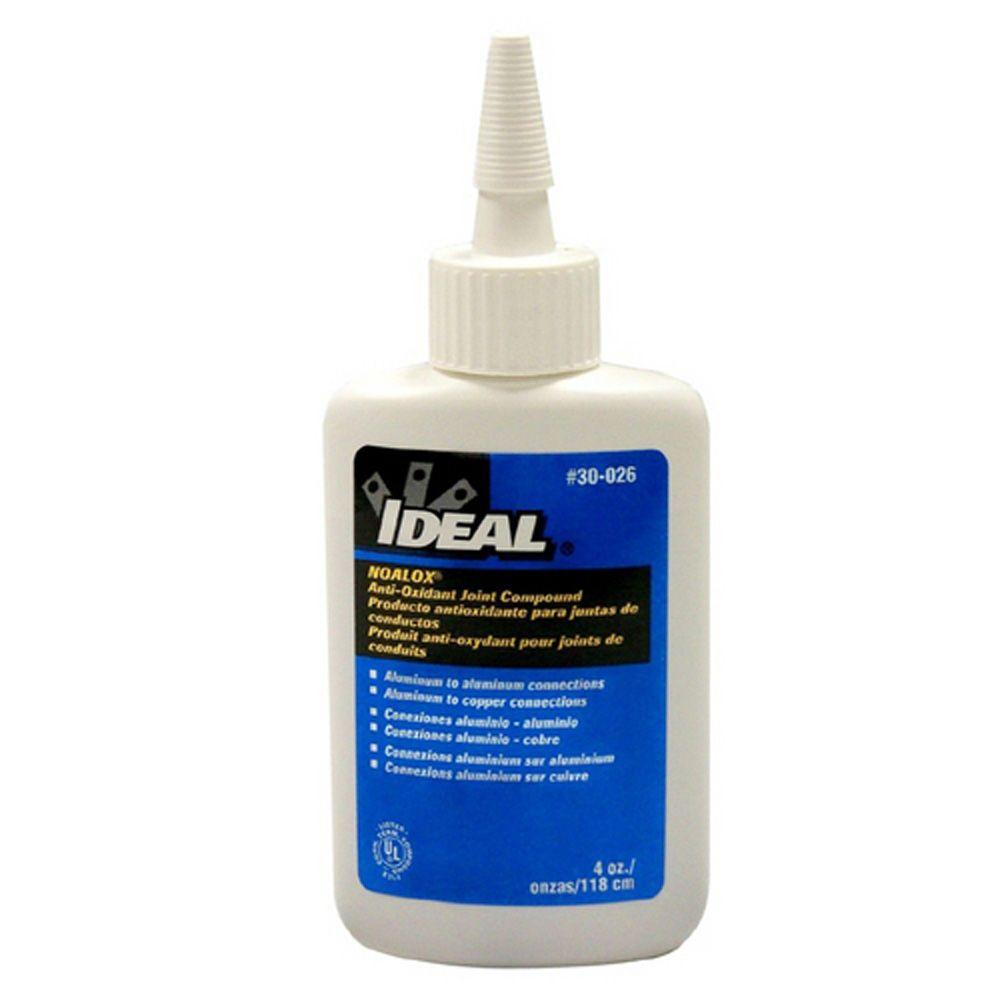

I use electrical anti-oxidant compound. Got this tip from a Nick Shabazz video. Have used it on several knives and it works well. Clean the blade and lock bar and apply a small amount on part of the blade where the lock engages. Have not had to reapply after several months. Any brand would likely work. I use this stuff because Home Depot had it and I was there.
