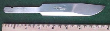

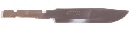

Kansbol/Mora 2000/ Bushcraft Forest tang ...
Old style tang - nice.
New style adapted for automated manufacturing ...
If they break when batoning, it will be where the deep cutouts are.
