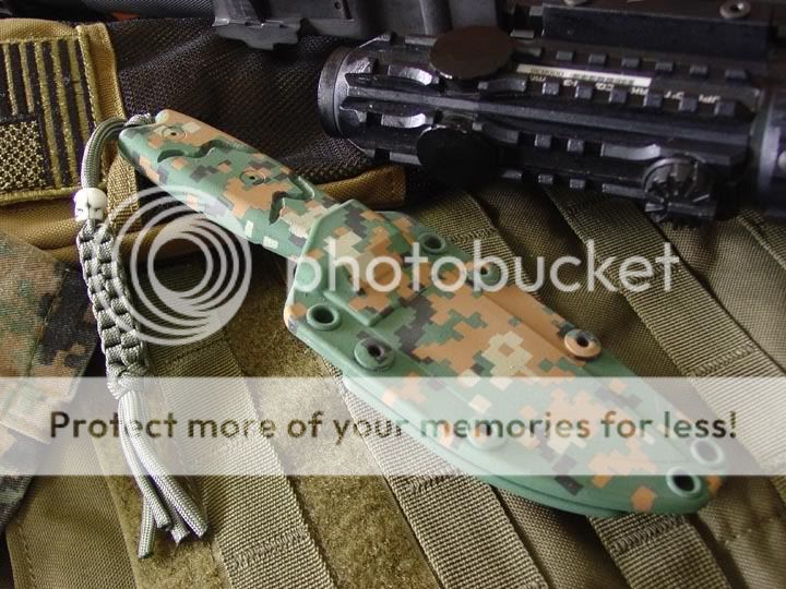

OK...this morning I decided to try the spray paint on a Machete sheath I made recently for my Martindale.
I cut stencils out of paper and taped them to the sheath... first green...then brown... It worked just fine. I did get a bit of a sloppy look on some of it because my paper wasn't tight enough against the kydex and I got some overspray.
The paint looks a bit shiny in the pic... Still a bit wet. Hopefully it will dull out... it is supposed to be matte...
BTW... the paint sticks very well. :thumbup:
OH... the sheath is right next to the Machete in the pic (um... in case you can't see it ;))

Man... that duracoat looks great! but ughhh... the price is pretty high. Still, nice work! I may have to deck out one of my AR's...

Sniper, NICE WORK!!

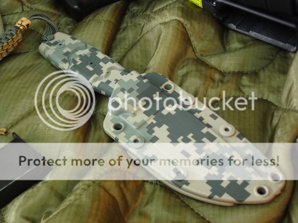

Scratch resistance ? On the sheath, once cured (two week) duracoat is very resistent to scratching.
DAYUUUM!!!! 308SNIPER that Digi camo looks KICK ASS!!!! + 1 on the Dura coat's resistence to scratches. :thumbup::thumbup::thumbup:
308... How long did it take you to get that done? I assume you have to tape it up for all the different layers..... paper template maybe?
