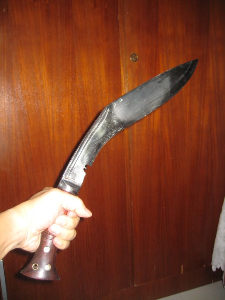

My god, thats it. Thats the one right there. Amazing, this is exactly what I had in mind when I think about a khukris. What is the name of this model and how do I go about getting one.:D

Having used a KLO (Khukuri Like Object) in thin stainless for many years and then using the REAL thing. There is no comparison! The Cold Steel is going to handle like a heavy(for a machete) weight forward machete. A real Khukuri (HI or otherwise) at 3 times the thickness and weight really doesn't handle like anything else but a Khukuri. IMHO if you are going to get a cheaper Cold Steel Khukuri you might as well just get a good quality machete.
I've broken the tips on Khukuri like objects made from stainless (The cheaper Cold Steel might be 1095 carbon steel), the 5160 carbon steel the HI's are made of will bend a little if they have any deformation at all.
