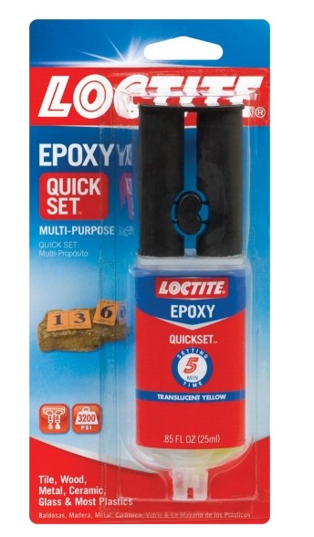

i used a Loctite version of Quickset with 3200 PSI. At that pressure i wonder if any crevices will even escape?
Like what Karda mentioned, fill it the interior to about 3/4 and you might want to roll along the axis so the epoxy gets around to fill in. Do that a few rounds until you are confident. I would also pour some on the tang and and insert it into the 3/4 filled interior and pull out. Repeat that with a wet towel ready as spill is certain.

Jay, I have no experience with these types of epoxies. By 3200psi, you mean the shear strength of the bond, right? Not the force required to inject it in the bore cavity. Also, do you have to premix both the base and hardener and then put it in the syringe? Or do some brands come premixed and thin enough that you can just use from the tube?

The 3200psi is the shear strength of the bond. Epoxy is just the modern version of the laha used by the Kamis to secure the handle onto the tang.
The trick is to mix both base and hardener into a sludge. The version that i used has a double tip that you could squeeze them straight into a flat pan:
You could either transfer this onto another disposable syringe that will make your life much easier and tidier (Spot on Karda!)
OR
squeeze both tips into the hollow part of walnut handle and spread the gunk inside with popsickle stick. Do the same to the tang and bolster as well and start assemble.
Get your wet towel ready should any mess occur. Get organized as this epoxy is ultra-sticky. Might want to wear a safety mask if you are allergic to epoxy.
If i remember it right this was how i did it:
After the alignment of bolster, tang and pommel i found a large space and pre-assembled the tang with bolster.
With the double tip of epoxy ready i applied the concoction into the bolster (squeeze both tips onto a piece of paper and mix, why? see the trick below)
Immediately i slid the wooden handle (pre-squeeze the mix into it, don't fill it up) onto the tang and applied the remaining concoction using the the paper, rolled it into a cone shape much like what a chef do to apply topping, cut the tip off and pressed the epoxy towards the rear pommel hole.
