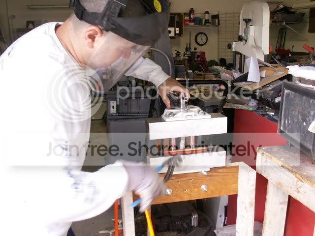

I have my plates mounted to the jaws of a woodworking vise mounted vertical. It has the quick release lever so I can drop the top plate real quick after I toss the blade in. We're talking like fraction of a second. I do not let it slam down, I control it holding the tightening bar like a t handle and hit the quick release with the thumb. I have it mounted to a sawhorse of sorts right next to the kiln. I will post pics in a few min when I can get on my other computer, people are still asleep!!
Here is what I did. I went to Harbor Frieght a bought a quick release wood working vice. And attached the two alum plates to it and used flat head screws to adj the plates to lay flat. And to provide a space between plates and cast iron vice for better cooling of the plates. I set the knives still in the HT envelope on edge on the bottom plate and then lay it flat and then with the quick release drop the top plate down and then tighten the vice down on the knife for a good solid contact on the knife. And in two minutes you can remove the knife and cut the envelope and remove the knife. And it works good.
PS: don't let it slam down like gixxer said.
BINGO!!!!! like the action pic? Notice the compressed air hose right there so I can get it quick.

I tried the vice thing, but was'nt happy with it as even when shimmed i got unever pressure, but i may try the screw thing. look's like it would be a good way to even things out!

Yes, but if the plates do not evenly contact the blade from every angle you risk warping the steel. you want those plates to contact evenly.
