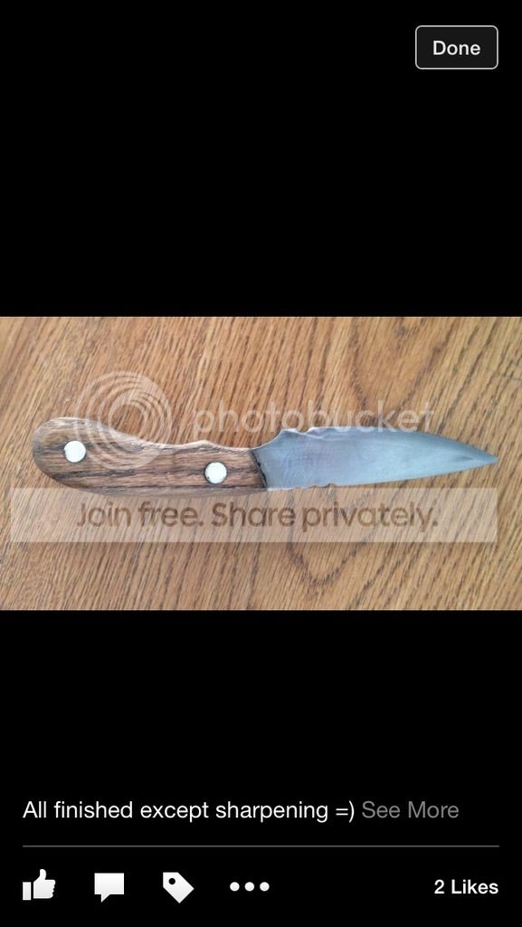

Thanks for the photo sharing tips Salem! I'm going to try to post a few pics now, we'll see if it works! Haha

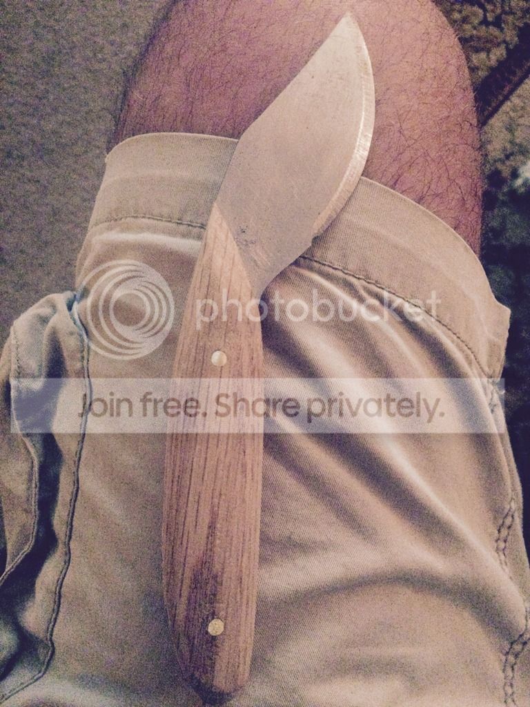

This is a picture of my first successful knife, it's not much to look at in retrospect, but I was pretty proud of it at the time 😉

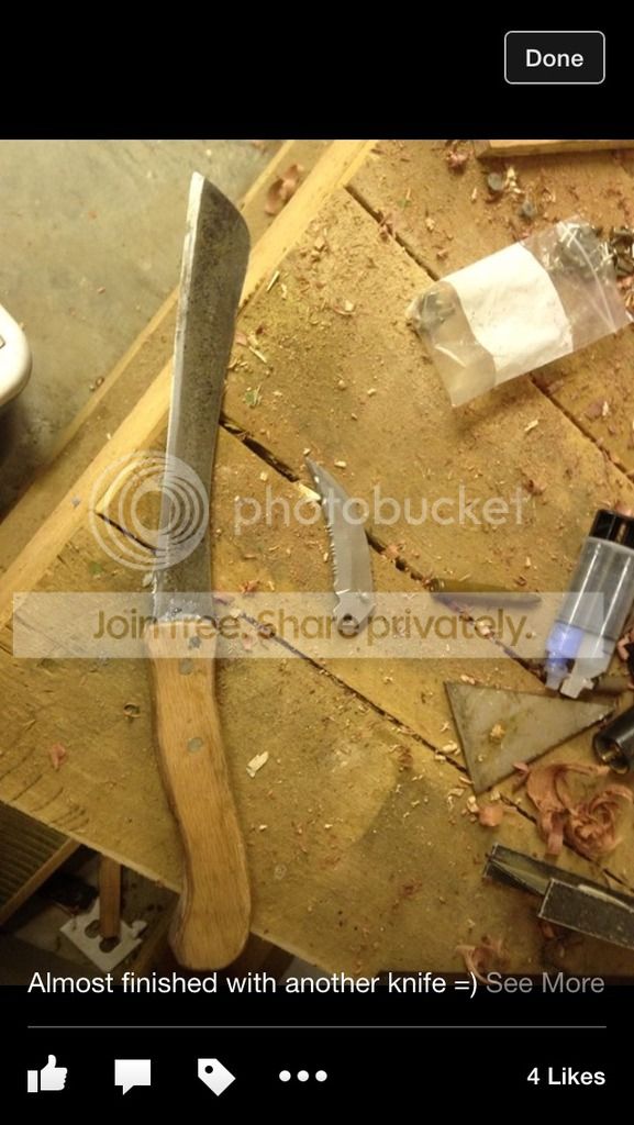

This was my second knife; I made it as a compact chopping tool, and general workhorse blade. It's not the prettiest thing in the world, but it does all I ask it to do.

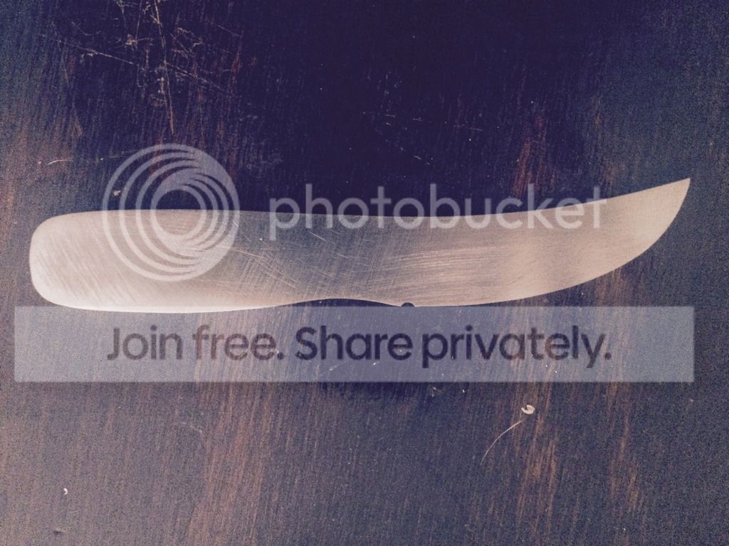

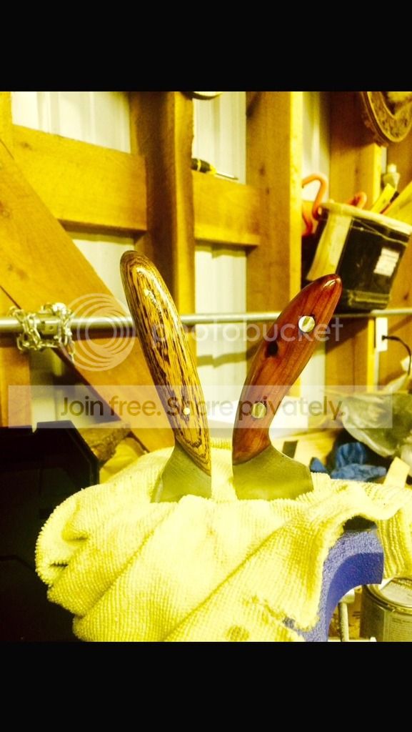

This is my third knife in the early stages of completion; you can see the finished handle in the first phot I posted, it's the red one.

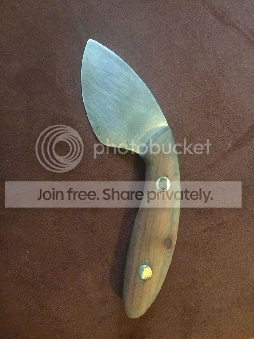

This is another early photo of the last knife I completed, and you can also it's finished handle in the first photo
As an arts student, you should look at those last two and ask yourself, "Why is the blade at an extreme angle to the handle?", and "Why is the blade so fat?". These are issues where design and function need to meet, not diverge. If the answer was, "Because it looks cool/artsy/etc." then you need to redesign them. If there is a particular task that they do better than a straighter and narrower knife, then it is OK....as long as t hat is what they will be doing. As they are now, they will try to twist in the hand during cutting, due to the force applied at the edge being so far in front of the resistance forge (grip) applied to the handle. That will cause the edge to try and rotate on the axis of the handle. What you have is the reverse mechanical advantage ( mechanical dis-advantage ?).
On your utility chopper, I don't understand all the reverse curves at all. It almost looks like you put the edge on the wrong side. It has to be very uncomfortable to use with the handle curving the wrong way.

If you do want that pistol grip angle, you can reduce the twisting effect (i feel like it eliminates it completely, but that's my experience only) by using a higher/slimmer grip profile. Wider tang, thinner scales.
Testing this out I did some pretty silly cutting, and it wasn't twisting. The closer to round you get in your grip profile, the more grip instability (and lack of instinctive edge index) will ensue.
The design of the chopper is based on the Asian-Pacific parang machetes, and in many of the examples I've seen they incorporate similar reverse curves in the design. Personally, I've found that the handle is very comfortable for chopping, and the curve of the handle also allows you to swing through a target ahead of the blade, which gives the cutting edge more time to gain momentum.
As for the other two knives, the blades are fairly thin and flexible (similar to a fillet knife), and from what I've experienced when cutting with the more curvy of the two knives, the flexibility of the blade seems to mitigate most or all of the handle twist. The comparative fatness of the blades was meant to make them more resistant to taking a permanent bend if they were ever put in a bind during use, and both of these knives are designed with skinning in mind, hence the curves. Also, I've received many compliments on the aesthetics of both knives; a guy from my local church even wants one made just like the more curved of the two.
Just so you know, I do appreciate your input, Stacy. It may not be what I want to hear, but I understand that you're just trying to make me a better blademaker; so thank you for your critiques. :)

When I saw the 'machete' I saw a Parang-ISH blade. The handle looks a bit weird. But if it was made for cutting brush the angle is useful. It's ergonomically better for slicing through brush. The Khukuri, which curves the other way is an all purpose knife. Authentically made khukuris aren't great as machetes but they are excellent at concentrating the force for chopping.

The skinners are obviously skinners. My criticism is the handles being too long. Personally, using a skinner like that I'd have the blade held betwen index and middle finger and the thumb. Some people prefer the T handle skinners, Mine is a T handle but shaped like a mezzaluna. I can't speak for efficiency of effort, but handling it like a stoneage scraper allows amazing control.
