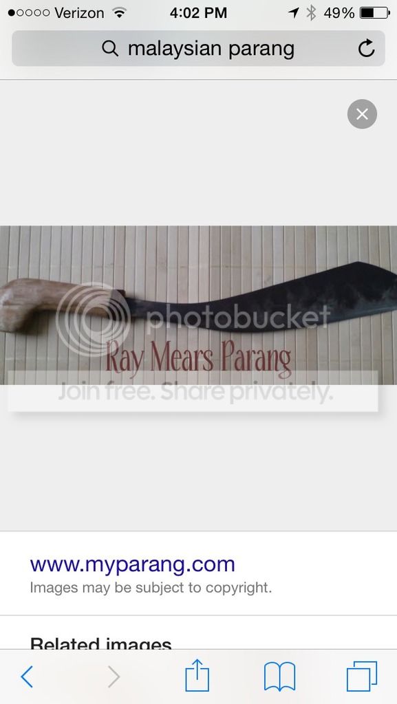

As is the case with many indigenous designs, there appear to be several variations on the parang. This is the type I based mine on:
The only reason the edge is straight on mine is because I was using a piece of excess steel I had on hand. I took a design that was a proven chopping tool, and adapted it to fit the design constraints of the metal I was using; I've heard some knife makers call blades of this sort "shop goblins."
How do you feel about the quality in making knives? Do you feel that there isn't a need to have good finishing work as well ass quality in the materials, or that "style" is enough? I see the knives you are showing to be poorly conceived, and rushed over in both the blade and handle finishing. Please don't say these things don't matter. Your work at this point appears very crude. Certainly, these may be a few testing blades and if so please show a well finished one. I don't see the quality of work you seem to believe is there.

That's a slightly loaded question, but I'll answer it to the best of my abilities. However, please understand that I am not trying to invalidate any of the design philosophies of anyone who has taken the time to reply to this thread, and I respect all of you as the master craftsmen you are, and I hope I have not offended any of you with my opinions because that was not my intention at all. That being said... Knife making is something I do purely as a hobby; I enjoy the process of coming up with my own designs, or modifying previously established designs to suit my particular design aesthetics. Do I think my designs are the best in the world? Absolutely not. Could I spend more time on executing each of my designs so that every single tiny detail is absolutely flawless? Certainly, but I could also run the risk of ruining a perfectly adequate tool and losing all the work I've put into said tool. Knife making is not my livelihood, so I'm not trying to scam people out of money with hastily done trinkets that literally have no capacity for usefulness whatsoever. I am simply making knives that serve the purposes I have designed them to fulfill. I am an artist at heart, and I find beauty in what I've made, *and* as an added bonus, I can use the tools I've made.

If you are happy with your knives, and you are the only one being pleased, don't change anything.
If you are asking for advice, critique, and improvement from makers who do it every day...you will need to make changes. Ergonomics/design, and fit and finish are what shows the most need for improvement.
Learning by mistakes is a very poor method in education. Learning from example, mentoring, instruction, by proper example, etc. is how to do it right. Medical students don't just start doing surgery and learn a bit every time the patient dies until they get it right, do they.
As far as personal expression, only after you know what is inside the box can you really work outside it.
