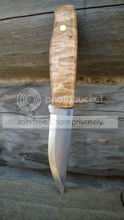

Right now this is the puukko I will take along on going on hikes that require a fixed blade. Nor strictly a traditional puukko though. Enzo Elver.
