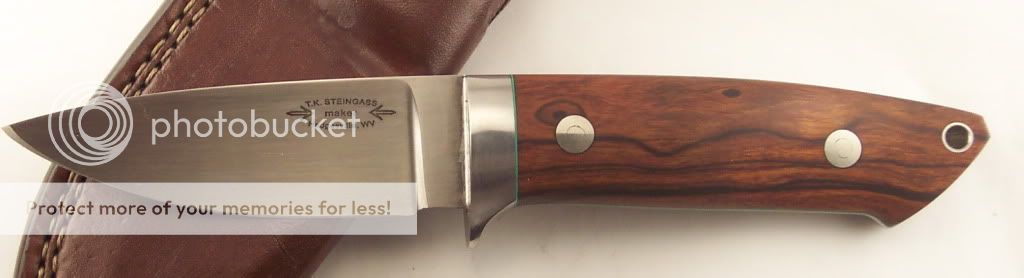

Greetings BFs:
I just got back a run of 10 Loveless dropped hunters. capers, and New York Specials from Paul Bos HT, most of which are spoken for. This knife was ordered by a customer who has since backed out, so I'm putting it up for sale on BF at the price I quoted. I normally put green liners on Desert Ironwood - red just doesn't show up as well, and I get a lot of positive feedback from my customers when I use this color with DI. $285 delivered, ConUS, insured. First I'll take it or PM gets it. Please Paypal under the personal tab or add 3.5% to the total (which is what Paypal charges me) to tksteingass@frontier.com
Lifetime (mine) common sense guarantee and free sharpening.
Best regards,
TK
CPM S-30V 3/16" stock
OAL 8 1/4"
Blade Length 3 3/4" hollow ground
Professional HT Rc 60-62
Desert Ironwood Scales
Hand rubbed satin finish

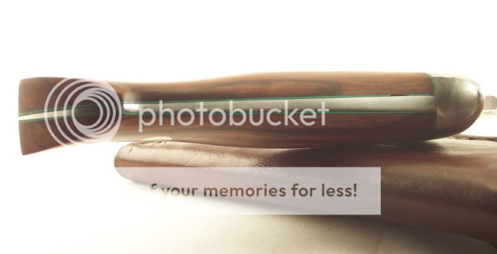

tapered tang with green liners
416 SS guard and thong liner
Nickel silver rivets

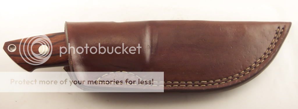

10-12 oz hand stitched sheath
