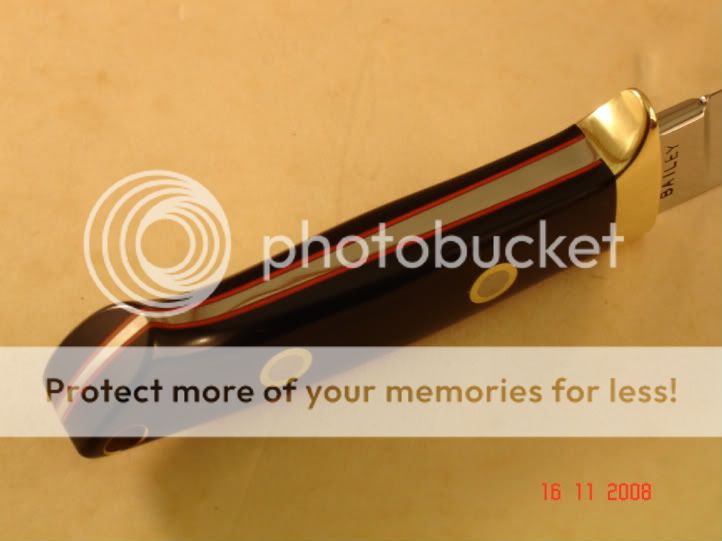

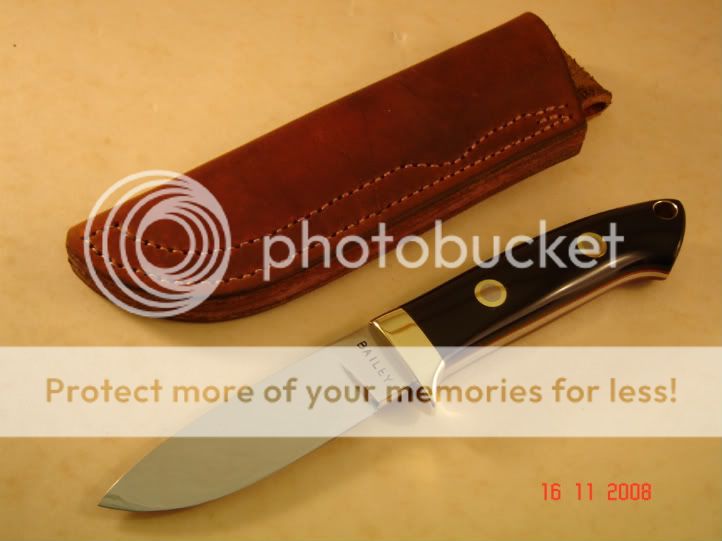

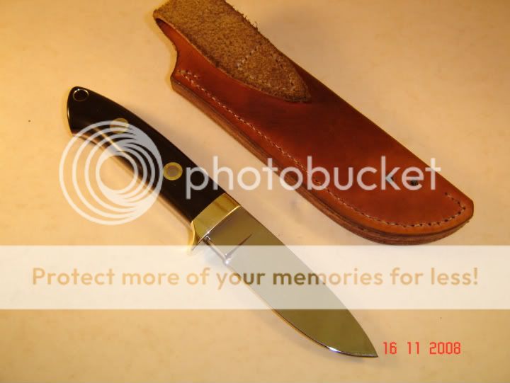

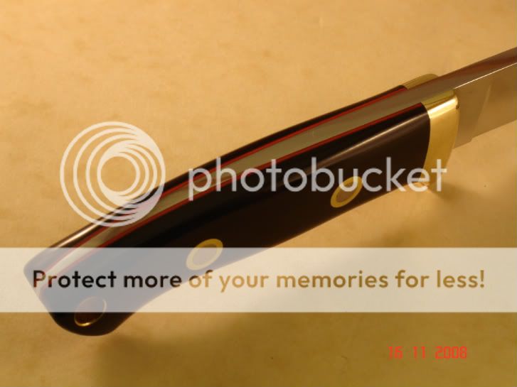

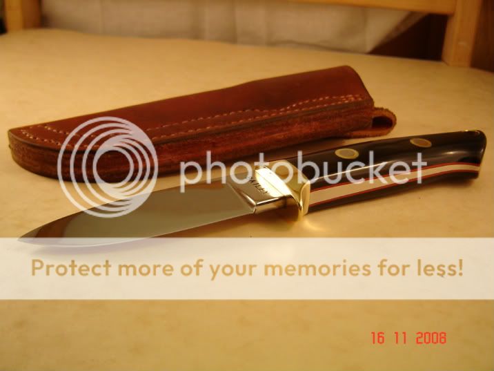

Here are a few pictures of my latest knife, which as you can see is inspired somewhat by the work of Mr Loveless!!
O/L - 8"
Blade - 3 7/8"
Steel - 3/16" circular saw blade, oil quench & double temper.
Fittings - brass
Handle - A Delrin type material "liberated" from work!
Any comments good or bad very much appreciated.
Thanks for looking
Regards, Ian
Nice rendition. If the tang was tapered a bit more it would be perfect in my mind. :)

Beautiful knife.. one question... the sheath looks great except for what appears to be 2 holes in the blind side?

Thank you Will, the two holes are for drainage. I don't normally bother, but my aim was to stick as close as I could to the Loveless design.

Looks good to me! Delrin is a pain to work with. You did a fine job!
Yep, Has to have the hole or holes in the back! This step is too often left out! Not only works for drainage, but you can use shop air to really clean out a sheath after a long hunt. You would be amazed at what kind of junk can get stuck in your sheath. And It never wants to come out!!!

Bob Loveless would be proud if he saw it. It looks great. Bob wrote a book on how he makes knives. I see you put your own name on it, if you put his logo it would indeed be a rip-off. I am in the process of making a chute knife.
